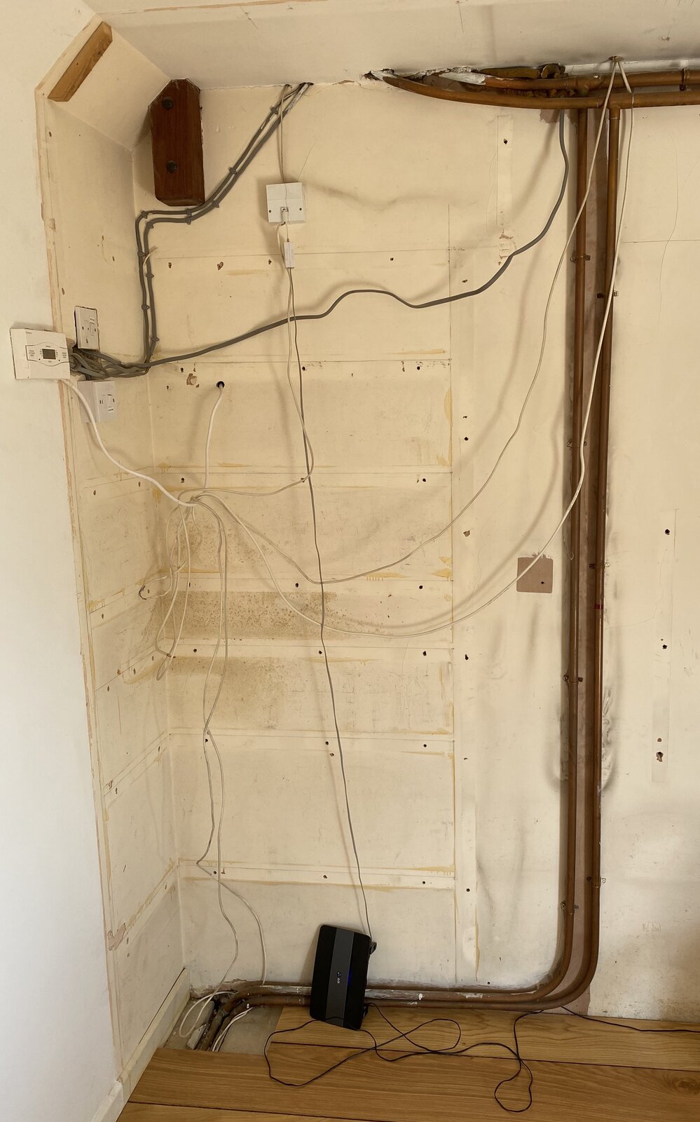

See pic - ignore wires :)
Looking to build a false wall along where the C/H pipes are to cover them up and create a nice flat wall to probably place a fridge and some tall units or shelving.
My question is, if I were to batten this block wall to attach plasterboard can I get away with just uprights and cross members and nothing touching the floor?
Ideally, this would have been done before the floor was laid and I could have run the base timber along the concrete subfloor, but hey nothing is ever simple.

Could I get away with a low cross member but one that doesn't actually touch the floor?
I think that because the eng. wooden floor is floated, I guess I'm trying to avoid using it to support anything. Alternatively I could lift the floorboard nearest the wall and trim it down so that I can run a base along on the concrete. But was trying to avoid doing that.
Yes. But I’m just trying to understand if the false wall needs to be supported on the floor or if the wall is enough?
I guess this one of those walls woody were you will need Xray vision when drilling into it!
