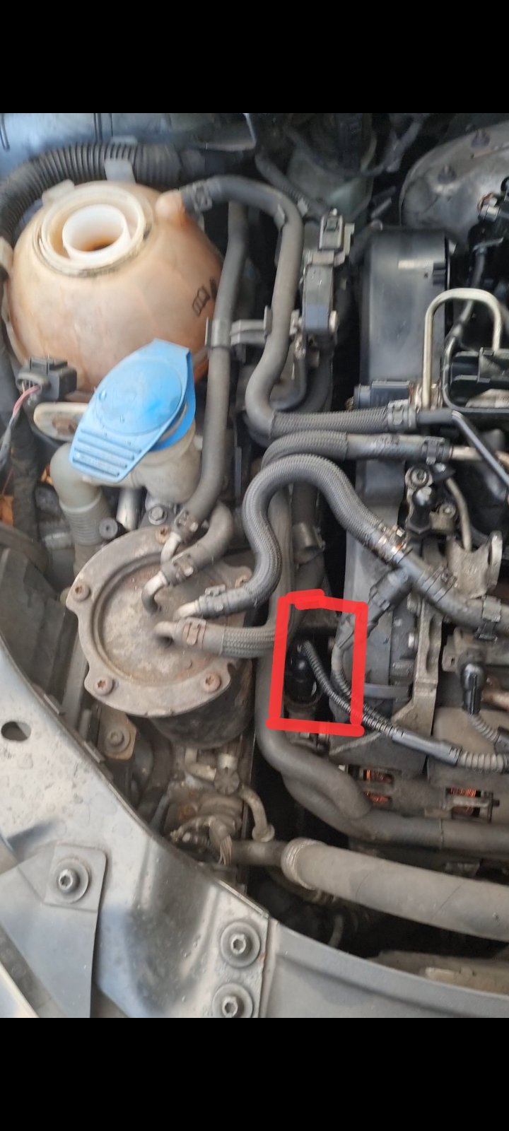

Ok guys sorry been busy..this problem comes and goes been fine since until yesterday..fan kicked in ...everything normal ect temperature. Good nothing abnormal..question obd reading which coolant sensor? I understand that there are 2 ect sensors?..is this the second one by the fuel filter on other side of engine?..

The second one, might be an oil temperature sensor.
Your engine fan, will be powered by a relay, triggered directly by a thermal switch - either switch, or relay might be faulty. The only way to know, is to look at the diagram, and trace it.

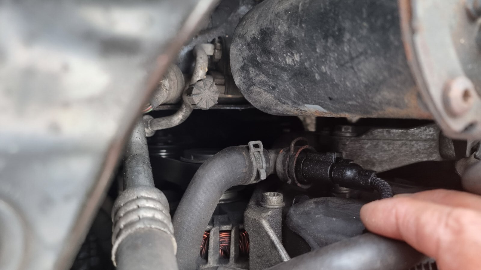

Well problem still there ..noticed it happens when really cold like temperature in the minuses..happened first thing in morning..is this a ect sensor in pic? Its just below the fuel filter..see pic.
Also where is the cooling fan relay located? Can't see it in engine bay by battery ..I see one that says 100 on it..?
Ta
