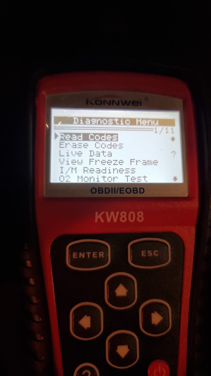

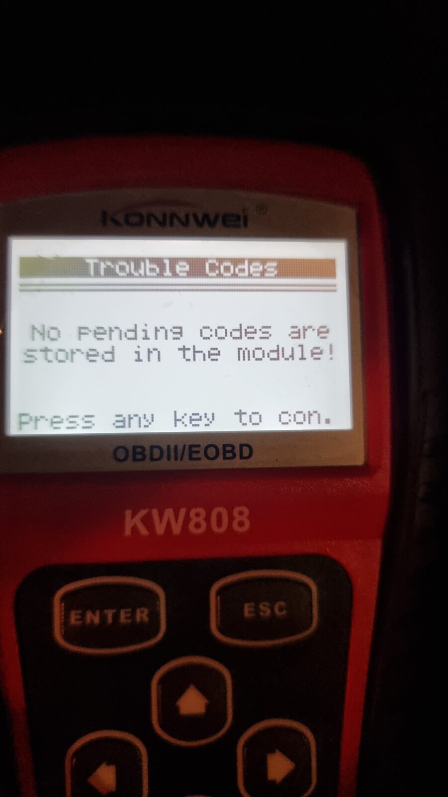

An OBD2 reader is a basic item of equipment nowadays for even the non mechanically inclined motorist. A reader can be obtained cheaply enough, under £15 in some cases. Even a cheap one should be able to read the codes and give a pointer to what is wrong. A garage will want £50-60 to “diagnose” a fault unless you have a friendly mechanic.

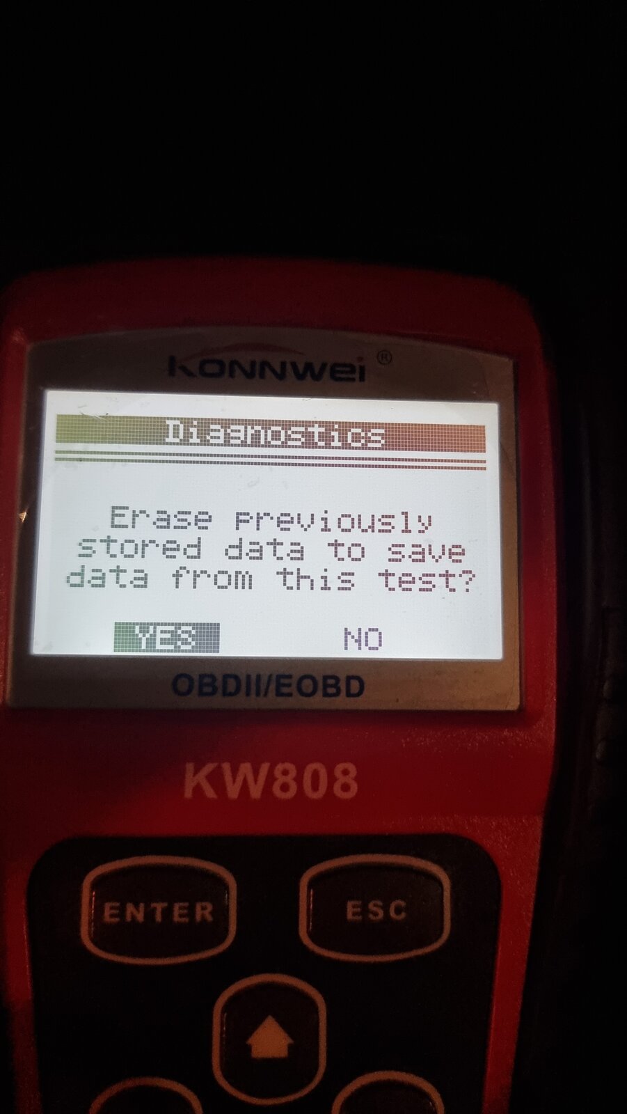

Ok im getting no codes as no light is on dashboard..strange thing its not happened last few days
