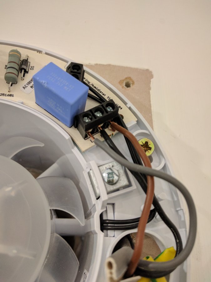

    Ok. Had an extractor fan replaced. The old fan turned on when the light went on and then kept running for a set amount of time after the light was turned off.
    However I had originally specced a humidistat and timer controlled one which was fitted today while I was out.
    However, now that the new fan is in, it only turns on once the light is on and the humidity hits a certain level, which is fair enough, however, when the light it turned off it goes off immediately, which shouldn't happen.
    I have taken a look as I think I understand how it should work - a live, neutral and a switched live cable. Indeed there are 3 cables. However, the live is only live when the light is on and what is connected to the switched live is only live when the light is off.... I can't understand how the last one worked.
    If I swap the 2 "live" cables over the fan comes on if the humidity is right and the light is off and turns off when the light is on.
    Any ideas? It took so long to get the guy to come back that if it is something simple I'd rather sort myself.
    Cheers.

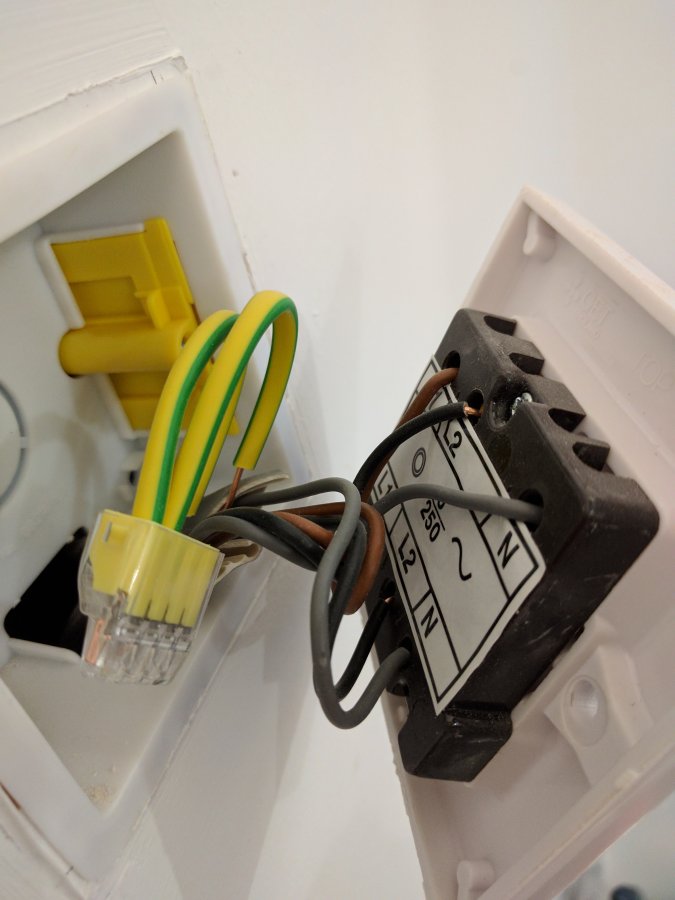

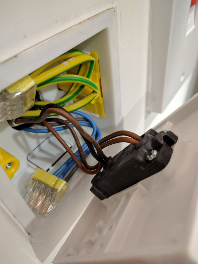

    Just had another look and I forgot the fan has an isolator switch higher up (which is always on). That has clearly been opened up today as the paint has been distributed but the light switch hadn't.
    I have attached photos which will hopefully make more sense to you than me!

    Grey is Neutral and connected to L at the fan.
    Swap Grey and Black.
    If, then, it still doesn't work properly, swap Black and Brown at the fan - leaving Grey in Neutral.

    Well providing the switch was correct the grey Neutral looks connected to the L terminal in the fan which is wrong

    Who put this fan in, you say he looked in the switch, so surely he would have seen the grey connected to N, its quite possible that the N is not being used for the neutral, do you have something to test voltage and feel competent to do so, rather than moving wires willy nilly.

    Just had another quick look and youre right, the grey neutral which followed through both switches was not in the neutral of the fan.
    Swapped it and one of the lives and it still turned off with the light. Swapped the lives round and it is now working as it should be.
    Thank you everyone.
