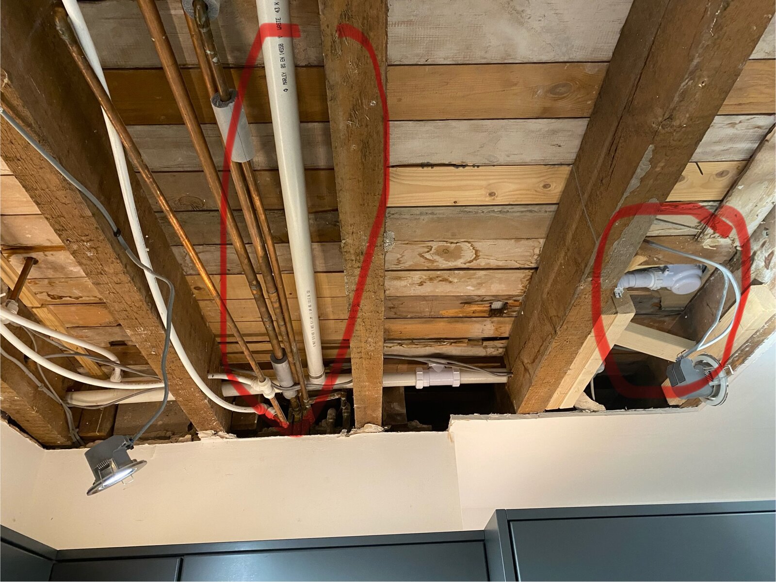

I'll drop a video of flow of water in bathroom with issues and flow in bathroom that runs to same waste stack.

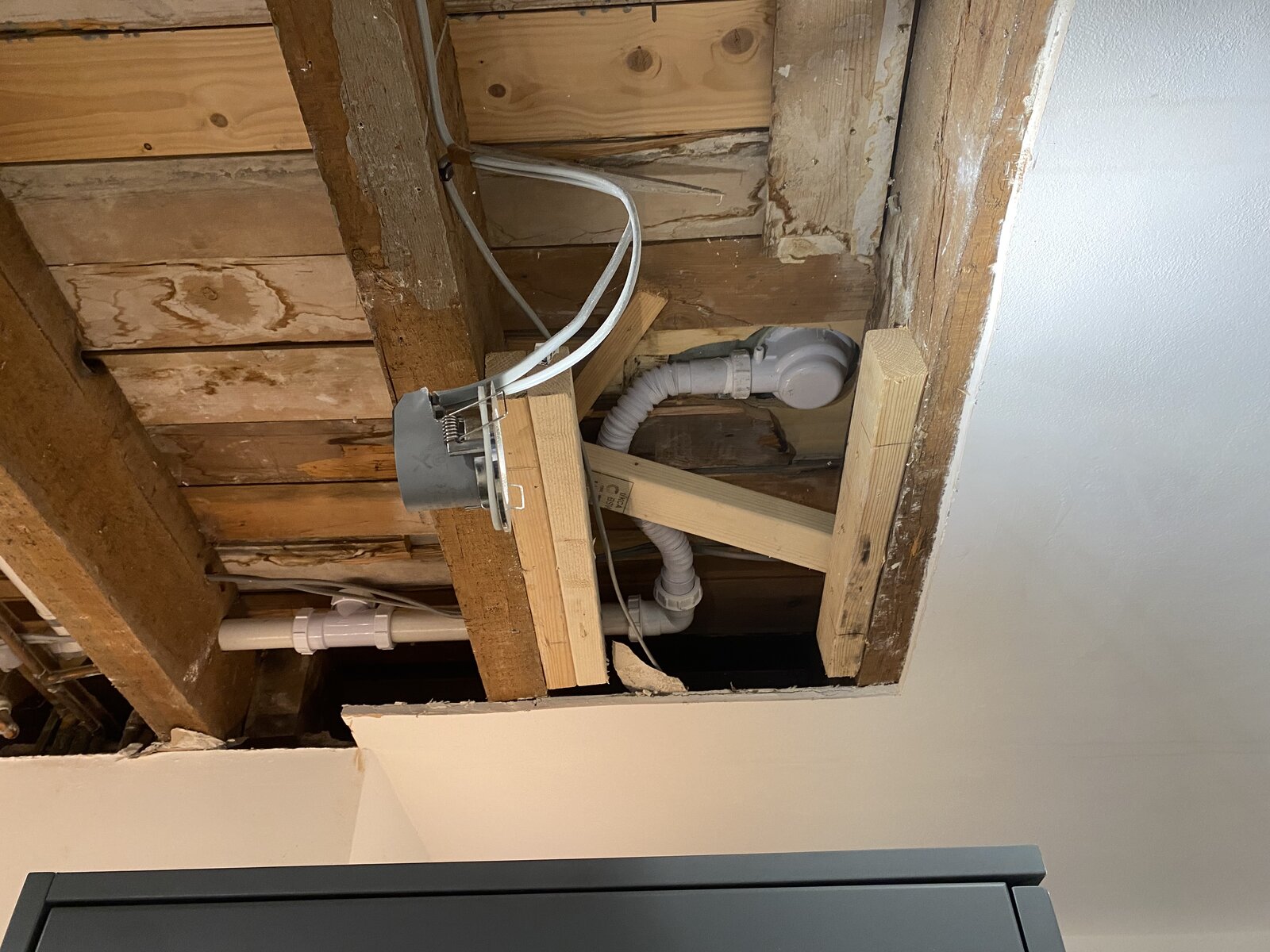

And a photo of pipework from when had the ceiling down...
So - photos of pipe work. And then videos of bathroom with good flow and one with bad flow.
A lot of gurgling noises in pipes whether trying to drain bath, shower or sink, and bath backs up into and comes out of shower drain when try to empty it.

Can you indicate direction of flow(s) please, and that Flexi waste I suspect isn't likely to be helping much, pair of swept 92.5º (or 92.5 and 45) bends would be better, with rigid 40mm pipe in between. Is that an Non Return Valve on the shower?
I'm leaning, (at the moment), towards some sort of anomaly with air movements, possible one side is having the water sucked out, (hence draining super quick) and the other is holding pressure, so the water cannot get away, and instead is backing up.

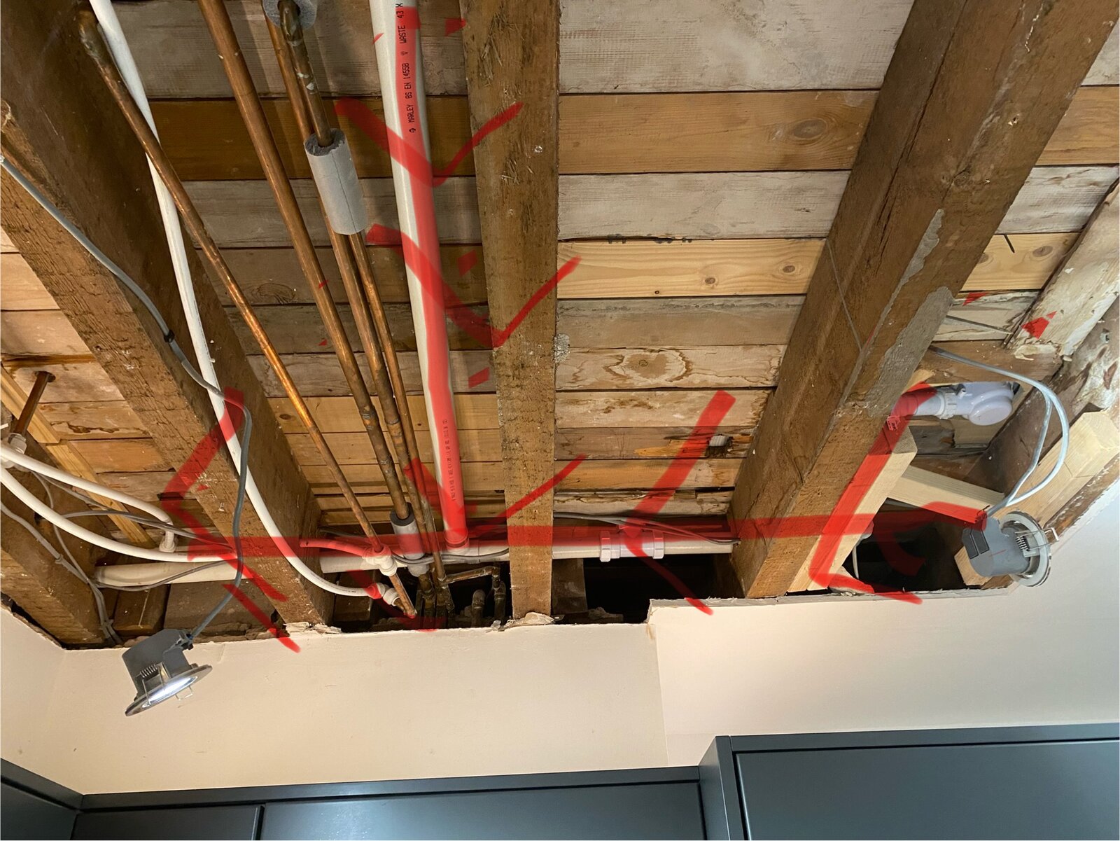

Thanks Hugh- attached with flow directions.
The plumber added the non return valve as the bath water was draining and then popping up under shower. That said, even with this is in place that still happens!!
Apologies Hugh- now with photo actually attached!
Afraid it's going to be a lot of questions, always more difficult to diagnose when you're not on site.
Obviously shower is on the right hand side, take it the bath connects in on the Tee, downstream of NRV. Where does it go after this, how far, many bends etc? Where does en suite join the rest of the system?
