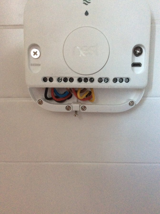

The odd part about it is that the cylinder thermostat seems to do what it should when operated manually.

Can you check that your wiring corresponds with this link. Click on the 'Y Plan diagrams' and you will be able to see what should be live and when.
You say that the pump is running when it shouldn't be. But, is the boiler operating too? If the boiler is running, what is being heated? Radiators / hot water / both
Was the system working correctly before the Nest was installed?
Have you changed the position of any wires at the cylinder thermostat?

The radiators are not heating up as for the water I'm not sure I can't hear the boiler from the bedroom and have been turning off the pump from the stat before checking to see if the boiler is firing but in my sleepy state I don't remember thinking the tank was hot but that's no guarantee.
Before and a few days after the install it all worked fine.
No changing of the cylinder thermostat wires. The only wires I've touched are the heat link wires.
The next time it happens I'll find out what (if any) is being heated.

So I've had a multi meter across the terminals on the heat link and this is the result:
HW CH off 2,4,5 240v
3,6 no power
HW on 6-240v 3 no power
CH on 3,6 240v
So I'm guessing the Nest is working as it should, now to trace the wires.

Last night the pump was running again but the radiators and water tank were cold, I turned down the tank stat and the pump stopped but after I turned it back up the pump started again and the boiler fired for a few seconds and then stopped.
So basically the pump is running without calling for heat?
Well, I'm running out of ideas on this one. It's certainly very odd. I still think it's an external control fault, because of the fact that the cylinder thermostat which (if wired correctly) shouldn't have a live supply from anywhere, is switching the pump / boiler when you adjust it.
The absurdity of this could be illustrated like this. If you turned off the main electrical supply to your house at the consumer unit, then when into the kitchen and switched on the kitchen light would it come on? No, it wouldn't happen (unless it was wired incorrectly). What you have is the same situation. The electrical supply from the Heatlink to the cylinder thermostat (terminal 6) is off, yet, you turn on the thermostat and the pump runs. Shouldn't happen.
So, to me I still believe the wiring is wrong somewhere. The crux of the matter is, where is the cylinder thermostat getting a live supply from when it shouldn't be. So I would start with checking the cylinder thermostat is wired as it should be, according to the link to the diagrams I sent earlier. Not just that the correct three switching wires are going there, but that they are corrected to the right terminals.
