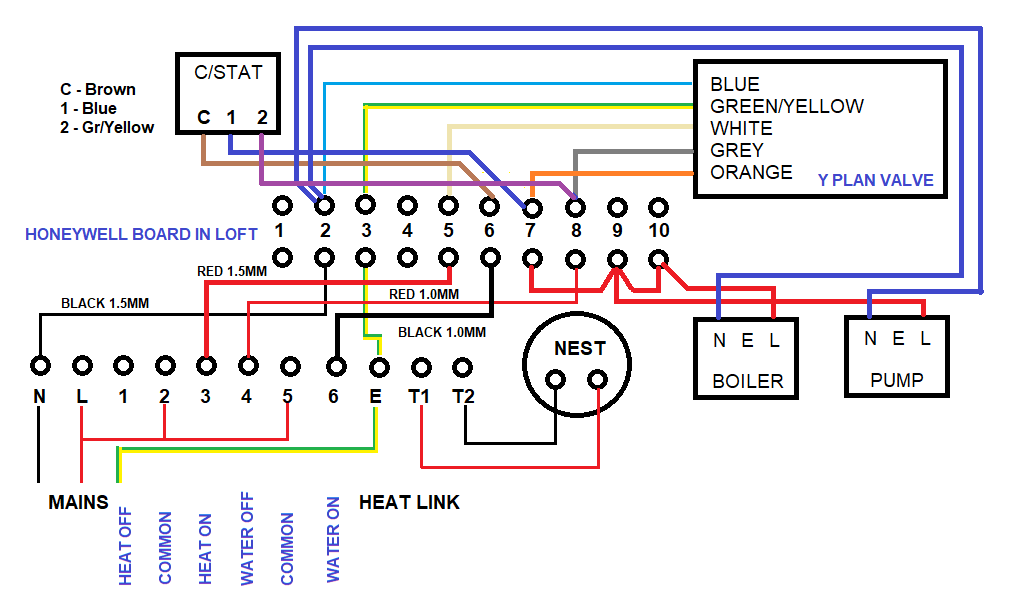

I hope everyone is well, and thank you for your help.
I installed a Gen 3 Nest Thermostat and Heat Link to our System Boiler yesterday.
The heating is working perfectly well.
While the Hot Water controls and schedule are showing on the display and on the App there is no hot water being produced.
I think the Cylinder Stat wires are wrongly connected.
On the original programmer Hot Water OFF was to Grey on Y Plan and Cyl Stat 2
On the original programmer Hot Water ON was to Cyl Stat Common
On the Nest Hot Water OFF goes to Grey and Cyl Stat 1
On the Nest Hot Water ON goes to Cyl Stat Common
On the Nest Live Orange goes to Cyl Stat 2
It is a Honeywell L641A Cyl Stat
Can you tell me if the Cyl Stat wires are wrongly connected
Thank you
Ray
On the original programmer Cyl Stat 1 was connected to the Live Orange from the Y Plan valve
Have you checked the valve is still working? Cylinder thermostat connections look ok to me.

Presumably I need to change the Cylinder Stat 1 & 2 over leaving the Common as it is ?
Is the problem caused by the layout of my particular Cylinder Stat ... I seemed to follow the instructions on YouTube and the paperwork that came with the Nest?
Thank you again for your help,
Ray
Yes common stays as it is, 1 is call for heat and 2 is satisfied so just swop 1 and 2 around.

Thank you for the input on the earth cable Eric,
I just need to get some 4 core - there's only a metre of cable between the Honeywell connection box and the cylinder stat so it won't take much changing.
Here's the correct wiring diagram for my system boiler ...
