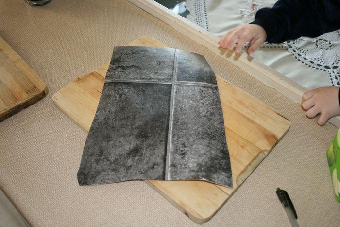

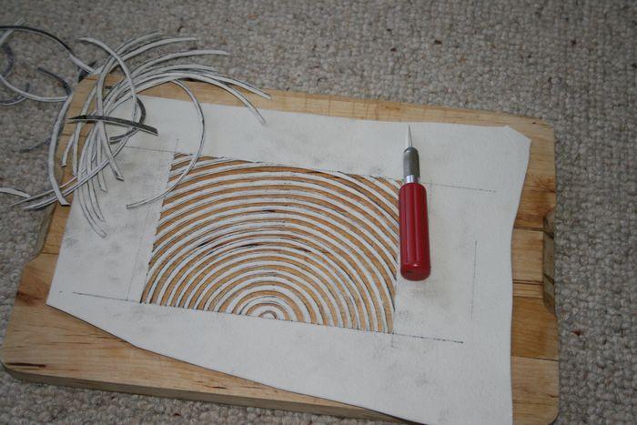

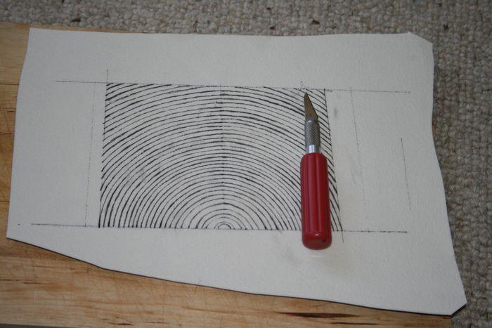

have used vinyl floor sheet (3mm thick) to create a mould- first draw lines with a pen, next cut out shapes with razor blade

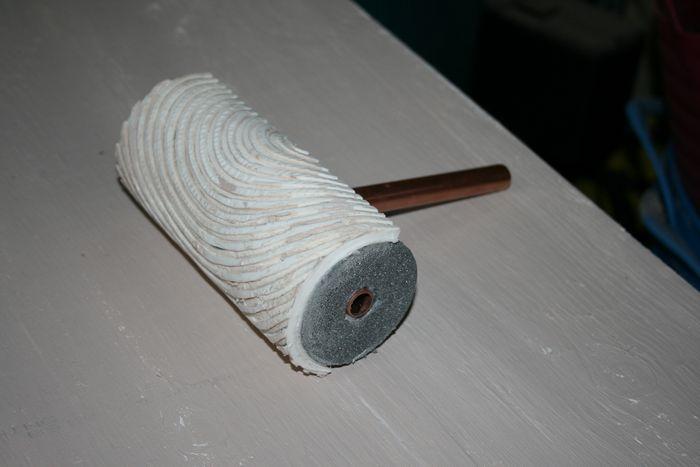

out of copper pipes created a handle, out of pipe lagging roller, silicone have been trimmed to required size
my ready tool looks like this
