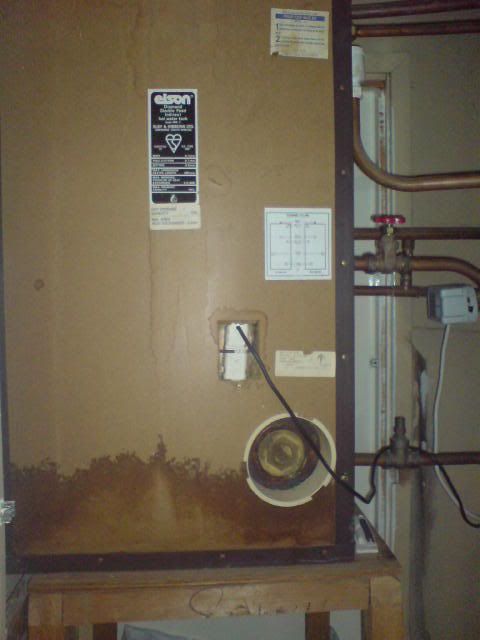

- hot water is supplied from a double feed indirect hot water tank in a room 2m away from the bathroom but on the same floor (tank sits about a metre above the ground). there is no additional cold water tank to supply the hot water tank.

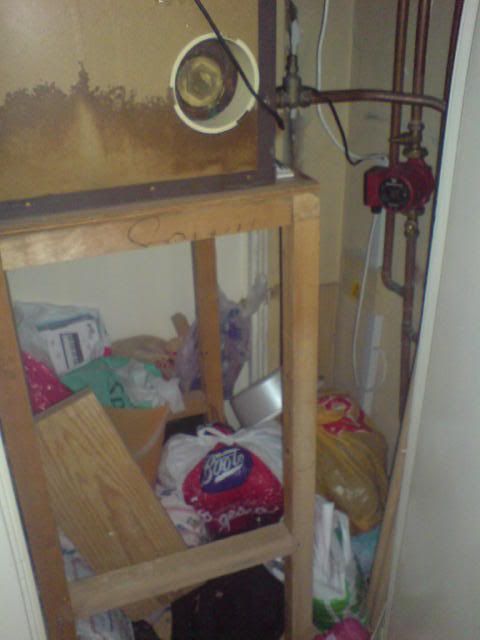

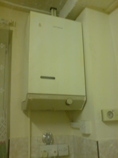

- I have a boiler in the kitchen downstairs which i presume controls the heating but there seems to be a heating pump connected to the hot water tank too, so im not too sure.
I've read and understood that mains pressure cannot work on pumps so my question is, how do i go about connecting hot and cold from this hot water tank. i can run fresh pipework into the bathroom and locate the shower at a distance of 3m from the tank with pump sitting directly below the water tank. alternatively i can locate the pump underneath the bath tub, at a distance of 2m from the tank.

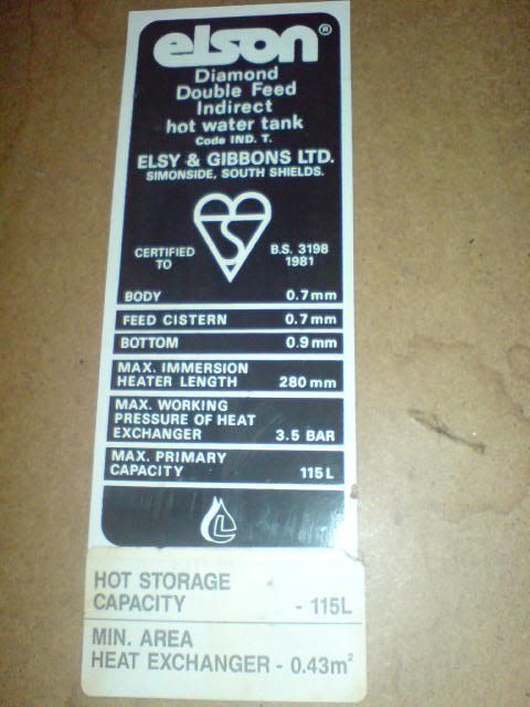

You either need to locate a gravity supply for the cold from your elson or perhaps fit a single feed booster pump just for the hot. This is not perfect but may work.
The Elson tank incorporates a very small cold water tank. Its possible even a small shower pump would drain this tank during showering. Also the height of the tank may not be sufficient for the pump flow switches to operate.
Another solution might be a venturi shower eg Trevi Boost. Check specs. carefully though.

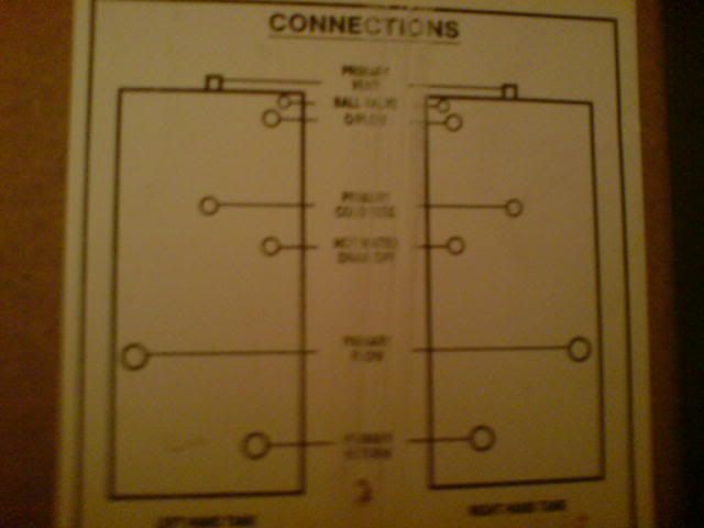

question is, how do i gain access to the gravity cold supply from this tank??

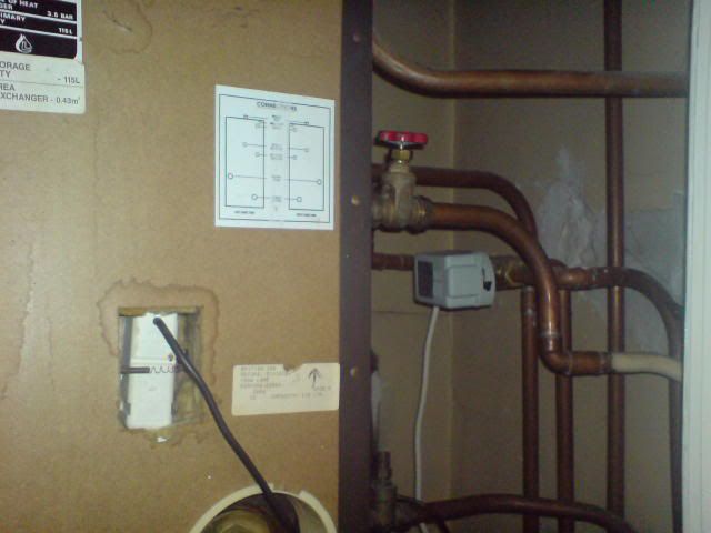

Talk to Elson they may have suggestions.
Look at the diagram on the side on the unit it shows the hot and cold outlets.
