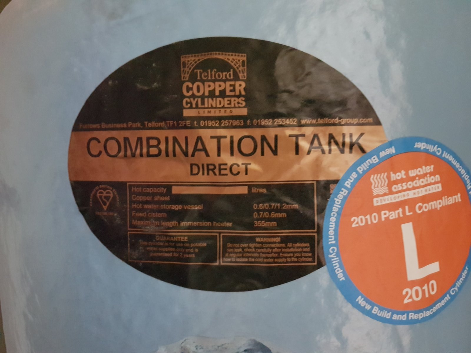

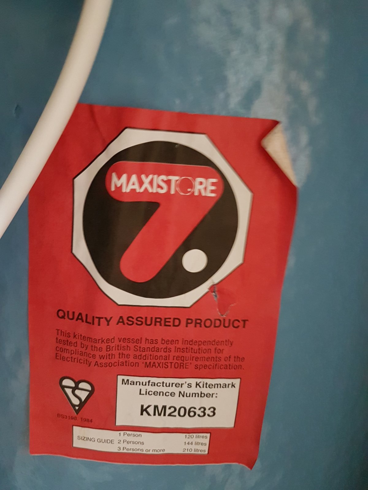

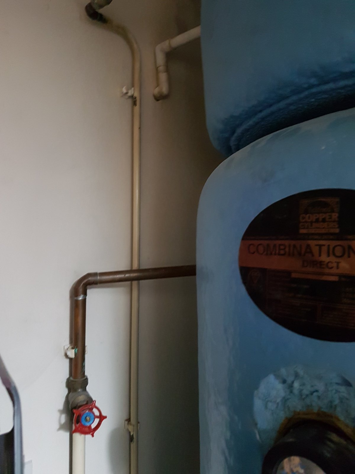

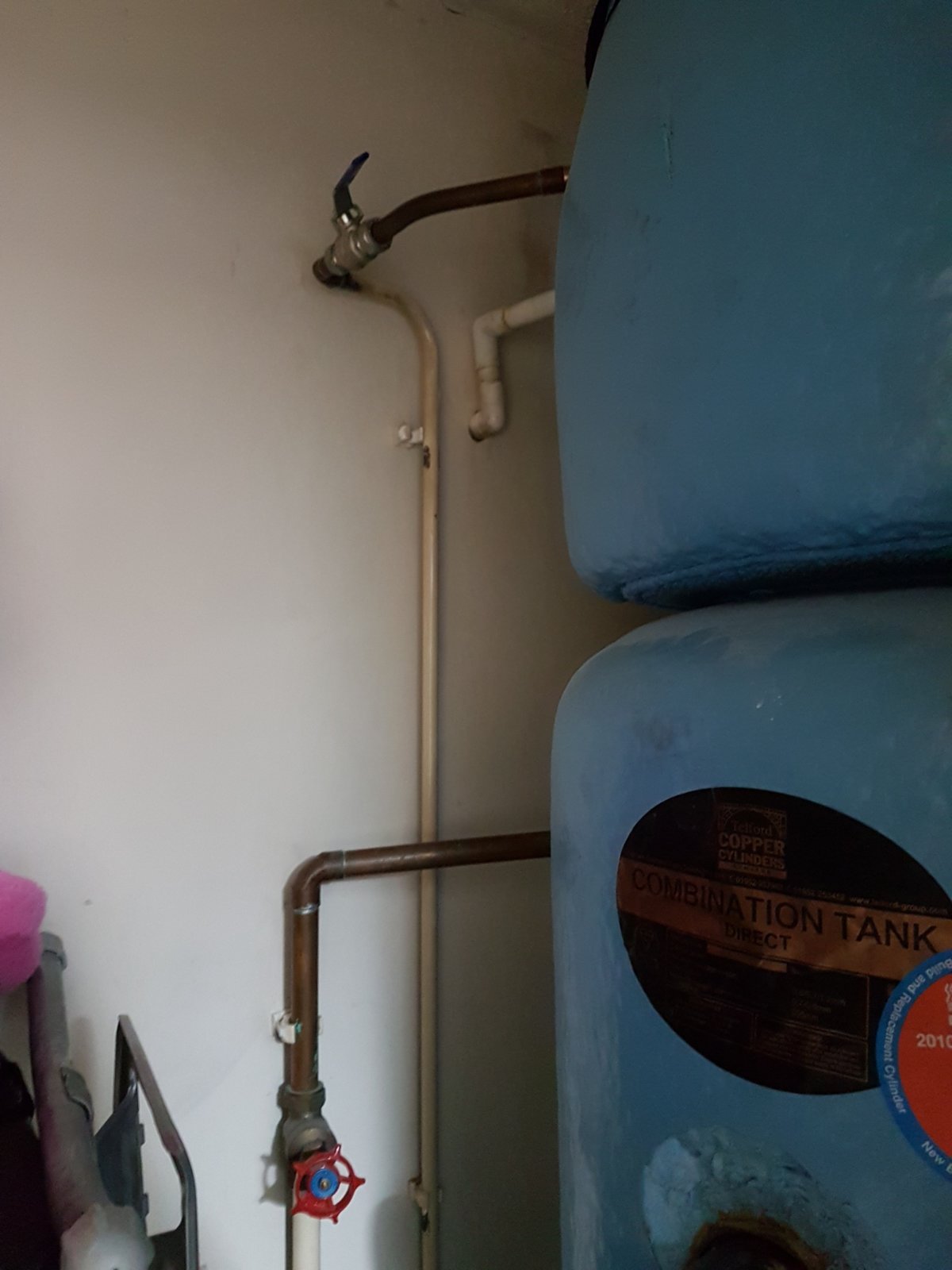

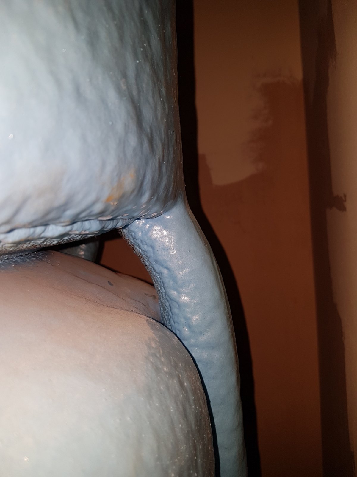

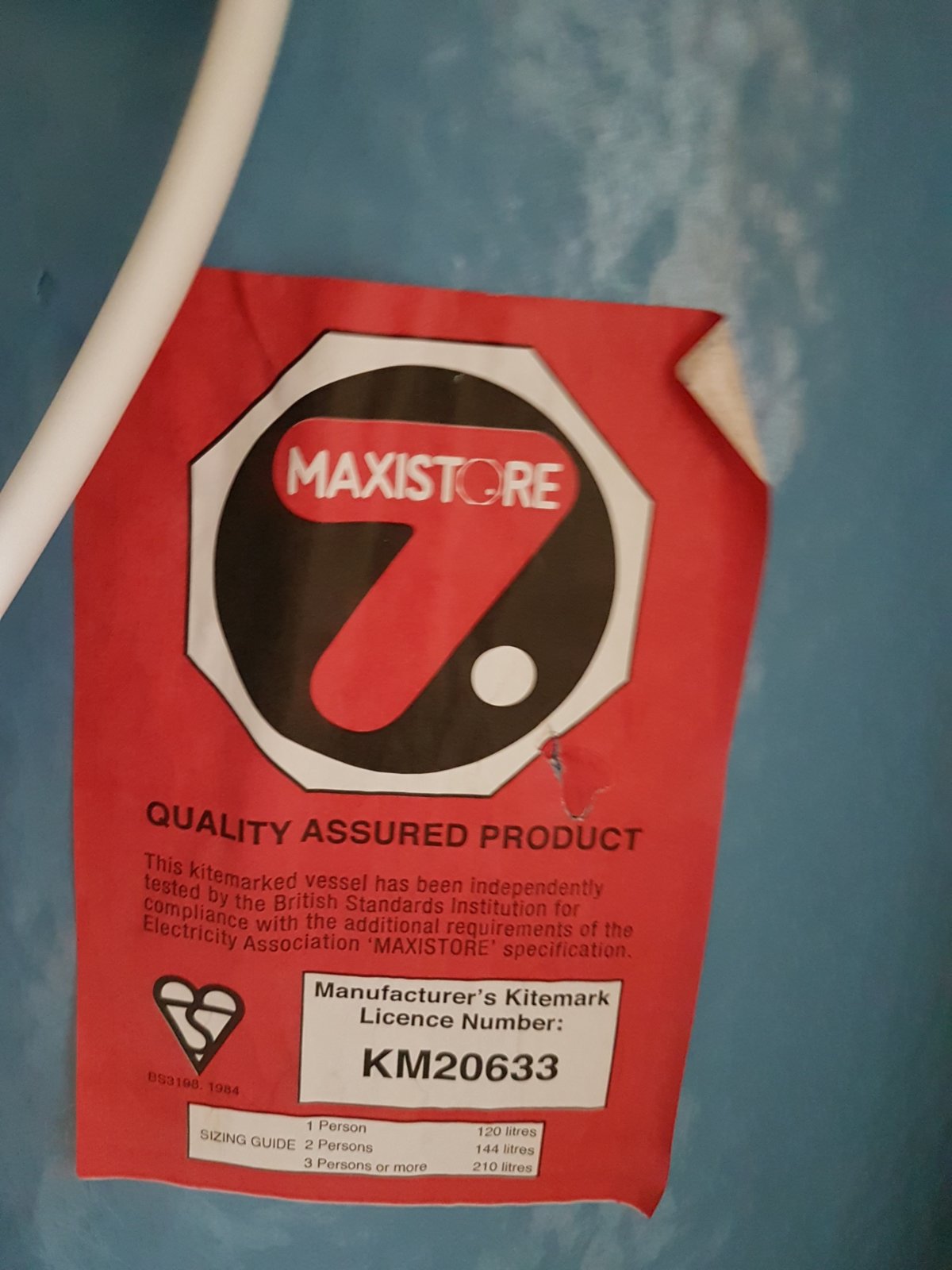

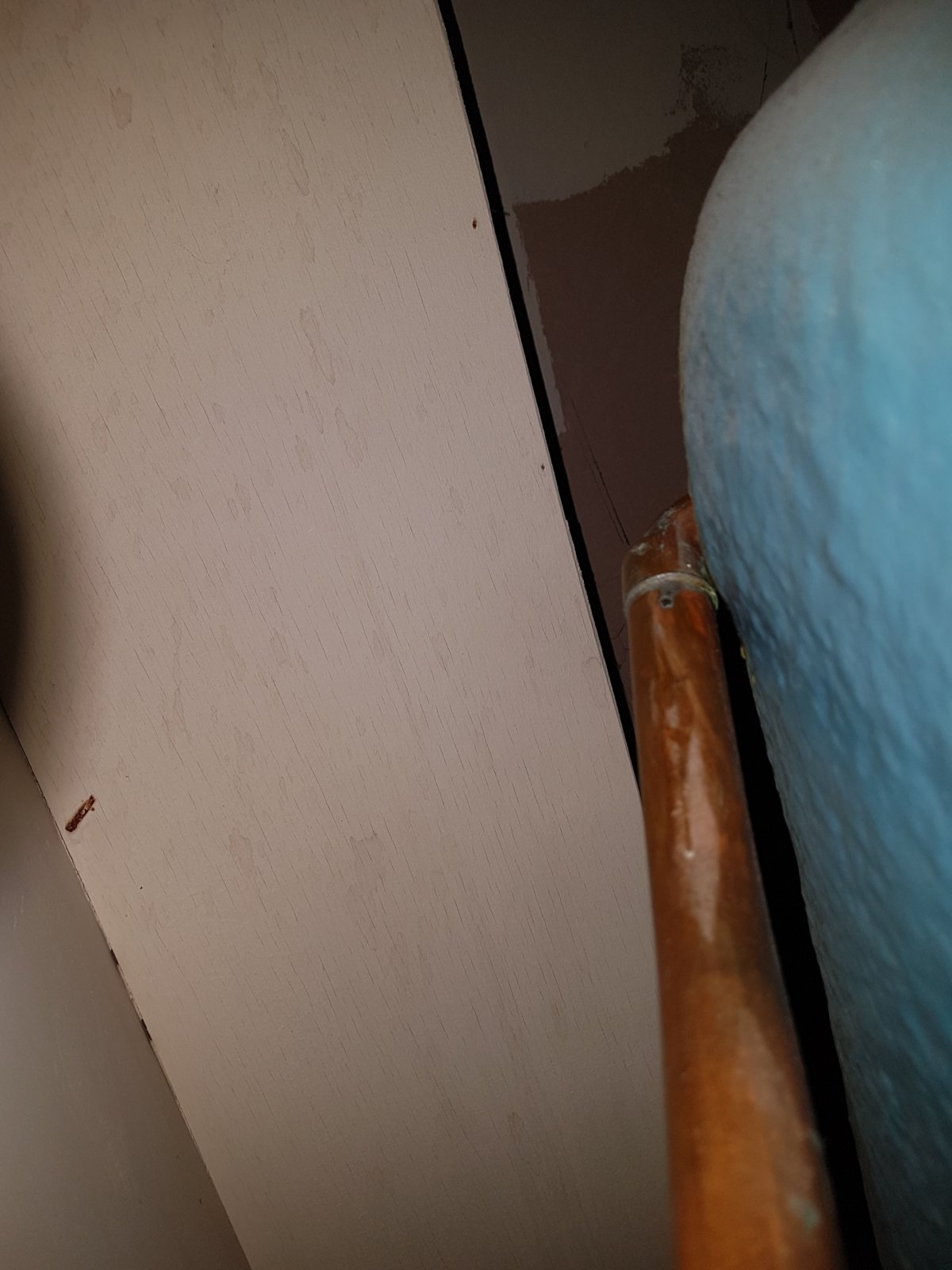

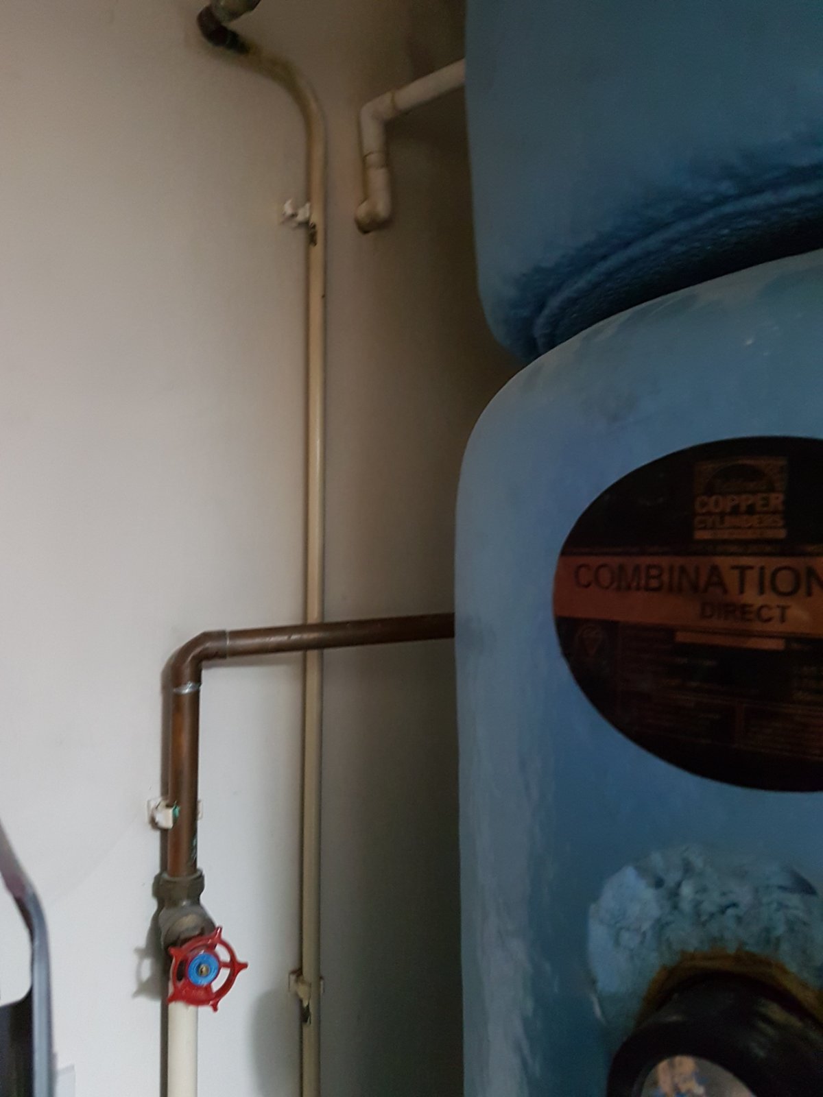

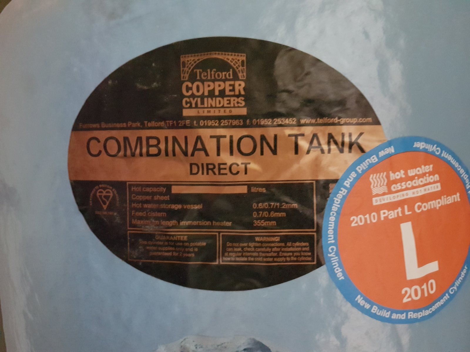

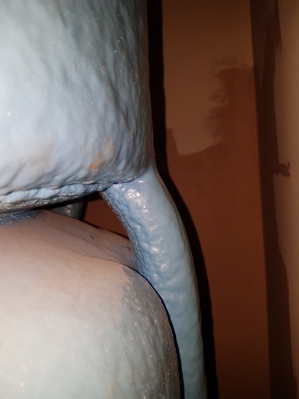

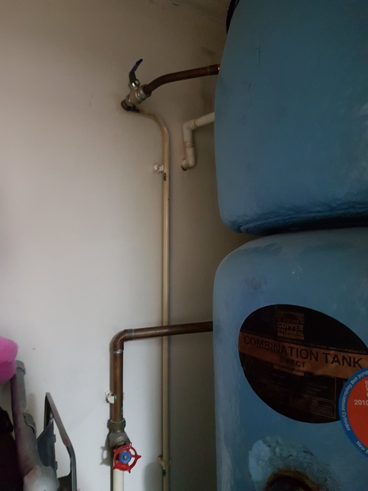

Also I have uploaded photos of the cylinder, it is a direct cylinder with the 2 immersion heaters in for day and night rate. I see the mains cold water going to the top tank and the hot water coming out near the top side of the bottom tank, I can also see the white overflow coming out of the top tank. There is another pipe opposite side that in covered the thermo molded jacket that I presume is the cold supply from the top tank to the bottom cylinder.
What seems strange to me is that the hot pipe doesn't have an expansion (vent) pipe going back up to the top cold tank, is that normal?
Also as you can see from the photo the hot pipe outlet on the cylinder looks like it will be a real pain to try and put a surrey flange on because it is a bit hard to get to, and as there is no vent pipe how would a surrey flange work?

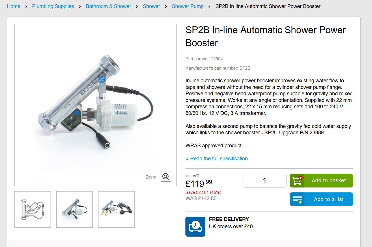

Hey ho... I started a thread about them myself...
Came across this product whilst looking for something else on Google the other day...
http://www.showerpowerbooster.co.uk
I remember seeing the inventor on Dragons Den. I don't think it went to well but I don't trust contrived TV productions personally, I know how they work!
The product looks good and the science behind it is feasible in my limited understanding!
Has anyone on here ever fitted one for themselves and or a customer?
If so, any good? Did you start specifying them to further customers? Would you?
I'm intrigued but would want to get one on trial and test it out on a family Guinea pig first (n)

Many thanks for replies, I will look into this pump.
What about the No expansion/vent pipe, is that Normal?
Any expansion in a combination cylinder would normally be handled internally by the feed pipe. There would also usually be an incorporated internal vent pipe.
If it has an internal vent pipe does that mean I could connect a pump to the hot outlet feed without needing a surrey flange?
The standard feed would normally be below the top of combination cylinder. The only issue is that ideally you want to give the pump it's own dedicated feed to avoid any other hot outlet opening and reducing the flow to the pump. With a cylinder that you cant access or it doesn't have a top tapping then an essex flange would normally be fitted.
