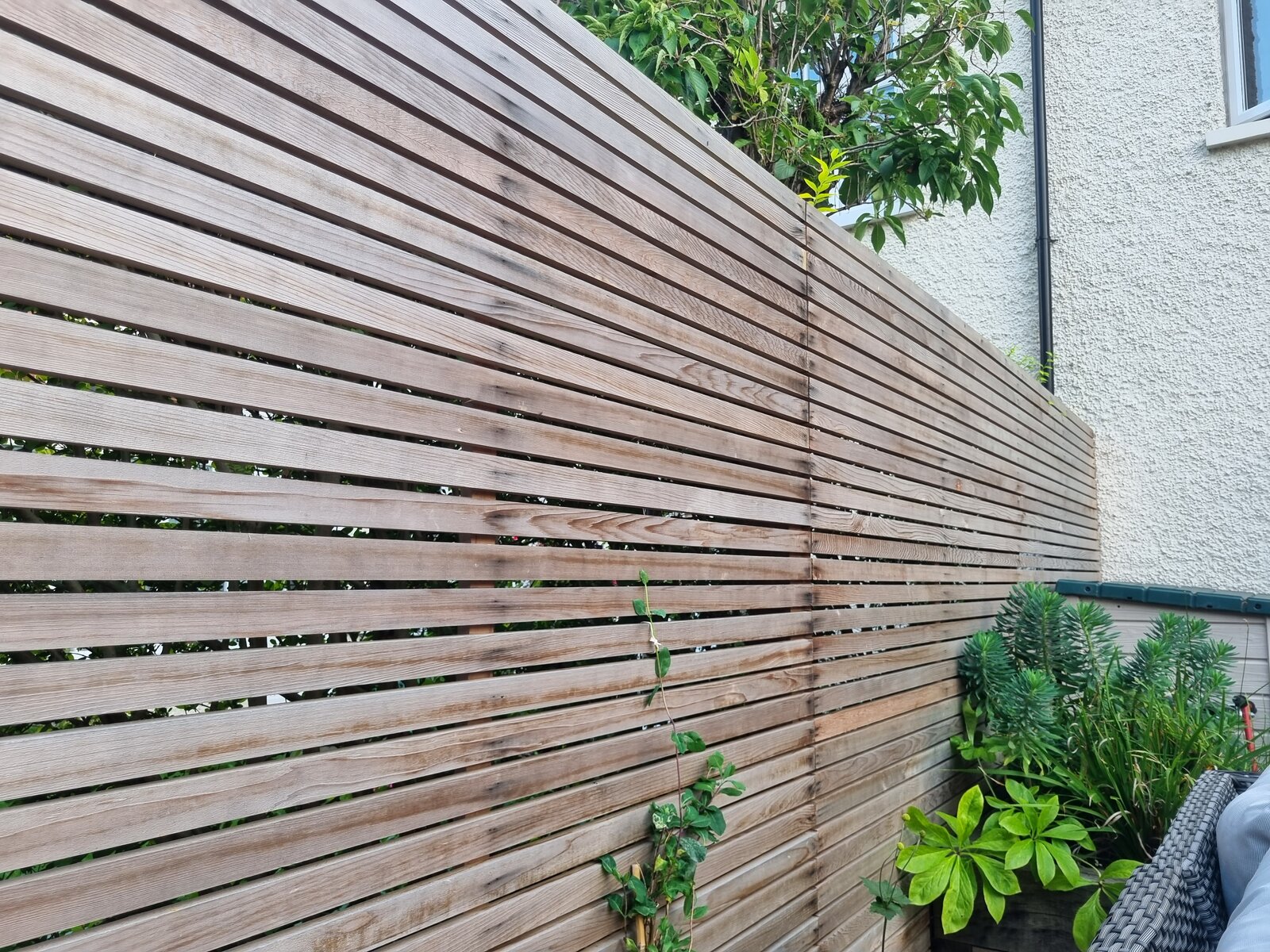

Hi,
My other project I am mulling over. The guys who did our garden project 2 years put in these cedar batons but then used nails that have leaked/rusted or the nail gun used some form of lubricant. It just looks terrible with these rust patches. I looked at the other side of the batons and it's a similar problem so I can't just turn them over. I've tried find sandpapering out the marks but that doesn't work.
I'm thinking of replacing them and then using stainless steel nails (?) which won't leak. I need 35 cedar batons of 3.90m x 2cn x 5cm and 35 of 4.60m x 2cm x 5cm which won't be cheap though.
Thoughts welcome.
Matt

longer term you absolutely need stainless steel nails in there.
After you have changed the nails then oxalic acid will remove the (ink) discolouration.
If you dont change the nails you will need to remove the discolouration every year.
The staining is so bad that I don't think it will get any worse now. New panels would set me back 1500 quid I think so not an untidy sum. So I remove the panels, apply oxalic acid to the wood and then renail with stainless steel nails? Will the acid work or leave a different type of 'scar' in the wood?
The oxalic acid converts the iron tannins (ink) into a clear chemical, you would never know it had been black. It is usually used to clear the black staining on oak objects, also works well on pine.
You should be able to treat in situ I would have thought, except for any rain showers cutting short the change by diluting the treatment.
That is really interesting thank you. So I could remove baton by baton, treat the black stains with acid and then immediately renail with some stainless steel nails? Big job or little job? Either way cheaper than 1500 quid for new batons.

I bought a kilo of pure oxalic acid for about the same price as that, mix as required, keep away from pets children and food as it is toxic.

Thanks. Immediate effect then as soon as it dries and then renail? No scarring?
I has done its stuff even before it dries, it reacts with the iron/tannin blue complex and makes it transparent.
