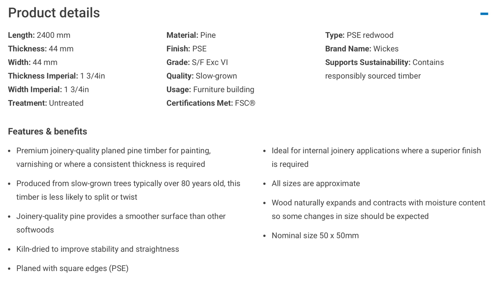

BTW when I was talking to a (different) neighbour he said beware that when you order, say, a post that is 100x100mm it will really be more like 85x85mm! Is this true? Is it true of "beams" too?
Cheers.
Timber is typically sawn first, and then optionally planed. Sometimes you are shown the dimensions for the sawn size before planing, which is a few mm larger than the finished size; sometimes both are shown. For example, here is a screenshot from the Wickes website for timber that they call 44 x 44 mm:
Note that this shows “thickness” and “width” of 44mm (top left) and also “nominal size” of 50 x 50mm (bottom right). So in this case the “headline” dimensions are the actual finished dimensions. I think that today that is most common, but you may still find sellers where the “headline” size in the description is the pre-finishing size.
