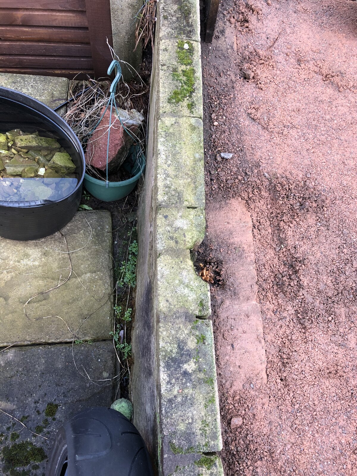

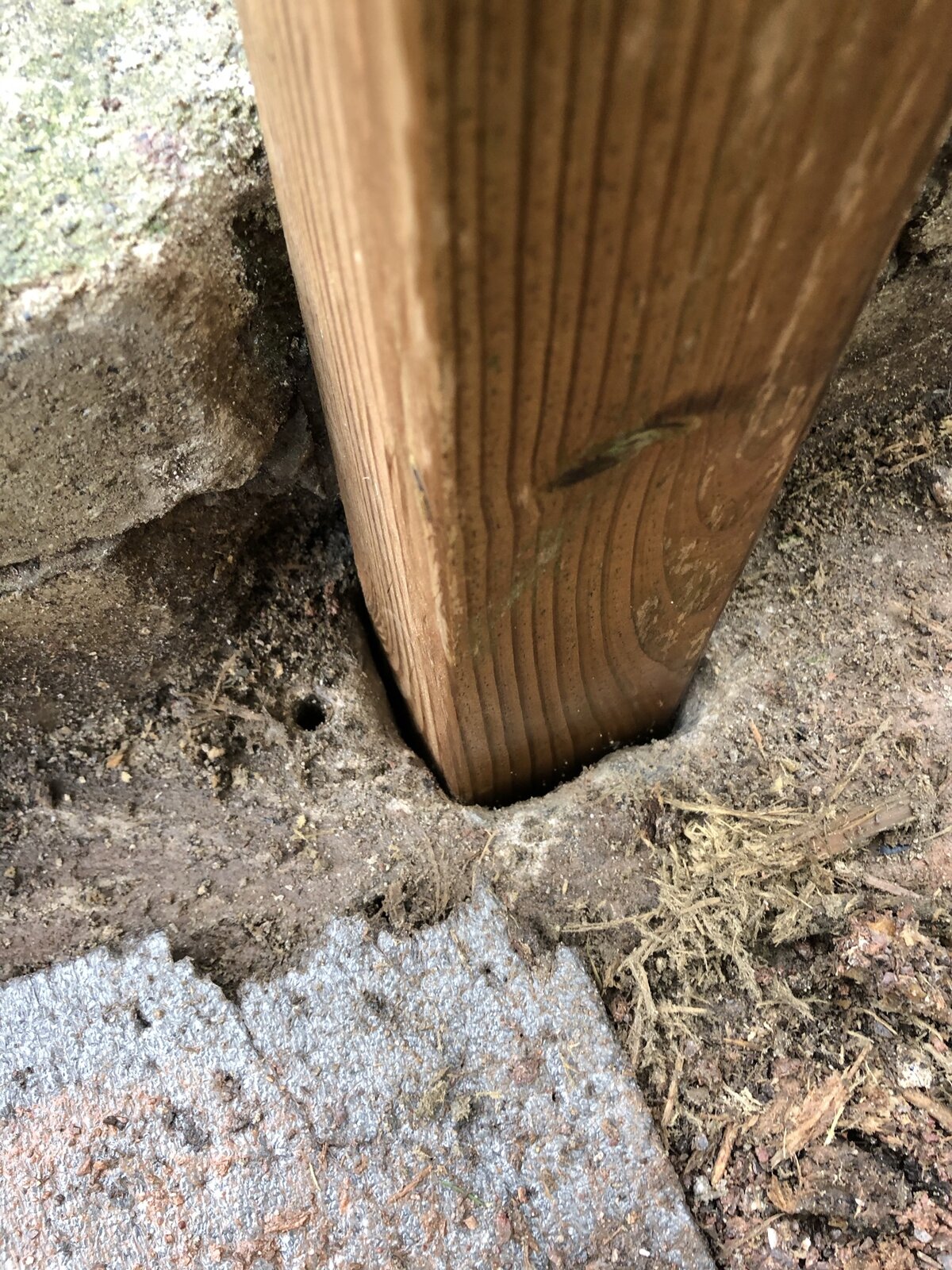

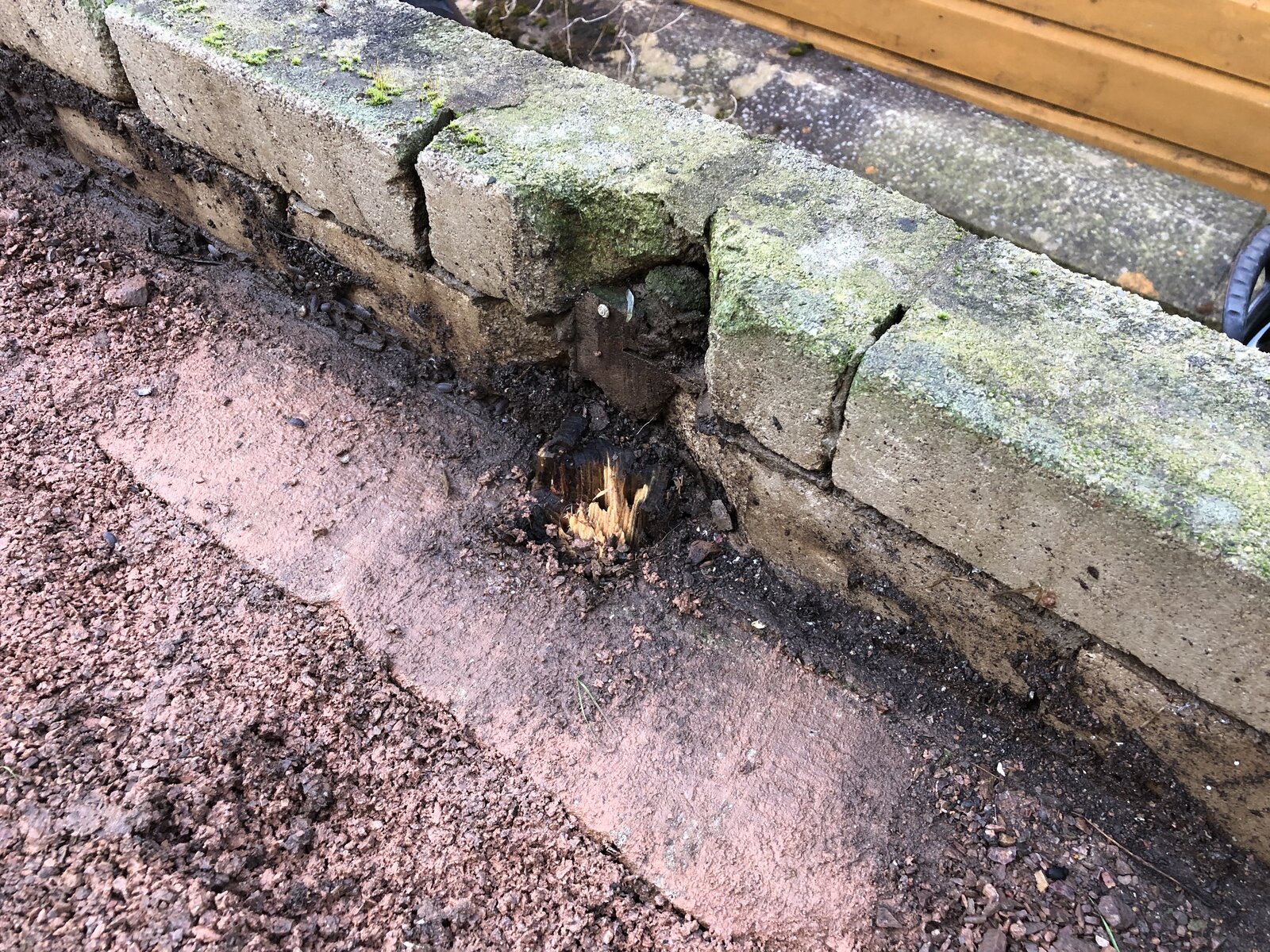

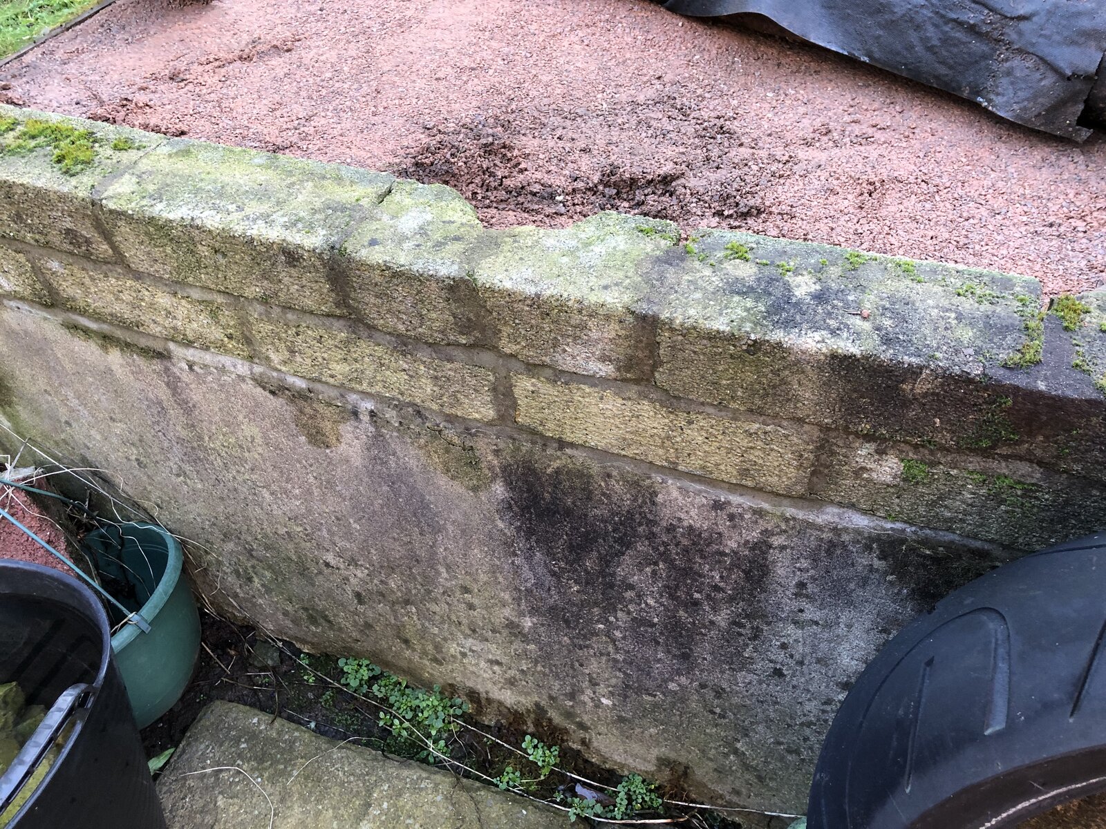

@JohnD the old post in concrete rotted abs snapped. So I sawed that off level to the concrete then screwing an anchor down for the new post. Screws sheared as I’m screwing. Plug is 10mm x 100mm. Screw was 6.8mm x 100mm for the plug. 10mm hole was drilled for the plug as per what the packet of screws said.
@blup i gut all the debris out because the plugs initially would go all the way in even though I drilled. There was always debris at the bottom. So didn’t a while cleaning the holes out so the drill would go in and out smoothly. So I don’t think there was much debris.
Pics of the old post snapped, concrete retaining wall with couple rows bricks on top. Don’t have pic of holes I’ve drilled.
I’m trying to drill a post anchor over the old post. So screws go into that big retaining concrete wall.

Do you own the lower ground and short wall?
You could refit a wooden post into the cleaned out hole, then support it with two 45° timbers either to the higher ground surface or the wall top. The angle could be made steeper.
@Tigercubrider i don’t own the lower ground no. I don’t know if the retaining wall is mine or the neighbours! Perhaps mine if the fence is on top of it. But the brick is the other side of the fence so don’t actually know what’s mine. Best I don’t do anything the lower side of the bricks.

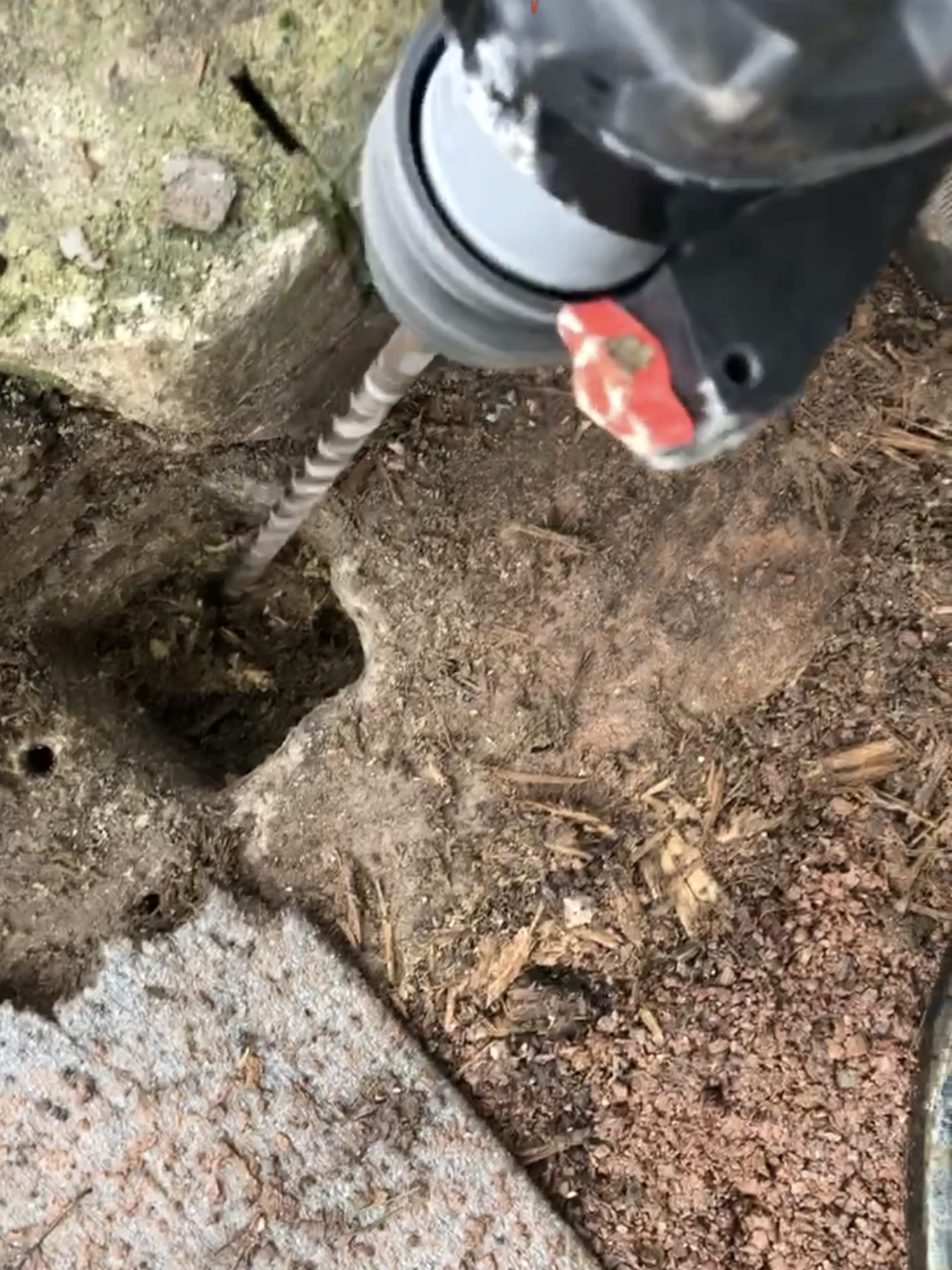

Update on what I did in case anyone else has same...
Decided not to use post anchor because I too think in winds the bolts will eventually pull out.
Chiselling old post out not possible as it’s too deep in the hole
Crow bar on own to chisel and pry and shred was a nightmare
Drilling with wood drill to create holes then crow bar was better but a nightmare
in the end I got a long masonry drill I have to go through house wall, so about a foot long, and with my SDS drill just pummelled it all to bits and this really broke it up much better and it was out in no time.
dropped new post in and filled gaps round edge with postcrete. All seems ok now.
