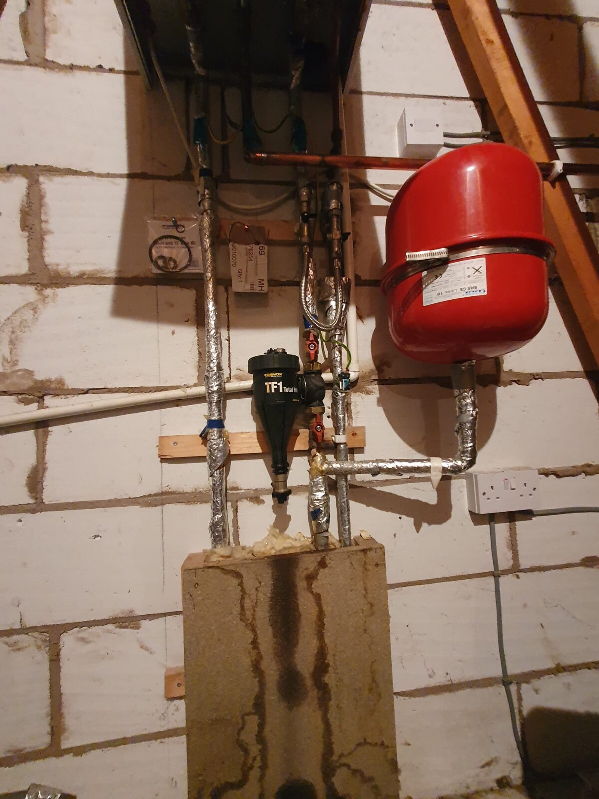

Hi,
I'm looking to replace my Fernox TF1 filter as it's leaking from the top. How do I know whether I need a 22mm or 28mm filter?
Measure the outside diameter of the pipe going to it. Yours should be 22mm. Have you tried replacing the seals with those in that packet hanging up?
