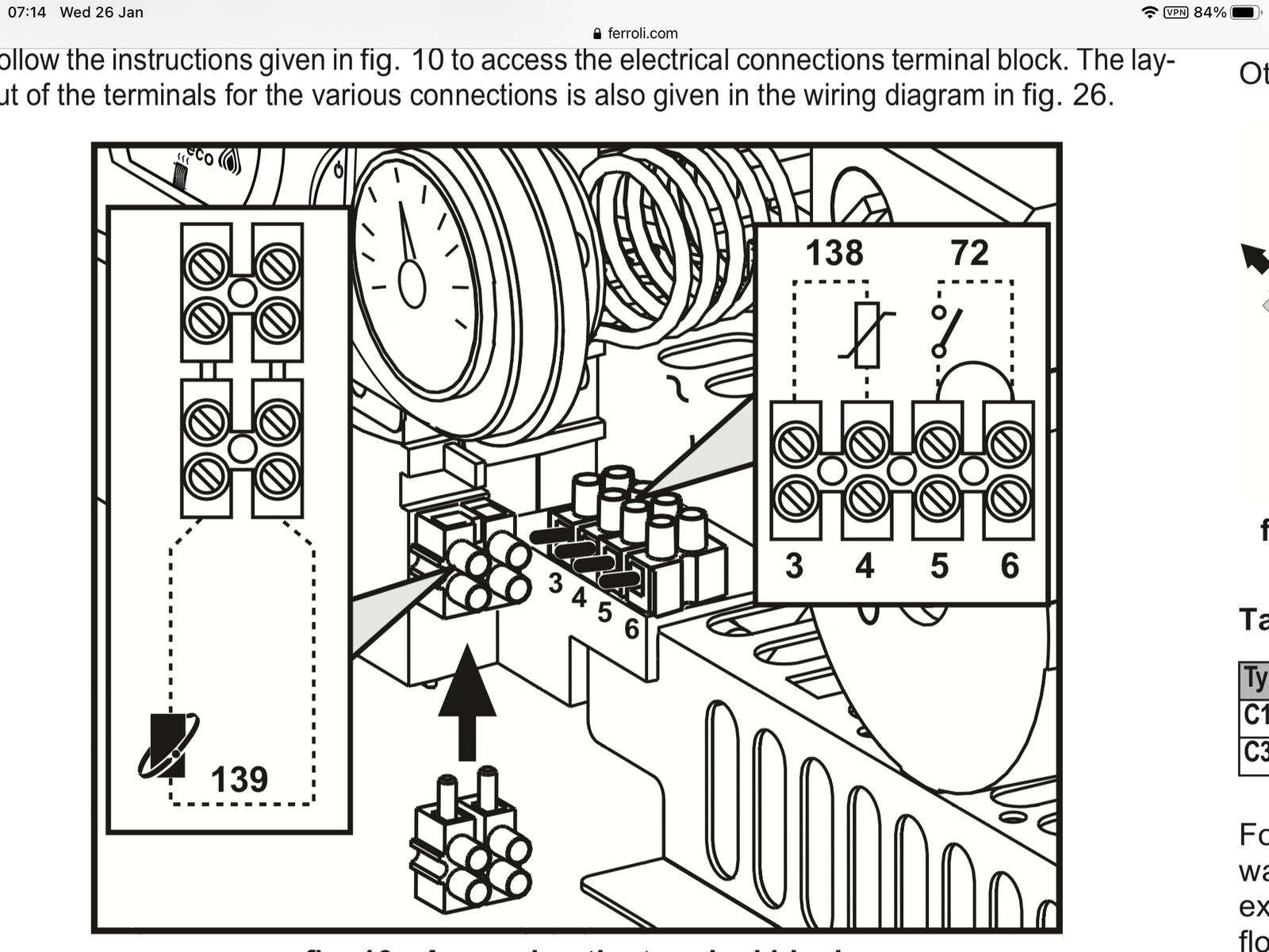

At present, it's got the integrated timeclock, with an external Siemens volt-free thermostat connected to this. This plugs into a little 4-pin plug. (P12 of the manual, which seems to suggest it ought to have a blanking plug if no clock is installed)
The diagram shows that two pins from this plug go to the external thermostat.
The second two pins go to a pair of terminal blocks, and from then to the PCB.
If no timeclock is installed, the diagram shows the pins to be connected through, so it would appear to be a basic volt-free switch.
However, the timer manual labels these two pins as OpenTherm (attached pic)
It therefore appears to me that I can just pop out the plug and connect straight into these terminal blocks with the new thermostat.
If it supports OpenTherm, all well and and good, and if not, as far as I can see, it'll simply function as a volt-free switch.

Simple
Where is the difficulty??
You do not need the timer so remove it
Open therm from TR6 goes to 139
If OT does not work, put a link in 72
