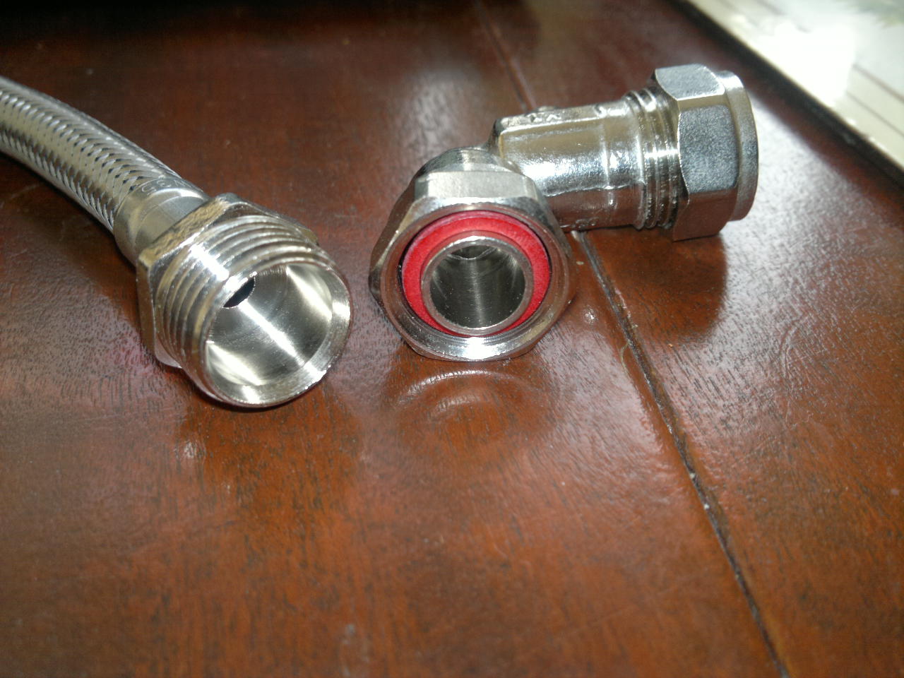

I have a 90 deg isolation value with a fibre washer in one end.
Can you fit/mate the end of a tapered compression fitting (ie nut and olive removed) to this ??
Or should I be using brass hexagin nipple (that has a flat end) into the fibre washer end.
What is the difference between a Service Valve and an Isolation valve, the former contain fibre washers, the latter Olives.
Pics illustrate ...

Definitely not - guaranteed to leak
Fibre washers are designed to face seal against a mating flat face
A "service" valve is to permit 'servicing' and in my experience, may drip or pass slightly
An "isolation" valve is designed to isolate a supply and should never drip or pass

Take a flat file and flatten down the edge of the compression end until there is a flat face. It's brass so it files really easily. The fibre washer will sit on that quite happily. I do it with flexi tap tails all the time so the edge of compression ISO's don't cut into the rubber washer. Just don't overtighten.
It is a bit of a bodge though and you should really get the correct ISO valve, a service valve is for a direct connection to a valve or outlet, and ISO valve is more for an in line connection
Thanks for the good advice, yes aware that the tapered end of a compression fitting might cut the rubber in a flexi fitting (I'm trying to connect tap tails to 15mm copper, that comes out the wall at 90 deg, and avoid the flexi being too bent/curled).
OK ... so ended up replacing the 'service valve' with a compression 90 deg isolating valve:
https://www.toolstation.com/900-cp-isolating-valve/p82153
And bought these Flexi/Taps tails to mate with the rubber flexi end:
https://www.toolstation.com/tap-tail-adaptors/p14081
