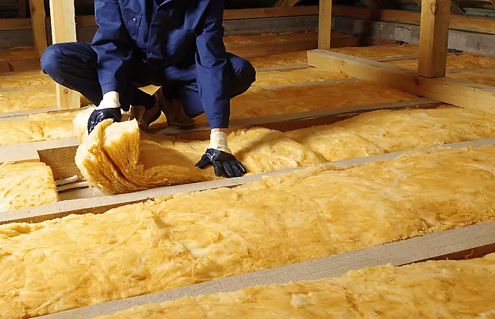

I looked on Wickes and B&Q websites. They don't use the word fibreglass, most of the stuff looks like mineral wool, but they don't say fibreglass is no longer allowed. I'd have thought they'd say so if that were the case.
And this pic is from B&Q - it looks a lot like fibreglass to me!
That would be a con. You want 300mm to match current standard.
So that kind of out and out lie would be enough for me to dismiss them outright.
Do you mean fibreglass hasn't been banned? If that's the case it was a lie, but I don't think I've bottomed it yet. The stuff in the B&Q pic looks like fibreglass, but it might not be, and it doesn't say.

That's right
They cold-called you, and then visited.
Fibreglass is not banned.
As I understand it, all of these similar materials are described as “mineral wool”. Whether the raw material is glass or rock or some trade-secret mixture doesn’t much matter. I note that Knauf sell a product that they still describe as “glass mineral wool”.
It is true that newer products may be less nasty to handle than old-fashioned fibreglass, due to some additives. This doesn’t much matter once it is installed.
Thanks, that's clear
Agreed, might be worth adding more (fibreglass or mineral) on top, but can't see why you'd remove what's there.
