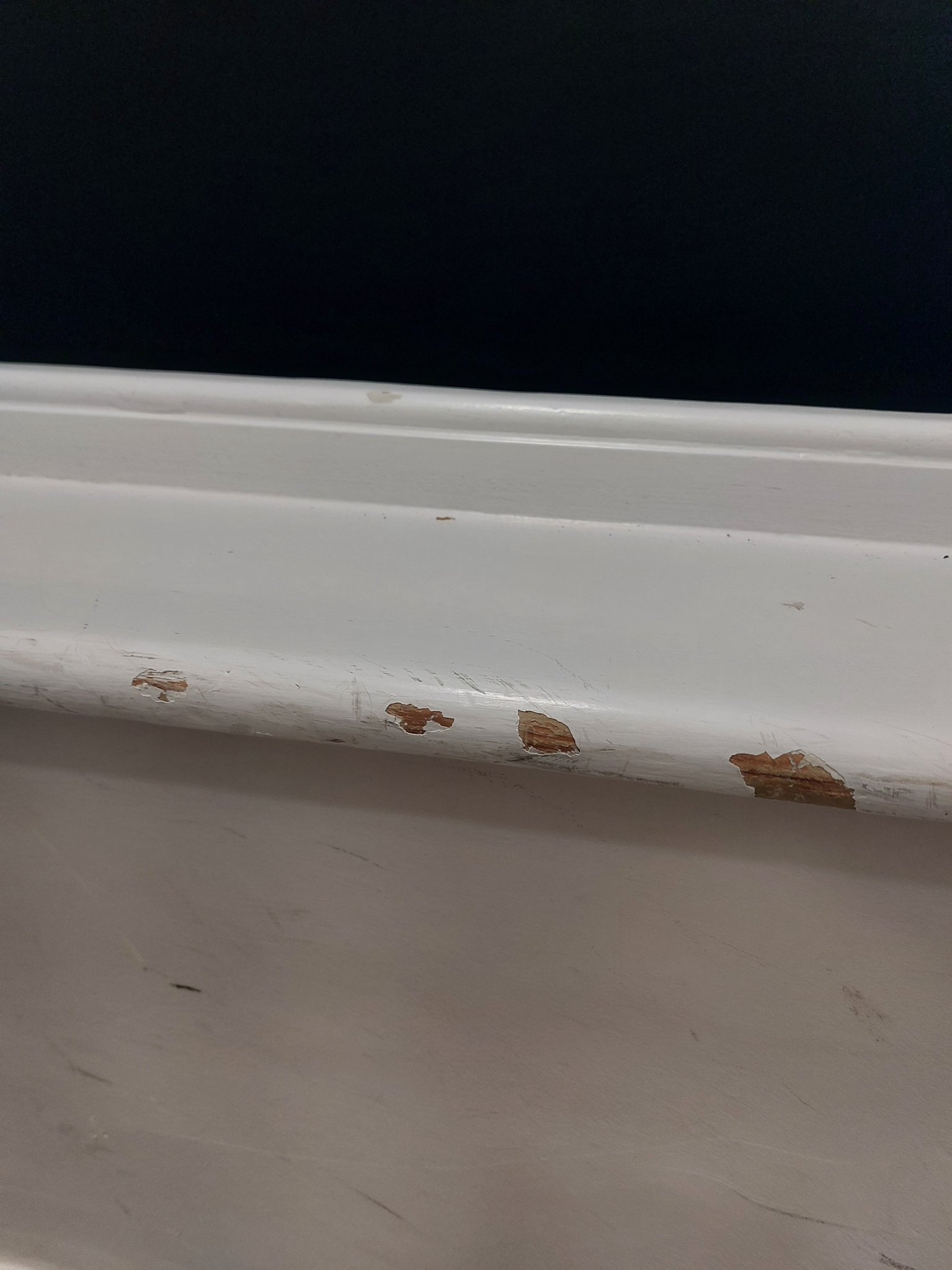

I need to repair some deep paint chips on a wooden window sill and also some other areas, skirting boards and stair spindles, etc. The paint chips are quite deep, probably at least 3 or 4 layers of paint have been removed.
What is the best product to fill in these chips? I have tried a little pollyfilla but it is quite hard to get it to stick, in particular on the curved edges of the window sill.
Attached is a photo of the window sill.
Thanks.

Sand it all.
Undercoat it all then fill.
Toupret powder filler I would use although you can use a ready mixed..
Use 320 grade sandpaper on some wood.
I stick it on some scraps of wood with PVA so sandpaper is flat.
If you hand sand you will likely sand all the filler off as your hand isn't flat.
Other way is to use 2 pack wood filler.
That's resin mixed with hardener.
Bit more difficult to use and harder to stand.
Many thanks.
Just looking at Toupret powder filler, for my repairs any thoughts on whether to use the 'Interior Filler' or the 'Patch & Repair Filler - Quick Dry''.?
Thanks again for your advice.
I mostly use tx110.
Very similar products.
One dries faster although I use a hair dryer as that speeds things up. Often it will dry in a minute.
So whatever. They all will work. You in a rush and don't have a hair dryer then use the quick dry
