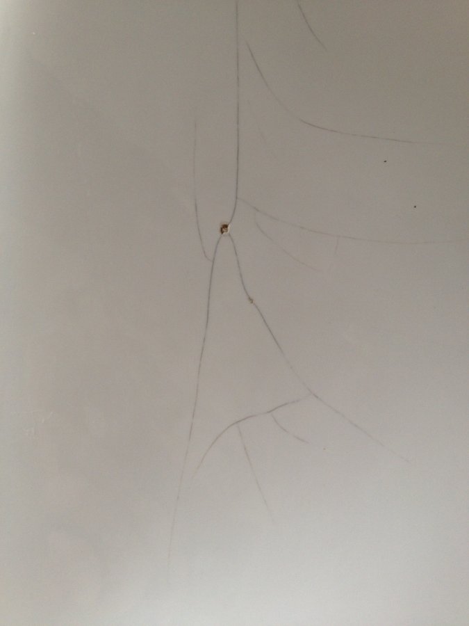

Hello, I know it's not exactly a plumbing question, but I didn't know where else to put my query. please feel free to move it to a more suitable section.
See pic attached. Can anyone suggest a product I can use to fill a small chip and a few hairline cracks in my sink please.

Like the other, I wouldn't bother. Those cracks are due to the chip and they will only grow over time.
If you wish though, Milliput is an old remedy for chips and scratches in porcelain.
As Madrab said, Milliput works very well for minor chips. Once set finish off with wet and dry sand paper.
Sounds like a lot of hard work for cracks though.
To ensure Milliput adheres to the basin crack, what care or precautions do you need to take to ensure that it is dry?

Ive use quite a bit of miliput superfine white for repairing chipped china and it can be shaped with wet hands...even sets under water so getting the repair area dry may not be an issue so long as its clean?
