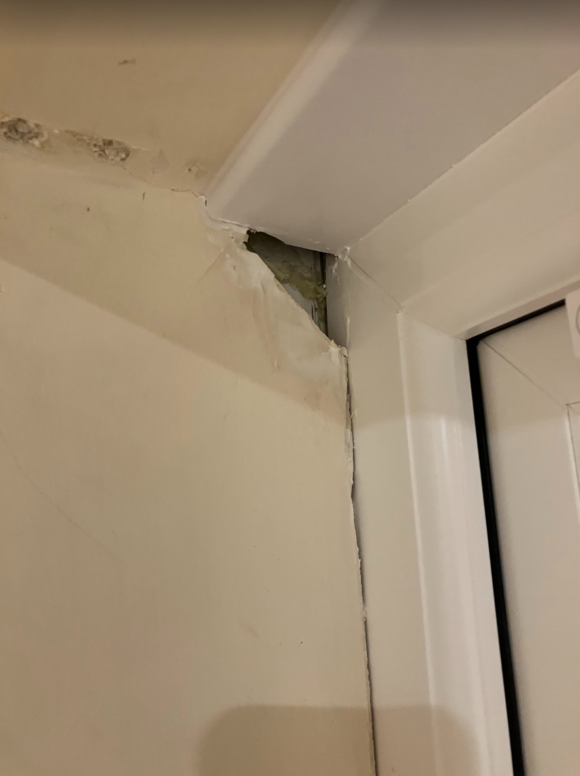

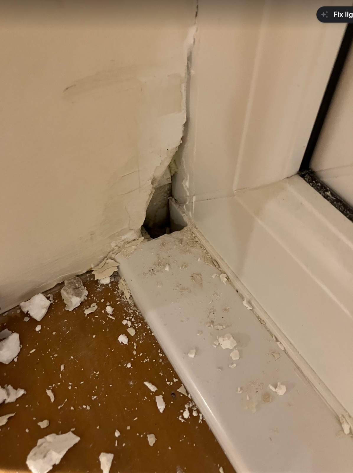

Hello,
I had new windows fitted a couple of months ago. The old windows had some odd shaped trims on them so where the new windows have been fitted, there is a gap at the edge of the reveal. The window fitter filled these gaps with filler, but it has started to crack. I have raked it out and it would appear it probably cracked as theres nothing behind it to grab to. What would be the best method to fill these gaps and prevent future cracking? Would it be expanding foam and then filler on top? I was intending to use painters mate for the long thin gap down the side of the frame (existing silcone raked out).
Thanks & merry christmas!
See photos.
Given that you are filling up to existing rockwool type insulation, I would lightly mist the insulation, apply making tape to protect the upvc and then spray in expanding foam. Once cured, cut back so that it is about 5mm below the surface. Then use a filler such as toupret tx110.

The spray of water before hand is important, it will help adhesion and increase curing times.

Another tip with it; try not to make it too deep; fill big holes in stages. If the outside of a large ball of foam cures it tends to lock the solvent in somewhat for the inner, which then causes the cell structure to collapse before it sets. Same for filling up holes where all the surround is non-porous
