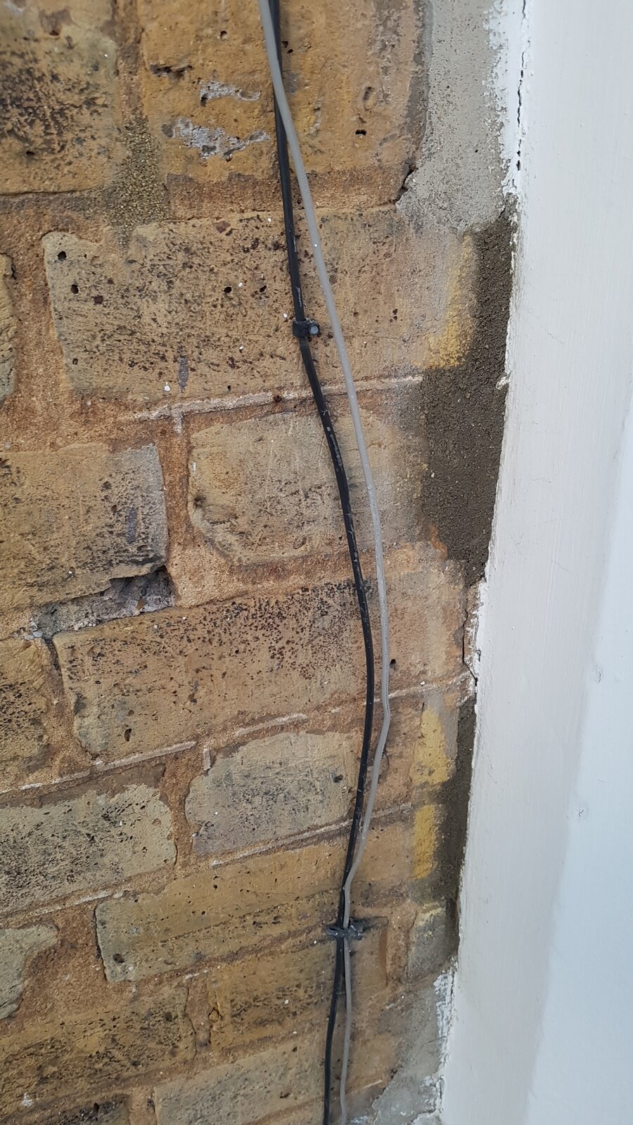

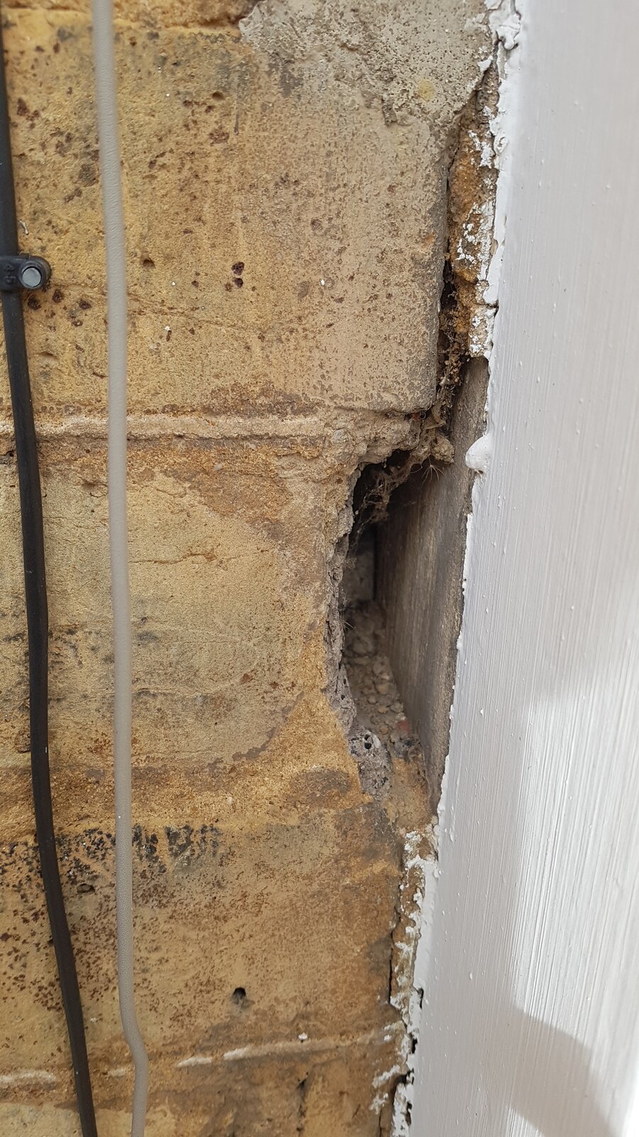

Hi guys. I've never done any work with cement and sand until today. Yesterday I bought coarse sharp sand and general cement from builders depot. That was to refix a patio slab which I've done now. Builders depot recommended coarse sharp sand. I thought they might suggest fine sharp sand or builders sand. But anyway, I've now got a 40kg bag of it to use up. Is coarse sharp sand also ok for pointing bricks? I'm thinking of redoing some of the pointing around the house and filling gaps where it's fallen out.
Today I mixed some up and filled a couple of holes in the front wall of my house, but it's very brown. What should I have done or used to get it lighter and blend in like the repair above mine? It's also got quite a rough texture, not smooth. But I didn't add much water, so it was quite clumpy, but just enough to hold together. Maybe it should have been creamier.
I'm quite happy to smash it out and start again.
The hole

Sharp sand in mortar will always give you that rough gritty finish- some people like it. It'll get a bit lighter once its gone off.
Building sand tends to be a bit paler, get one of those £2 bags from Wickes or wherever & try a wee mix. And yes you want it a bit creamy otherwise it won't go off properly

Thanks oldbutnotdead. Alright then I'll get some builders sand because I prefer paler and less gritty.
It will become much paler, as it dries out.
