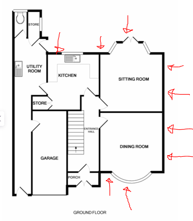

DPC: I will lift some boards and find out. I have a feeling it's a sort of slate between layers of brick, which based on what is visible on the garage which sits slightly lower than the rest of the house it's around 1 or 2 bricks below floor level in the rest of the rooms.
For what it's worth (I guess very little) the survey when the property was purchase did not indicate any areas of concern for damp.
Air Bricks: Marked with red arrows.
The "Sitting Room", "Dining Room" and Kitchen are suspended floors. The Entrance hall is concrete.
Filling in the Sitting / Dining room would leave the kitchen on a suspended floor for now although I plan to rework that entire area in the future. The kitchen would have two remaining air bricks
Drain Gullies:
At the back of the house there is one for the kitchen sink and one for rain water.
Right side of the house there is one for rain water.
Front of the house there are two for rain water.
The slugs mostly appear in the sitting room near to the external wall (right of image).
The sitting room and dining room appear to have plenty of airbricks, providing they are not choked and are not low enough for water to run in. How far above ground or paving level are they? Do you ever get puddles against the house?
The DPC should be visible outside the house, and at least nine inches above ground or paving.
Where are the drains? Please photo
Do you have clay gullies?
How old is the house?

- Find the cause of the likely leak, digging in a 4ft space with a mini shovel isn't the worst job (except in this weather)
- Fit mesh to the air bricks to stop slugs getting in
- Insulate between the floor beams to improve heat retention, and also ensure nothing can get up into the room
- Fit heating onto new sub-floor layer
- Relax
Will be quicker, cheaper, cleaner and just as good as filling in with many, many tonnes of type 1 and concrete. And you won't need to move out to do it. You'll also still have a space to put anyone who dis-pleases you!

I'm currently in the process of getting some quotes to fully fill the floor and to see where that leads in terms of time, disruption and cost.
I'll investigate the damp / water ingress issues at the same time.
