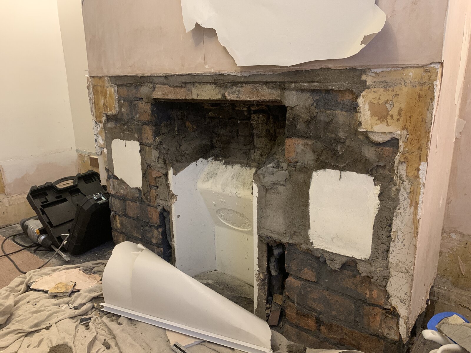

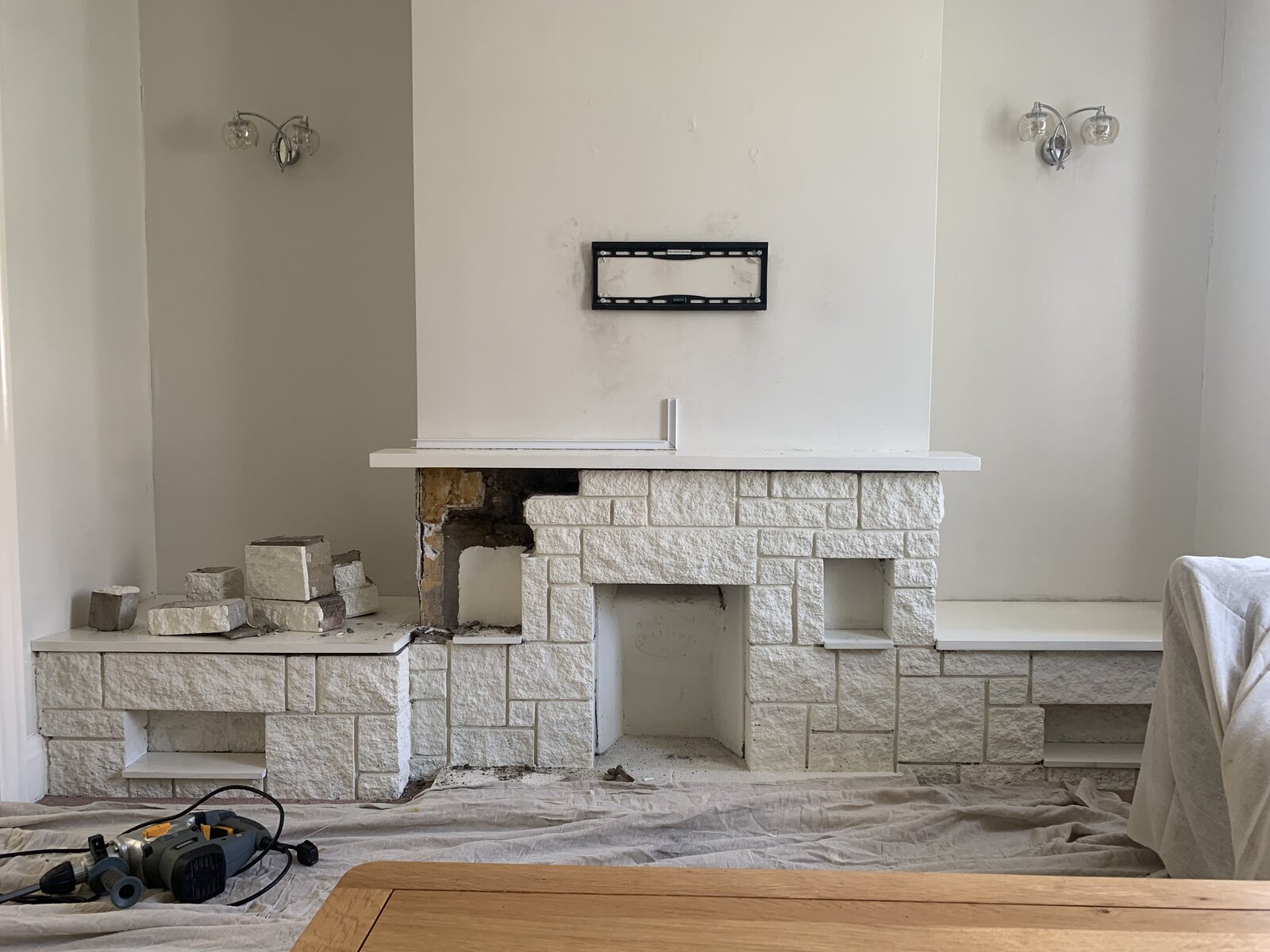

Hi folks,
I had a terrible old 80s brick fireplace and I’ve just removed it (see pics)
the original 30s one was clearly removed before.
looking at it now, I expected to see a lintel or support above the hole for the chimney stack.
there are two massive bricks there.
can I check, this looks properly supported? I was just expecting it to look different.
also, I plan on cutting plaster board to cover the hole. Is this a good idea, any advice on best way to patch it up appreciated.
I would put a vent in it BTW
thanks

I thought I could almost make out an angle iron lintel under those bricks, but maybe not. Yes You should put a lintel in if not

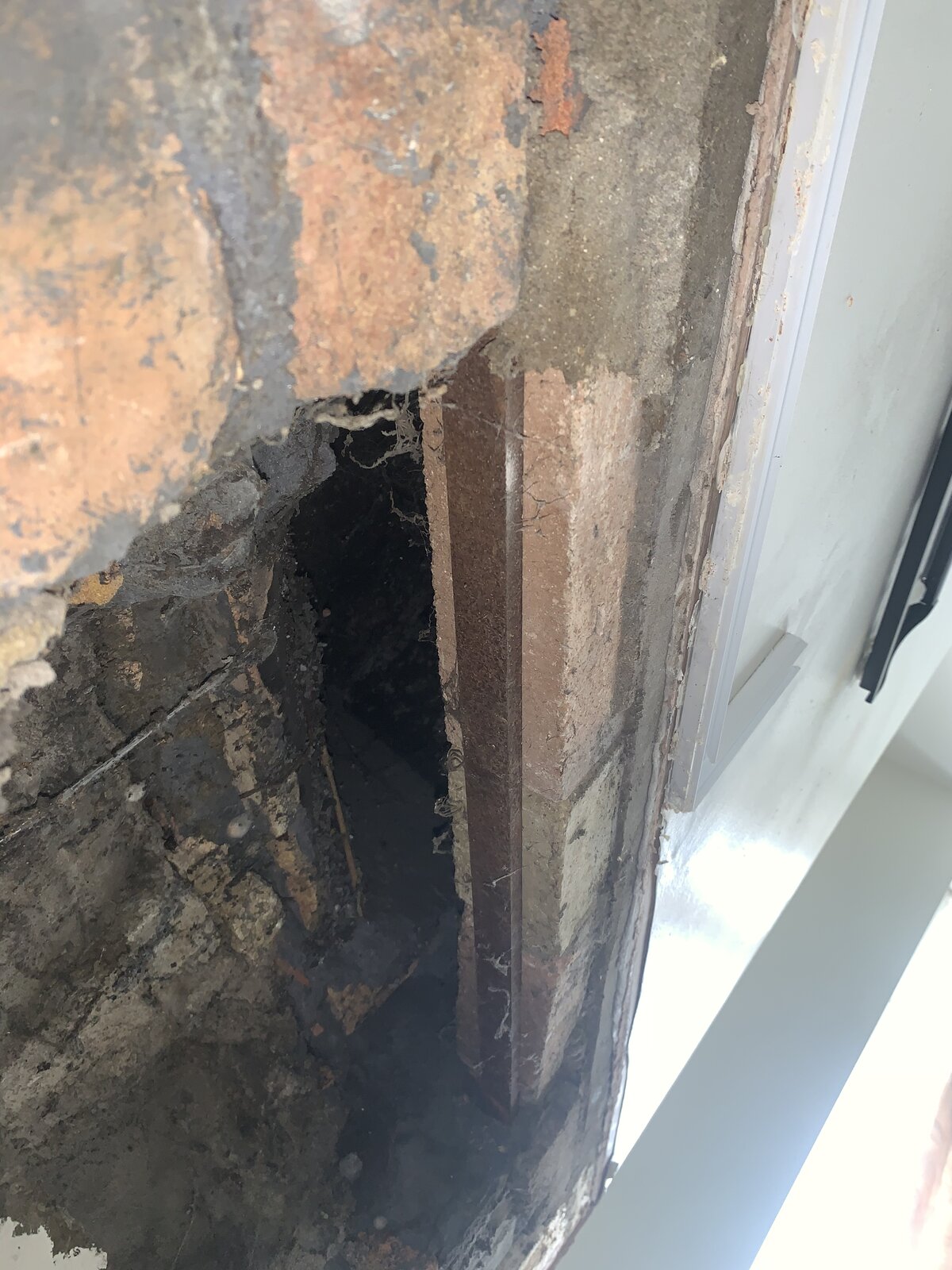

Is this a lintel? I was expecting something much more sturdy, this is only inch and a half by half an inch?
That’s your support, yeah. If it’s all still straight then I’d leave it alone. It’s only supporting a triangle of bricks above it, rather than any massive load. Otherwise known as a flat bar...
So, your idea is to remove the faux stone fire surround and the two wings?
And then block off the flue and make good to everything thats been disturbed?
You intend to use a piece of plaster board to cover the fireplace opening?
Whatever you block off with you must have a vent installed for through venting the flue from bottom to top.
It would also pay you to wire brush off all visible soot staining, and sweep the flue and smoke test it.
Whats happening with any other fireplaces or chimney breasts esp the fireplace in the room above?

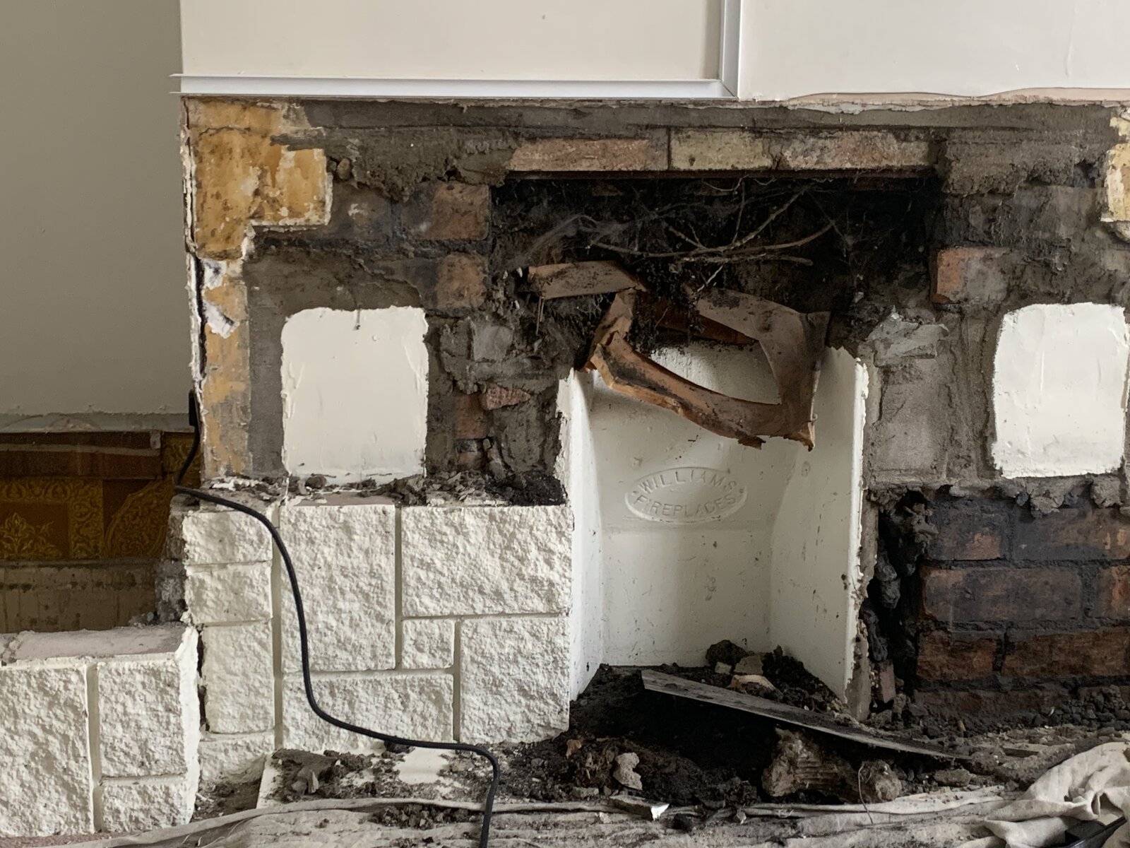

I don’t know about the flue, it’s as it was when I moved in and as it has been for probably 25 years.
it clearly allowed air up and down as soot would come out.
it seems dry in its current state.
when I took the faux bricks out a metal hatch fell out - very thin metal. I presume this was once meant to stop spot coming out but clearly wasn’t working.
so, given all seems well from damp perspective, the idea was just to board over the whole thing and put an air vent. It’s basically the same thing as now, but with vented p board.
Some soot May come down, but a lot came down when I removed the brick and nothing has come down since.
there is no fireplace upstairs there’s just a brick flue leading up to the chimney stack.
The idea is to board over the whole area - see the pic.
I’m planning on chipping off some of the ragged plaster up to a dog tooth line, boarding the whole thing and joining to the existing plaster.

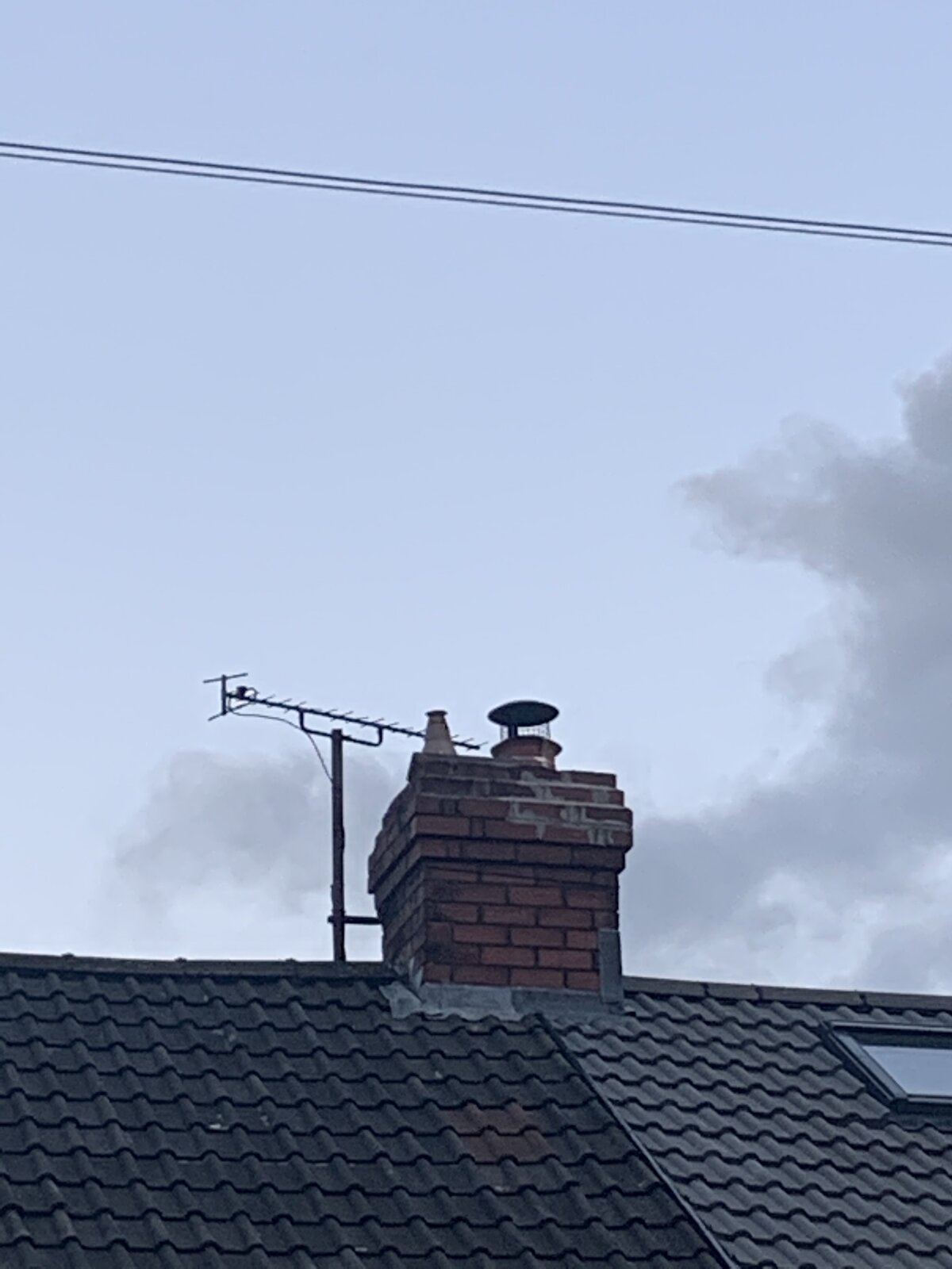

I don’t know if this helps but this is my chimney externally - it’s the one on the left.
I think that’s a cover isn’t it?
fwiw: Is it possible that the upstairs fireplace has been totally blocked off?
Just seen the new pic - the chimney terminal on the roof stack is too blurred to say what kind it is but it seems to be doing the job.

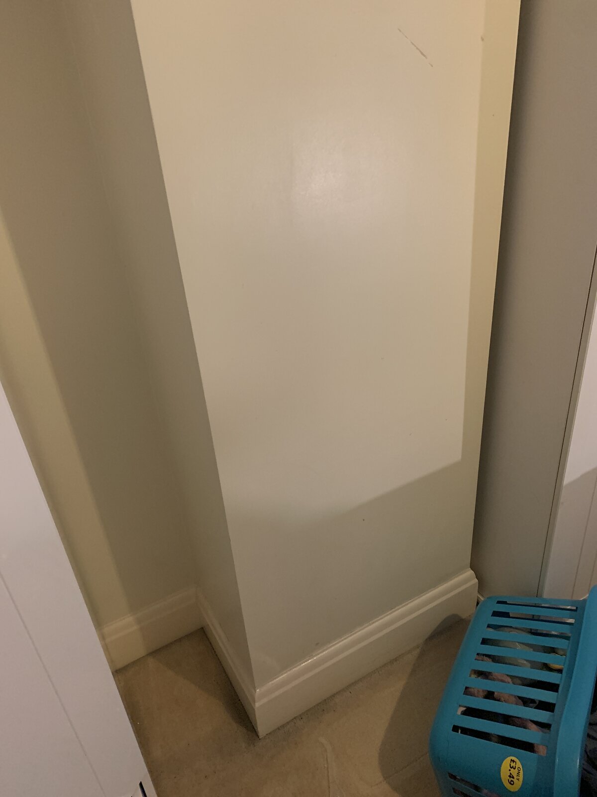

that’s what’s upstairs - I tapped it and solid throughout so assume heat was provided by the warmth of that rather an another fireplace.
I’m sure it was good building practice and I’m happy to fit another if it’s necessary.
I’m a novice and I haven’t got the dollar to pay professionals sadly
Well novice, your right, thats simply a chimney breast for a single flue.
