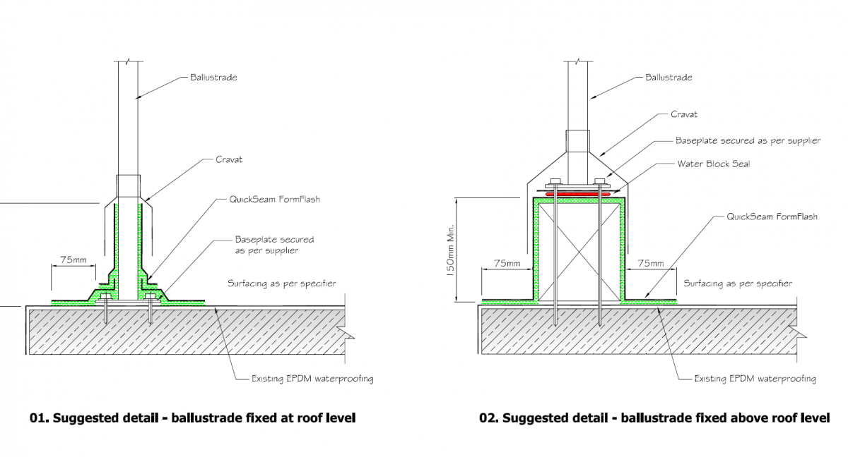

I have just had a reply back direst from Firestone, and they have offered this as a solution
This would do it, but if the minimum height of the Flashing is to be 150mm, I think its going to look a bit cr@p. Unless the Balustrade co can offer a 'Cravat' of >150mm.

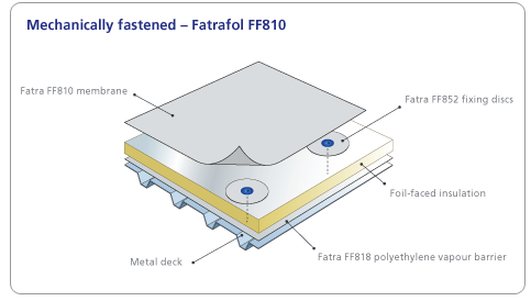

My apologies, I have now found out that the product is not Firestone, it will be Fatra FF810.
I assume this makes it a Warm roof then. This looks even more complicated to install the Baseplate underneath....

The basic principle is that you have a structural plate, plinth or kerb above the roof deck, and which the balustrade is fixed to and the roof cover dressed up and over. As per FMT's detail.
What will happen, is the balustrade will rock ever so slightly, potentially flexing the fixing holes. So you need the fixing point above the roof deck and into something solid.
