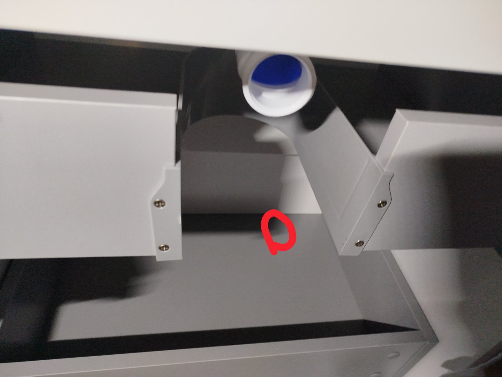

What's best to first fix the waste pipe for a vanity basin like this? Is it to run it the wall and elbow out?

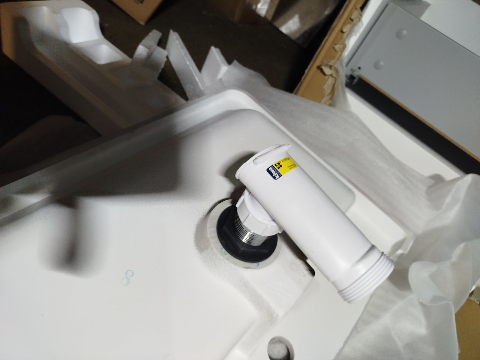

What kind of trap would you put on it? Is 300mm a height that will the elbow on to a trap. Obviously I don't want to be too height or have to use a load of fittings after it exits the wall
It's come with this trap and I don't no the the exact finish floor. As floor is to go down this tile. Do they do an adjustable trap connector so I could come out abit low and use this.

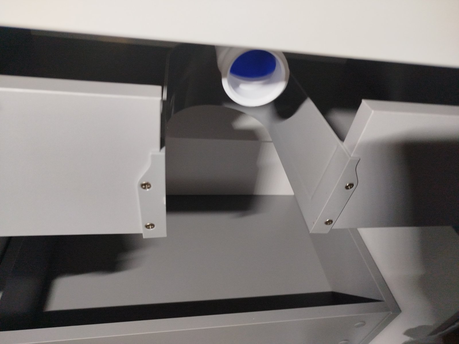

Just fit that with 2 bends to take you down to the incoming waste pipe.
Thanks yes I think the best way maybe to bring the waste pipe in low and then use two elbows maybe a street elbow then an elbow. It's all in solvent.
Would you sort of bring in around this height then double elbow?

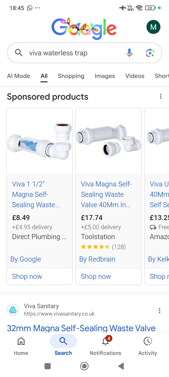

One of these
  • Screenshot_2025-12-04-18-45-59-743_com.google.android.googlequicksearchbox.jpg
Thank the one is it's come with it tight to the back of the unit. Don't think I'd have space for two elbows up to the trap with that one
