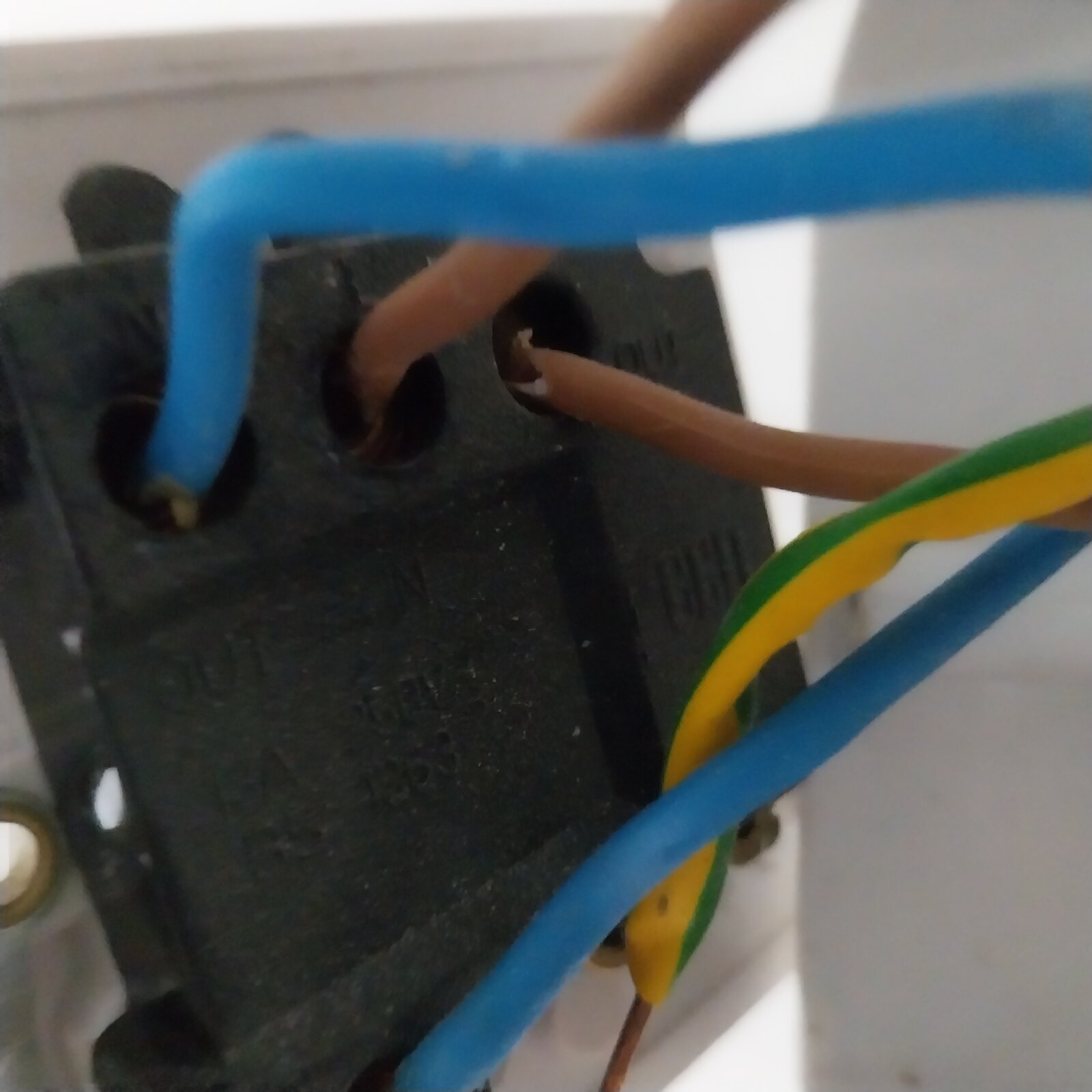

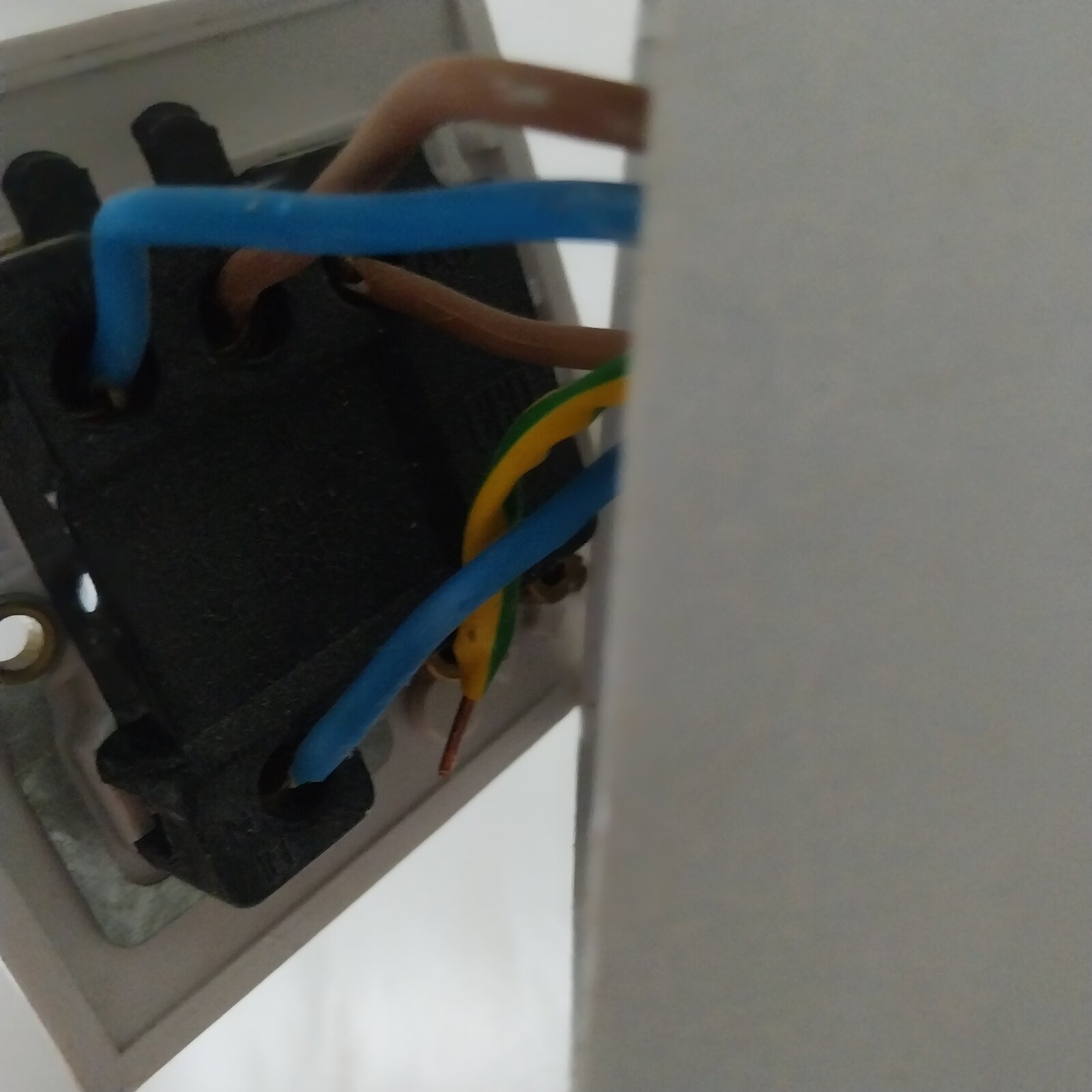

Hi
I was trying to fit a light using existing wiring where a cooker hood had been, this was in a fused terminal, so i assumed one set of 3 core cable would be incoming live and the other would go to the hood, so my plan was to fit a wall switch to live incoming then from switch t the light but when checking which was incoming cable i discovered both sets where actually live,
totally stumped now
the fuse has been removed since we got possesion of property
Hi When trying to fit a light fitting using the wiring that had fed a cooker hood, there was a fused switch with two cables assuming one was supply to the fuse and the other fed the cooker hood. i fitted a wall switch wanting to put the live to the switch and the switch up to the light, when check which was the incoming i discoverd both were live , that stumped me
any advise welcome, the fuse has never been installed all the time since we took over property
hope this is ok
do know if these are any better
i tested by wiring a plug socket to each line and trying in socket tester
Sounds like it is a ring final with the appliance cable removed and you are left with the 2 legs of the ring. Post pictures of it and the consumer unit.
