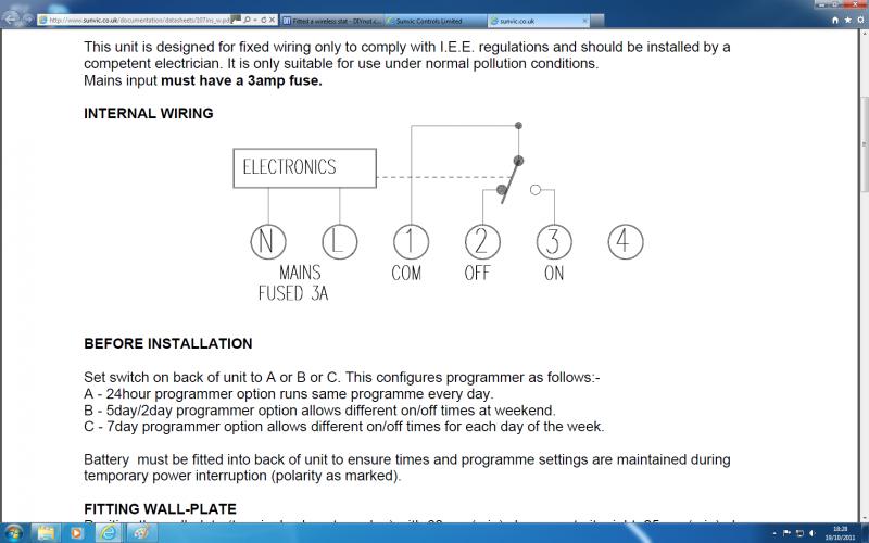

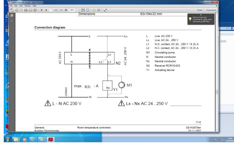

This sounds like a simple miswiring issue.
The thermostat's contacts should be wired IN SERIES with the live wire to the pump, so that it switches the pump off when the house gets up to temperature. The part of the timeswitch that controls the pump should be IN SERIES too. In other words:
Live mains from fuse -> timer -> stat -> pump -> neutral mains
OR
Live mains from fuse -> stat -> timer -> pump -> neutral mains
From what you say, the stat contacts and the timer contacts are incorrectly wired in parallel with each other, so that when the timer comes on, the stat can't switch off the pump and so has no control over anything. If that's the case, you should also be able to switch the heating on using the thermostat even though the timeswitch is set to off! :LOL:
Your stat sounds like it has "changeover" contacts (as well as Live and Neutral supply). So you only need to use two of the contacts, COM and probably ON. If it behaves the wrong way round (i.e. heating goes off when house gets cold and vice versa), use COM and OFF instead.
C.

below are the two wiring diagrams
THIS IS TIMER CONTROL
THIS IS WIRLESS STAT
On the stat using connections L1 and LX and on the timer i think it was 1 and 3
