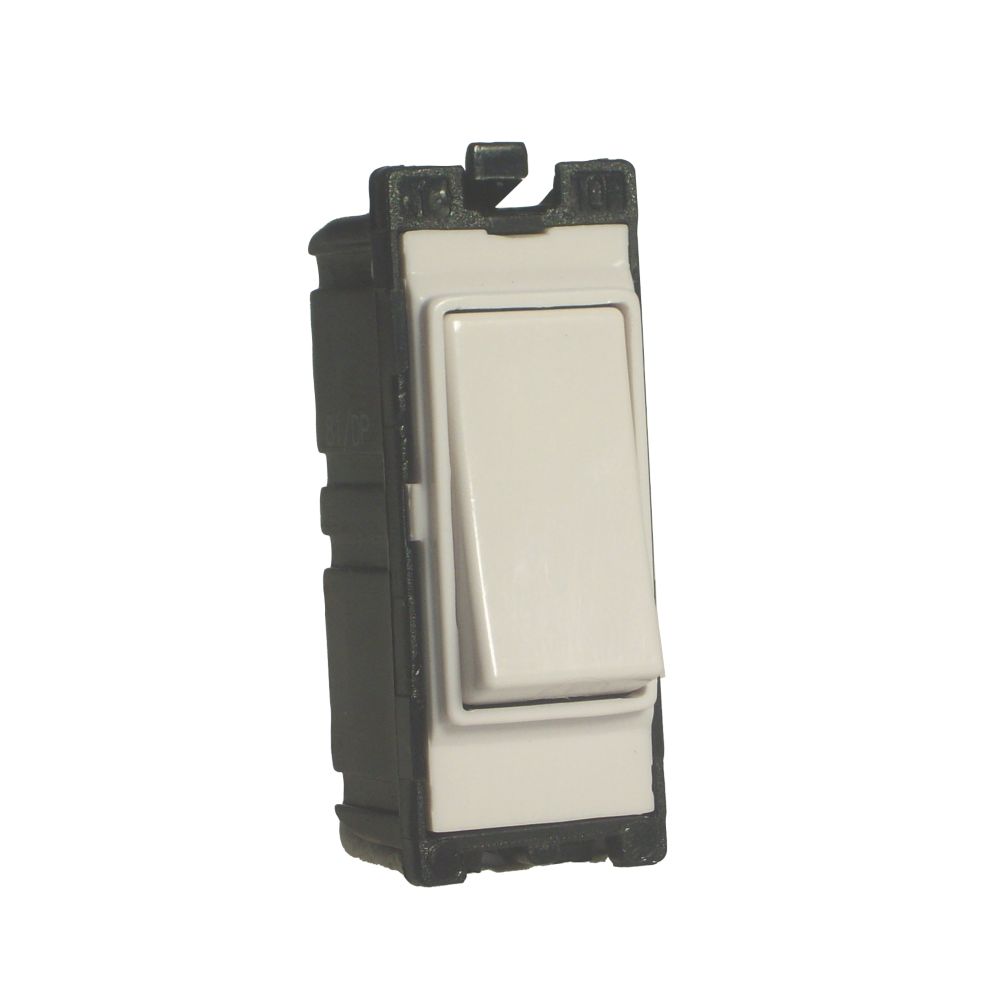

Prior to tiling! I'm currently chiselling space for a couple of 20a switches.
I'm unsure which switches to go for, seems a lot of space for 2 switches so....
Can i use these grid switch type instead in one box?
seems obvious but first time in 20 years DIYing i've had to do this :)
ae235
Also, the switches will feed a socket for the appliance
as each switch feeds one socket, can I get a double socket that can be switched by each of the grid switches in stead of 2 individual sockets?
Yes.
Also, the switches will feed a socket for the appliance as each switch feeds one socket, can I get a double socket that can be switched by each of the grid switches in stead of 2 individual sockets?
Not that I am aware of, but you can get 'dual' (as distinct from 'double') back boxes which would allow you to install two single sockets side-by-side.

I'd go for a dual box and 2 single unswitched sockets. The Euro socket modules I've come across always seem to be of poor quality.
cheers, dual box it is

I'm branching off a double socket to the grid switches
Can I use 2.5mm 2 core earth and single live from the double socket, sharing the neutral / earth or must I use 2.5mm twin / earth for both switches?

For two single sockets -
it depends how you read the regulations - others may disagree.
One 2.5mm² T&E from socket to first switch and then on to second - sharing all three - would electrically be sound.
If you had more than two sockets then you should use 4mm².

That poses all sorts of questions, particularly relating to the nature of the circuit that you are 'branching off'. If it is a ring circuit, protected by a 32A breaker or 30A fuse, then you would certainly have to have separate cables, and if the 'source socket' was itself a branch ('spur') off the ring circuit (rather than being part of the ring), then you could not do what you are proposing at all. If the circuit is protected by a 20A MCB/fuse, then things would be different, and you probably could take a single cable from the source to your two new switches (and sockets).

The double socket has 2 - 2.5mm going to it
After thinking (and chiseling) im going to continue with two lots of 2.5 twin
Is that correct?
Do I need to take one off the double and circle it (another not clear question)?
