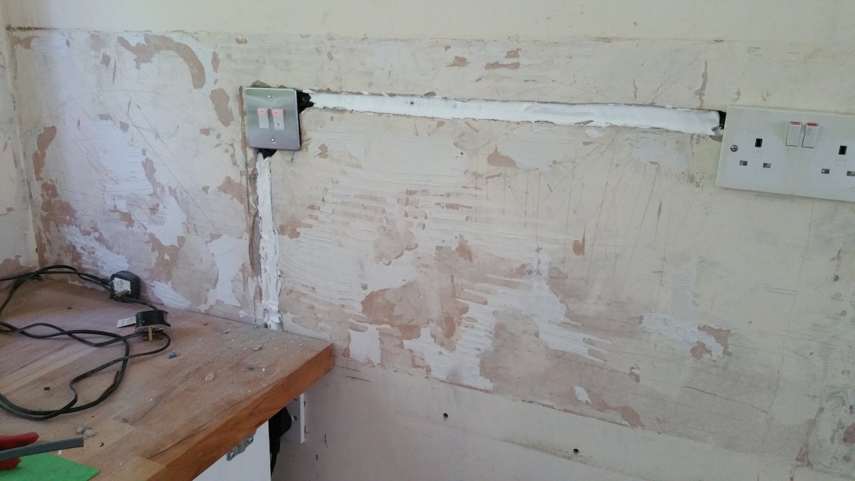

Fitting 2 20 amp appliance switches help wanted
Do I need to take one of the twin core off the double socket and come back from the next socket (after the switches)?
I wanted to re do the wiring with some 10mm I bought a while ago but the electrician said itll be ok to use existing 6mm, I was concerned at first due to the 3-4k electric hob and 3k oven but who am i to argue.
It's fine. You can have up to 15kW on a usual cooker circuit - 30/32A 6mm².
No. The switch wouldn't work then, would it?

Whatever, you are probably strictly correct that one cannot 'violate' guidelines, but, again, you know exactly what I mean!! As I said, most people seem to feel unhappy to 'go against' (i.e. ignore) the guidance that one should not feed two single sockets off an unfused spur from a ring final.

I would spur off in 4mm and use 2.5mm from the switches to the individual sockets.
It is safe, though.
It is safe, though.
Yes - well, at least, no less 'safe' than having two or more spurs originating at very close points on a ring final - something that even the guidance of App 15 does not advise against.

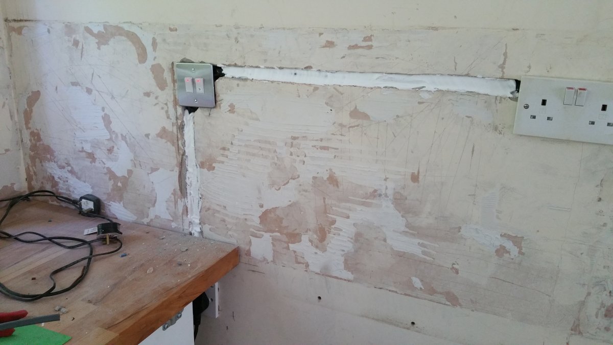

Not bad for first time.
Can't believe how much mess I made!
