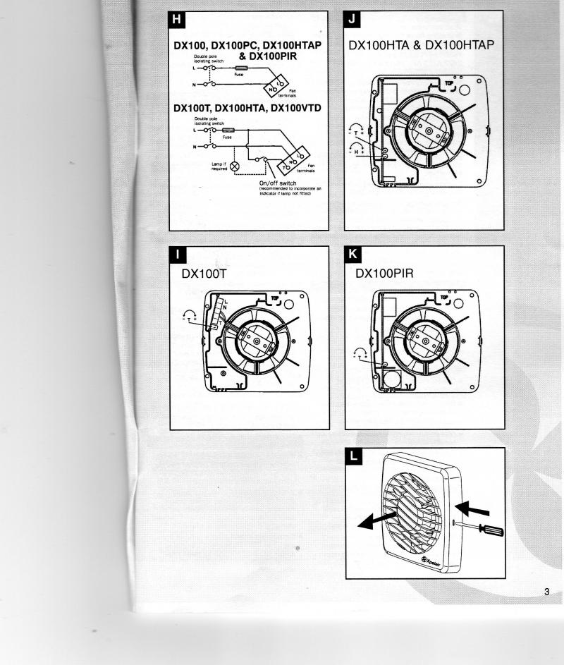

I've purchased a bathroom extractor fan. Its a humidistat model, and I've attached an image of manufacturer's wiring guidance: top left picture, bottom diagram (model DX100HTA).
I can see that the live and neutral will be connected via a double pole isolation switch to the fan itself, but my question relates to connection T.
In layman's terms, how would that on/ off switch be wired?
I do intend of course to have a spark check the wiring before I use the fan.

It would be wired as shown in the top left picture, bottom diagram.
Why do you think it would be done differently?
The question is how do you intend to control the fan? The diagram shows simple on/off switch but often we want to use the light switch to control. When using the light switch then we normally use a triple pole isolator after the light switch rather than a double pole before the light switch.

Oh red wire would be T connection.
Reading the full instructions it would seem the switch connected to T is an over ride and the fan would work without this connection once the humidity reached the set amount.
Since there is an over run built in a self return switch may be good enough to start the fan off then it will stop when either timed out or dry enough.
Even on a humidistat model its useful to connect the T terminal up, for getting rid of smells and early stages of a shower, and some manual control

The diagram above shows the cable splitting from the live feed to the fan and routing via a switch to the T connection on the fan itself. Does this mean that the switch would have a live feed only?
All the switches I've ever come across in the past had, at the very least, a neutral and live. Fairly confused about that bit, to be honest.
