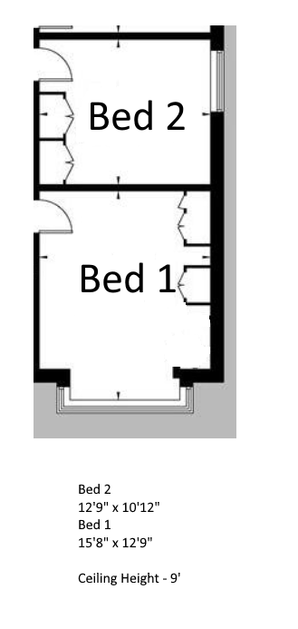

I am trying to fit an ensuite for Bedroom 1 utilising space from both rooms. I am trying to work out the best layout where it doesn't look like a box in the room and can integrate with the storage of both rooms to be as efficient as possible.
Any ideas :) Thanks in advance.

Where is the SVP in all of this?
Far better fitting it along the top of bed 1, especially if the separating wall is masonry. Hang the door the other way. Need about 0.9 x 2.4 for an ensuite shower.
