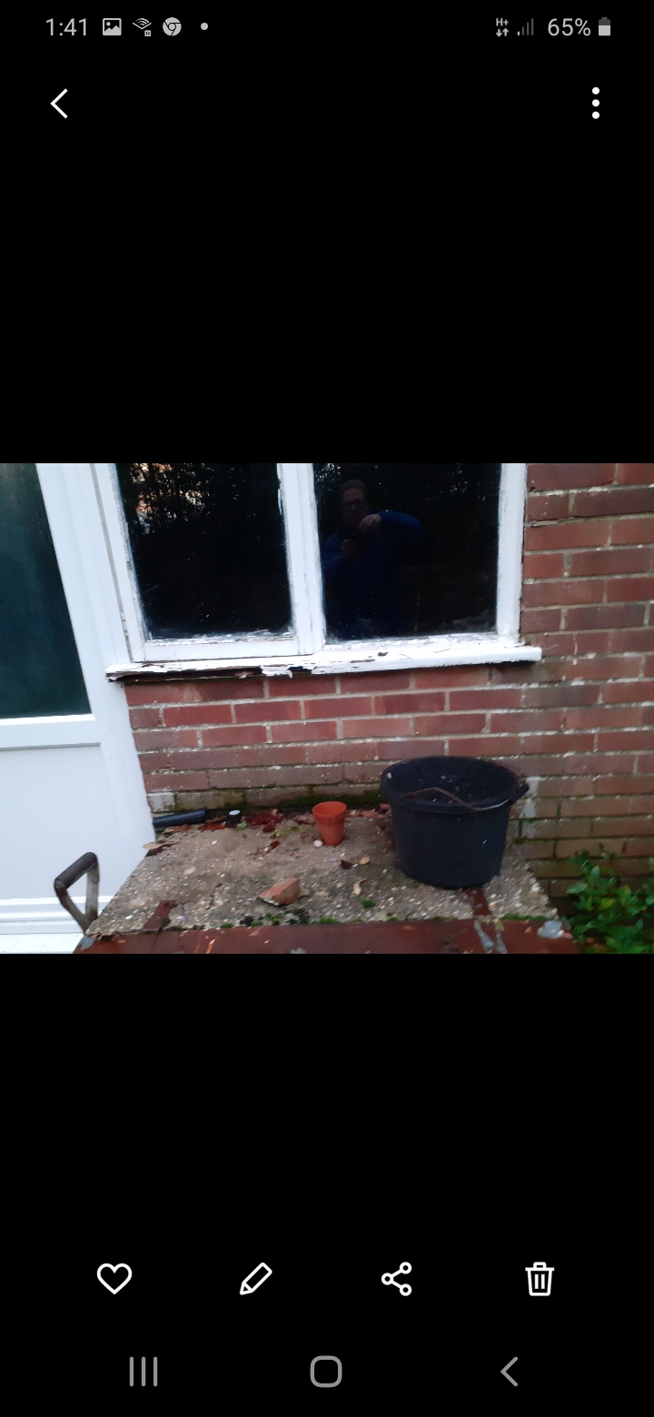

Wondering whether to just change the rotten wooden sill or instead lintel above for a longer one to put above a new window. If it's just the sill and not lintel,how do I get old sill out? Rotten as hell. Wall's single skin
There's an old window (less rotten and next to this one) coming out soon (same dimensions), so could be used for parts.

It wants a new window, it needs the bricks above proping up with 2 acrows with strong boys, new full length concrete lintel fitted
Unsupported brickwork above the window.
Risk of it cracking or falling if not done carefully and properly supported.

So you're saying the small lintel above door needs taking out and replaced with one long one above both door and window three acros with strong boys put into grout above small lintel and one layer of bricks above window. Cut out grout with sds drill with brick removing chisel bit or if possible multi tool (safer and single skin wall) then remove bricks After that remove old window and small lintel somehow for new one?
Sorry, but I think this is one of those jobs where you need to admit to yourself that you really don't have the relevant experience to tackle it on your own. Had you got the experience you would have recognised from the off that the existing lintel is inadequate and that a full length lintel over both the door and the window in a single piece is a must, and also that because the window frame is now supporting the masonry (and presumably part of the roof load above) propping and a degree of caution will be required, as stated above. It's sometimes good to admit defeat, you know

Sure, out of interest is it worth just replacing the rotten sill ? If so what's the best way to remove it ? I was thinking of putting in the one from the window next to it. They're dentical windows and (being taken out). Or a new one.
I did it before( put in a new wooden sill using expanding foam underneath and silicone. Seemed fine but a lot of faff. But previously I didn't need to try and remove it as it had just fallen out!
...out of interest is it worth just replacing the rotten sill ? If so what's the best way to remove it ? I was thinking of putting in the one from the window next to it. They're identical windows and (being taken out). Or a new one.
Here's the rub - there appears to be no lintel above the window, but there are bricks and there is a roof which means that rotten or not that window and quite probably the sill beneath it, are load bearing. So, if you cut away the sill, depending on how the window has been fixed in place and how many fixings there are, there may well be no support for the window. You just can't tell. In view of the fact that the window has been ""cowboyed"-in, I wouldn't want to put any faith in how well it has been fixed. If it isn't adequately fixed you could find yourself, having removed the sill, with broken glass, cracked brickwork and possibly a window frame/glass/bricks/concrete lintel/roofing* in your lap (or on your head) should the window frame move. On the other hand you might get away with it, so in the words of Dirty Harry, "... ask yourself, punk, are you feeling lucky?"
Personally, I wouldn't risk it - and that's advice from someone who regularly props roofs, beams, floors and joists in old buildings much bigger and heavier than this. You either need to do the job correctly, or not at all. The idea is that you go home safely every night and in one piece.
