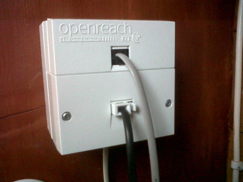

Looking on the sites you gave me i cant seem to find the socket that BT installed on the end of the extension as i have BT infinity.
im not sure weather its just a pre-filtered socket they put on inplace of the old standard socket which didnt have a removeable face plate, it looks like a standard NTE5 with a pre-filtered part on top of it,
ive attached a Pic so you know what im talking about lol
[/img]
If you look at the bottom of the socket you will see were the extension cable enters which runs from the junction box on my 1st pic
That is the vDSL faceplate, early versions had no provision for a DSL extension so you could only plug the router into the front socket. The design is nearly identical to the iPlate for tooling/cost reasons!
