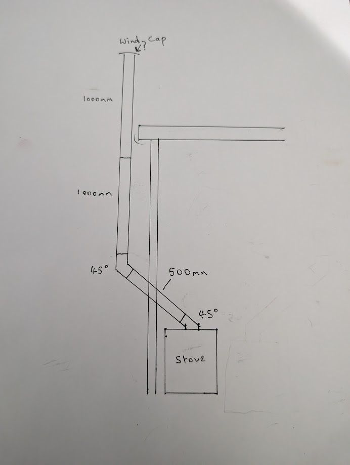

Hello,
My son bought a stove for our workshop but it's just a stove with no pipe or anything else, looking for advice on the fitting side of things please.
I have worked out pretty much almost all of what I need in terms of pipe but need to know if I need joining bands or cement, dampers or cleaning access holes etc.
Also do we have to have twin wall or can we just use normal 5" vitreous pipe?
Just for starters....the stove needs to be on a concrete (or similar ) hearth. Sizes are specific to avoid injury or tripping.
I use twin wall stainless, that locks together with a bayonet type system (only turns a few degrees) and no other jointing was required.
A soot chamber is available for your external 45 degree bend and is a good idea.
Go for a stove that draws it's combustion air from outside if possible - or you'll need other ventilation for it.
Support the twin wall as sturdily as possible from as high as practical.
There may be regulations on the type of timber and minerals you can burn......dried hardwood and ovoid coals are the way to go.
I'll not say any more, I presume full regs are available from HETAS or whatever on line, but I'll wish you well with your project!
John :)

The workshop is actually our old garage and it has a concrete floor, I'll probably put the stove on a concrete flag 600mm x 600mm
Twinwall it is then, wow the components are pricey aren't they!
He got the stove off Facebook so no idea if it draws it's combustion air from outside, the workshop is not airtight by any means but I can fit a wall vent if required?
I'll fit the highest bracket through the fascia into the joist.
We will only be burning wood.
Where the pipe goes through the wall do I need to use fire cement to make good or can I just use regular mortar as it's insulated pipe?
In a normal dwelling, a 5kW stove does not need further ventilation....however, if there is any doubt a spill test can be done, which is essentially to find out how effective the flue is. Most people just leave the communicating doors open and natural draught is meant to take care of the combustion air.
Over 5kW then a wall vent is needed - which somewhat defeats the object of heating in the first place!
A stove which gets it's combustion air from the outside has an air inlet pipe at the bottom or side.....this is obvious to see.
Standard mortar is fine for pointing up masonry gaps when using twin wall - a hell of a price, I'll admit!

It won't be getting signed off as it's only in the workshop
We will be burning mainly pallet wood as it's free and readily available.
I just need to source the flue parts now then.
Do all twin wall components require a locking band for connection or do some need cement or other type of bonding?
I get all of my stuff - including brushes - from fluesystems.co.uk.
Competitive pricing, good delivery and advice if you need it.
The twin wall I used had bands over the joint but no sealant required.
John :)
