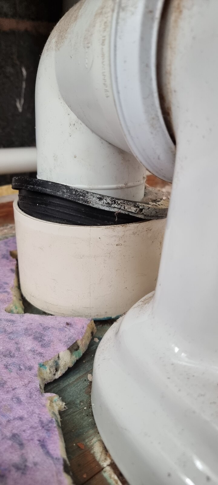

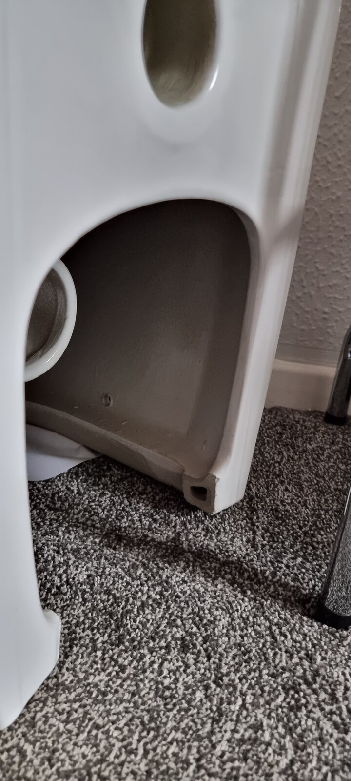

I am currently doing up our bathroom and the new toilet is to be up against a vanity unit. The current toilet waste goes into the floor. Luckily there is plenty of room for the waste and the cabinet. I'm just unsure what waste pipe to get. I'm thinking I need a flexi pipe for ease. Would it just go into the floor mount or do I need something different?

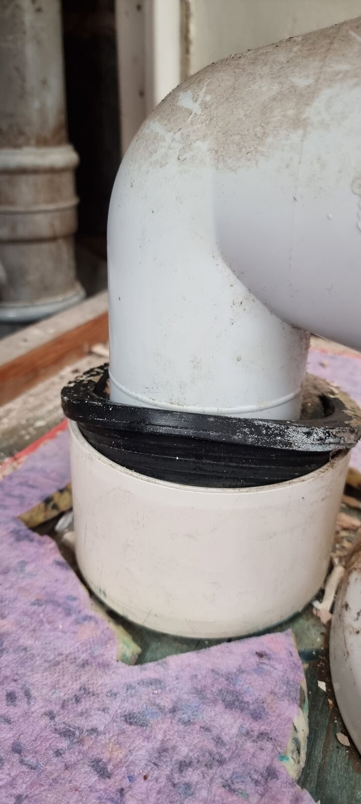

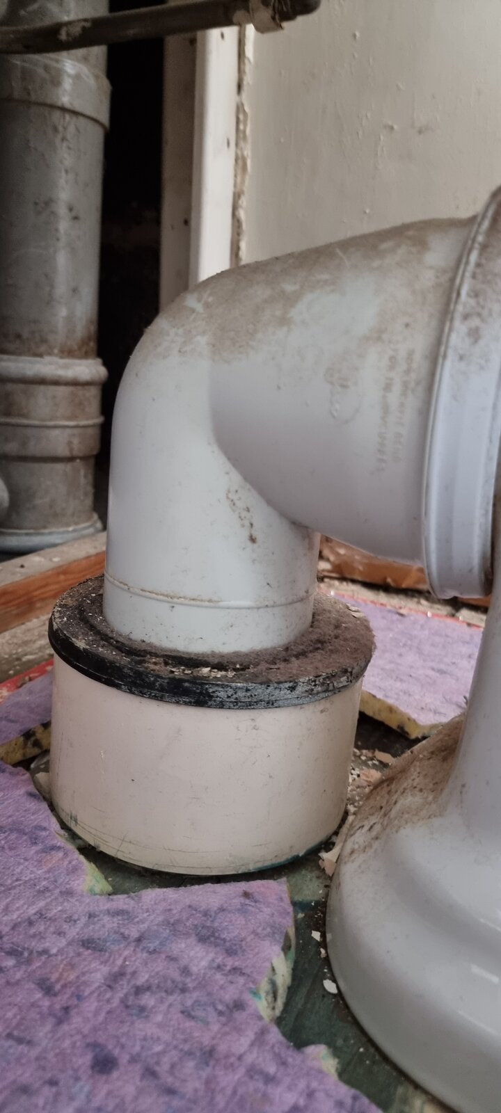

Thank you. The pipe sticking out the floor has a rubber seal on the outside rim whereas the flexi pipe seems to just push inside. Does the flexi still push in the same way with this pipe? Do I keave that rubber lip on?

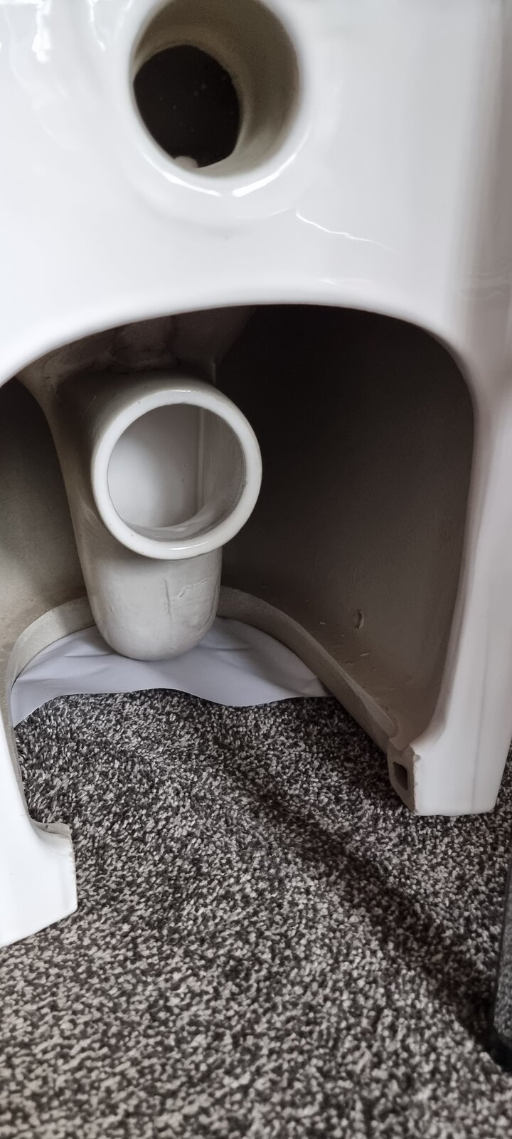

pic one is the cabinet for the toilet, is that in location? Where's the soil outflow that's in pic 2?
Remove the current pan connector, does that black rubber seal and adapter lift off, if so what's below?

The soil outflow sits inside the toilet by a few centimetres so the toilet will fit flush against the unit (front panel still to go on). I may have to slightly adjust the bottom of the unit to fit around the pipe coming up from floor.

Ok. It is indeed an inner sleeve so it looks like I can just use the old sleeve and push the new waste in or hopefully I can get a new sleeve and use afresh.
