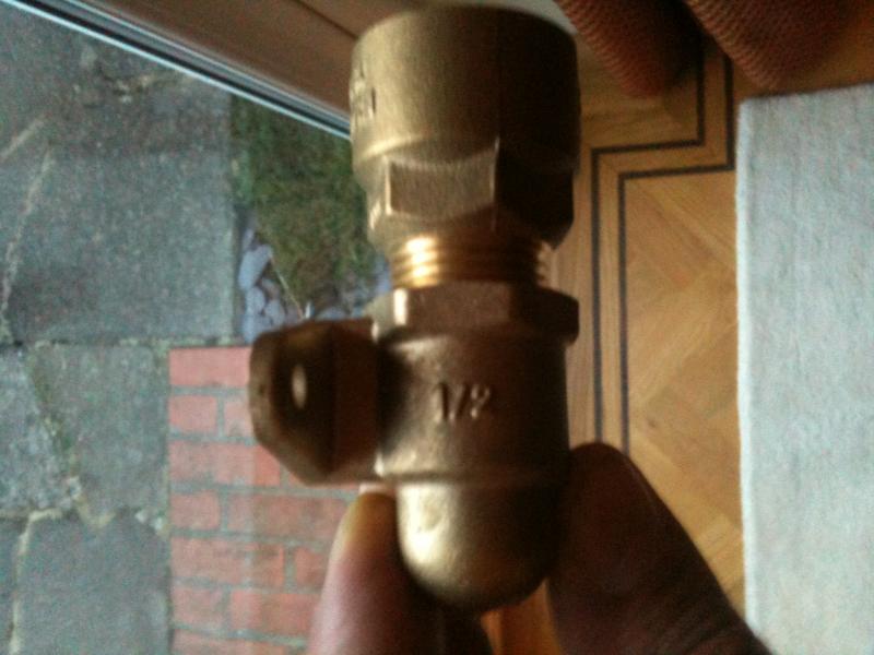

hi i have been out to fit a hob and double oven for kitchen fitter mate, only problem is with oven shoved in it touches my pipe that i installed for hob and not a prayer for the wall plate elbow and beyonet fitting and hose the oven from front to back is 555mm.
what do you guys do in this situation?
other than bust 2" out of wall
any tips welcome

And there was me about to suggest that you re-pipe the hob from an adjacent cupboard, so that the Isolation Valve might just be accessible......

Now, I do know that this is NOT the CC, but my last conversation with my Local GSR Inspector included his 'recommendation' that a M/F coupling with a test nipple attached be fitted at the inlet point to cooker/hobs - Am I the only bloke not fitting them?

You can buy Gas Appoved Iso Valves with a test nipple incorporated (or was that what you meant :oops: ). BES sell them. MAIN used to supply them with their multipoints, but its been so long since I fitted one that I dont know if they still do nowadays.
