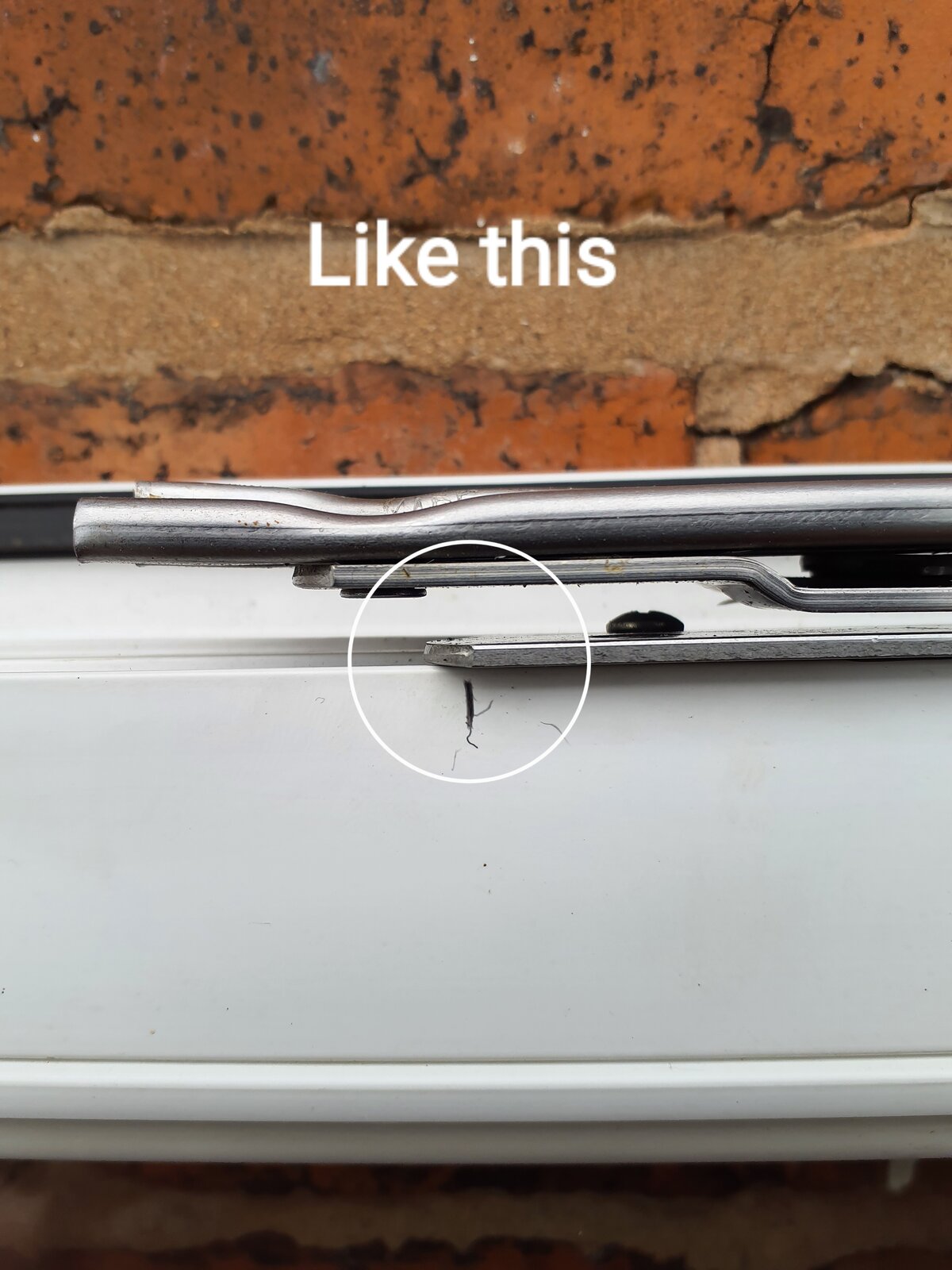

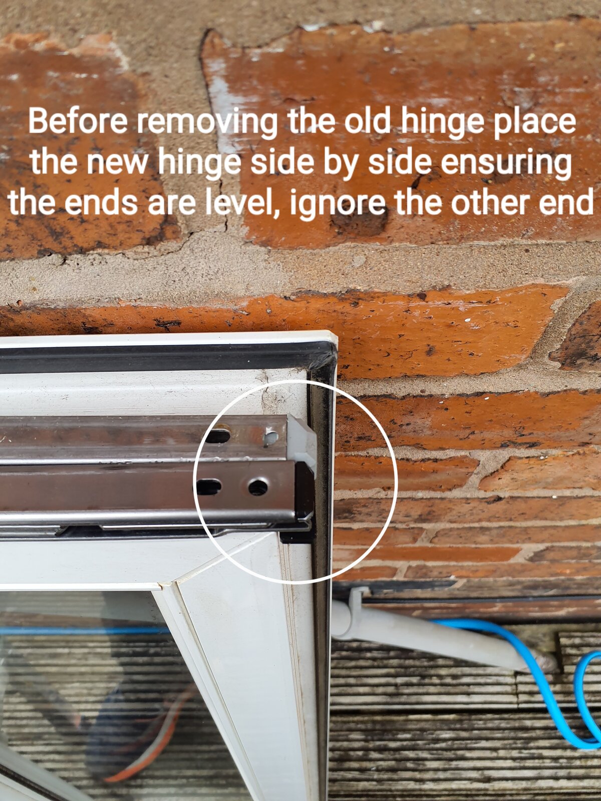

Fitting new hinges to a uPVC window - step by step.
1 Dec 2009
6,430
1,603
East Mids
I've been threatening to do this for a while but most days don't get 5mins to take photos, anyway hope this helps some who decide to have a go themselves or for those that jumped in feet first without thinking it through and are now in a muddle and the window won't close.

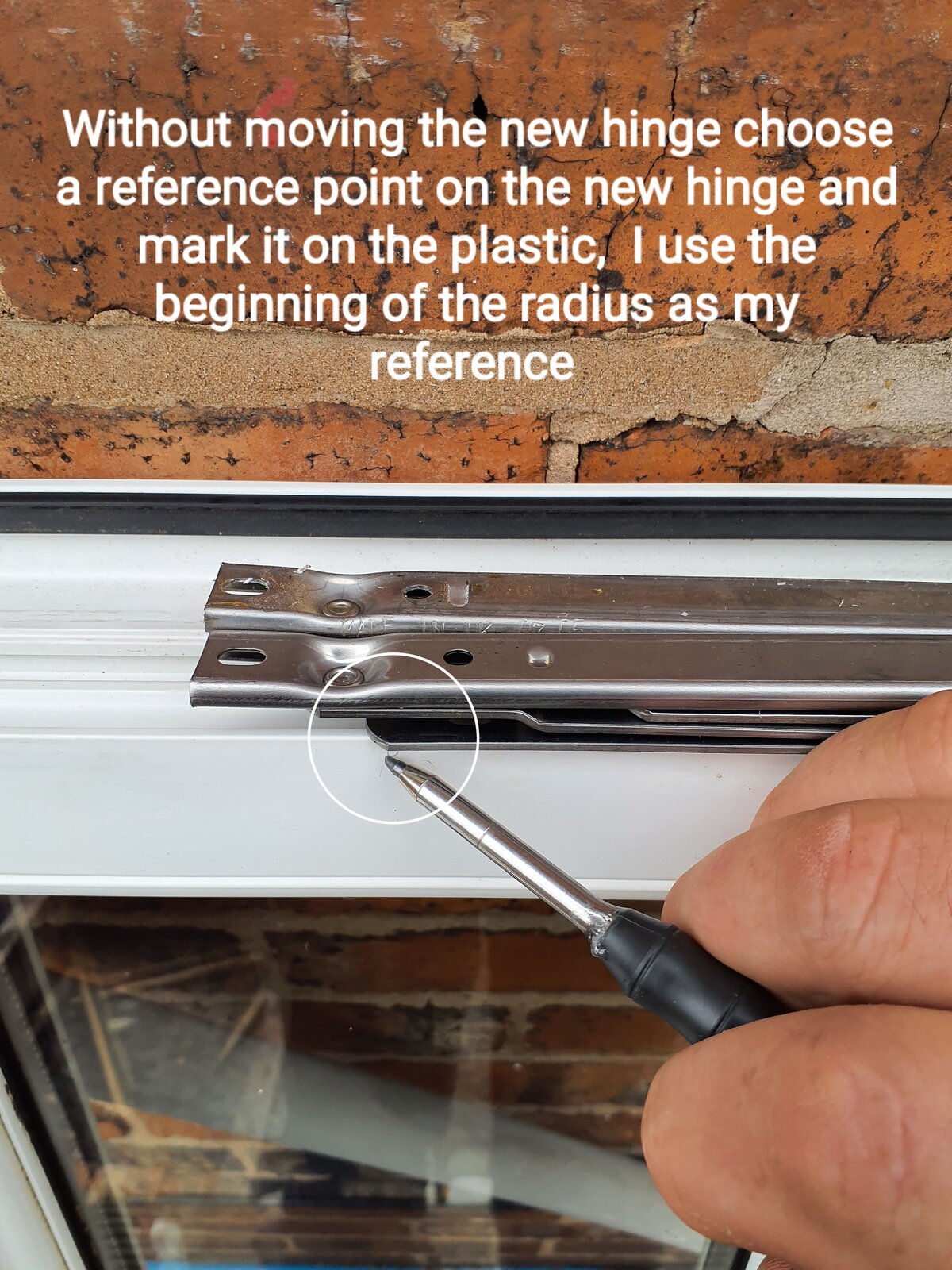

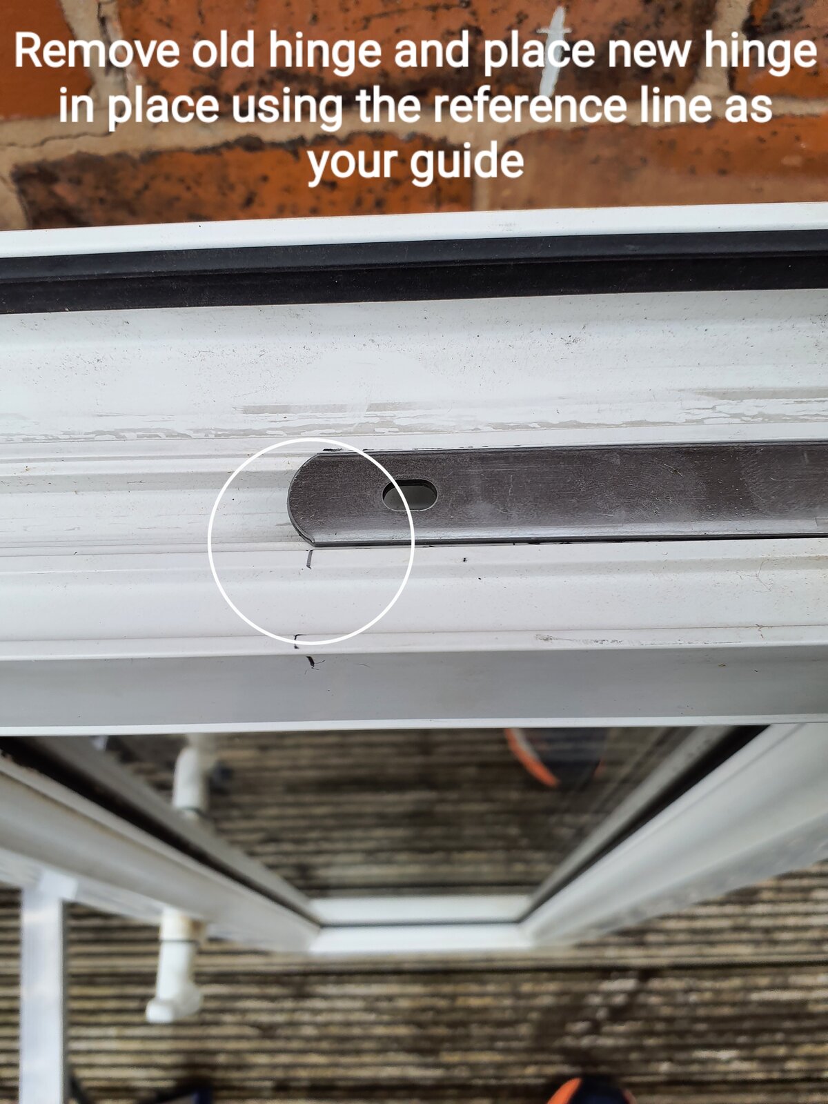

With mine when I changed the hinges, I had the additional issue of getting the window sides to frame (120cm) even on both sides for a good seal. On the worst, the difference was 6mm so basically it was 6/2 = 3mm horizontal adjustment to get the frame even.

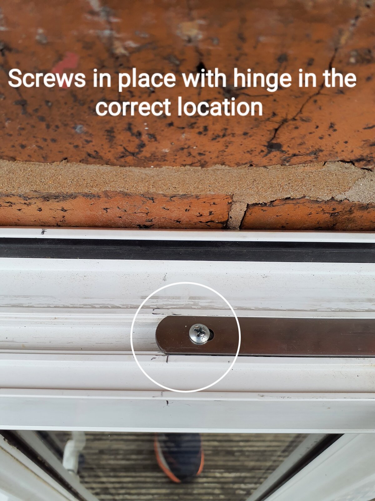

All I would add to the above is use stainless steel screws and not plated. Nowt worse that a rusting screw to spoil the look of a stainless hinge system.

Obtained stainless MILA hinges from Screwfix and replacement (slightly larger diameter than the original) stainless panheads from the bay.
Essentials for me was a pair of suction grip handles (£9 apx) to make handling the window units safer, and someone to pass me the screws during the initial securing of the top hinge - stainless screws do not stick to magnetic screwdrivers so needed to insert the screw by hand before I could use the screwdriver.

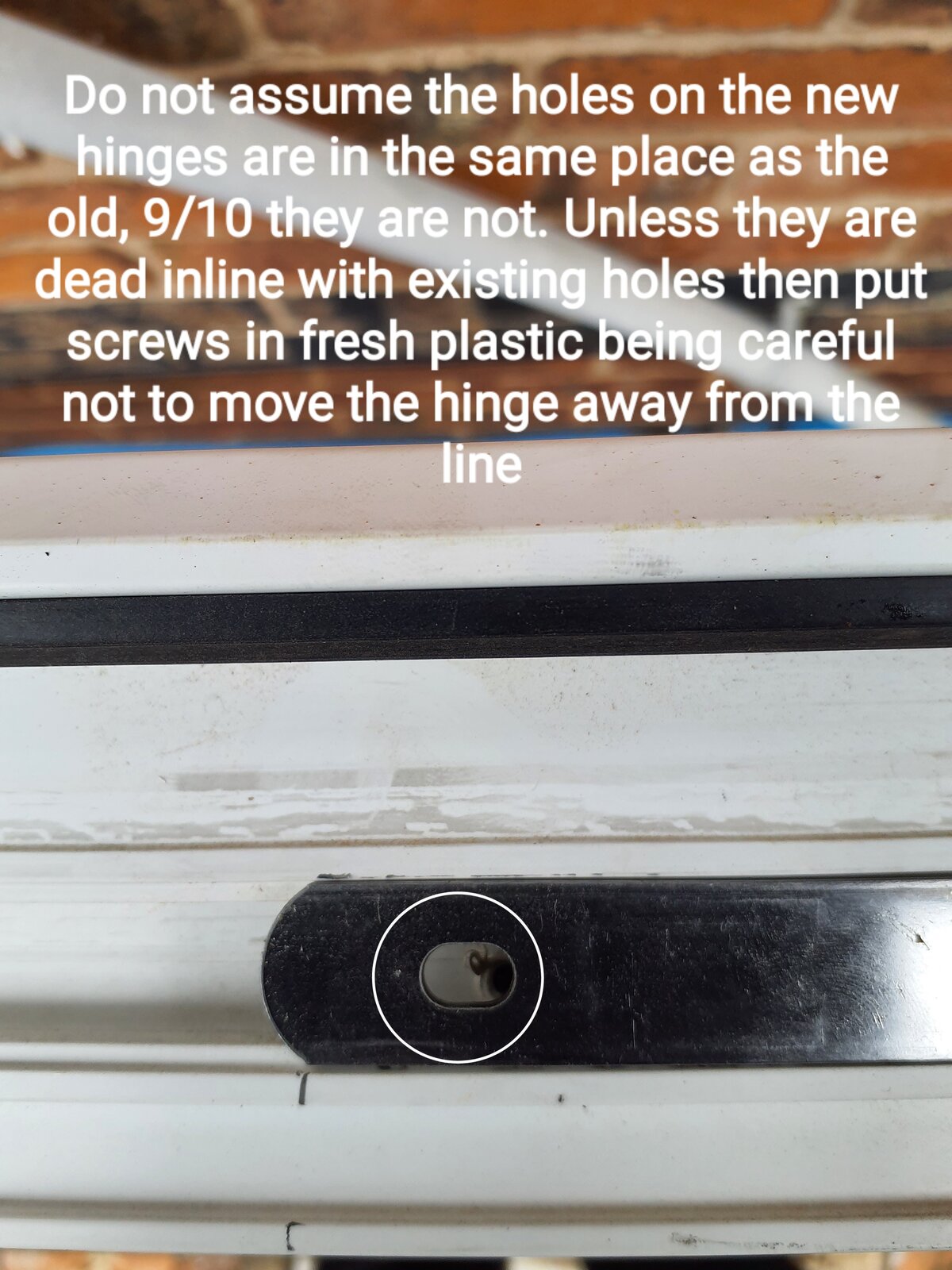

Some screw holes of the old hinges did not match the MILA replacements, solved by drilling new holes, clearance size in the hinge, smaller (apx 1/2 clearance) in the frame.

Measure the old hinges twice before buying the replacements.
Expect the old screws to be of different lengths and drive bits.
