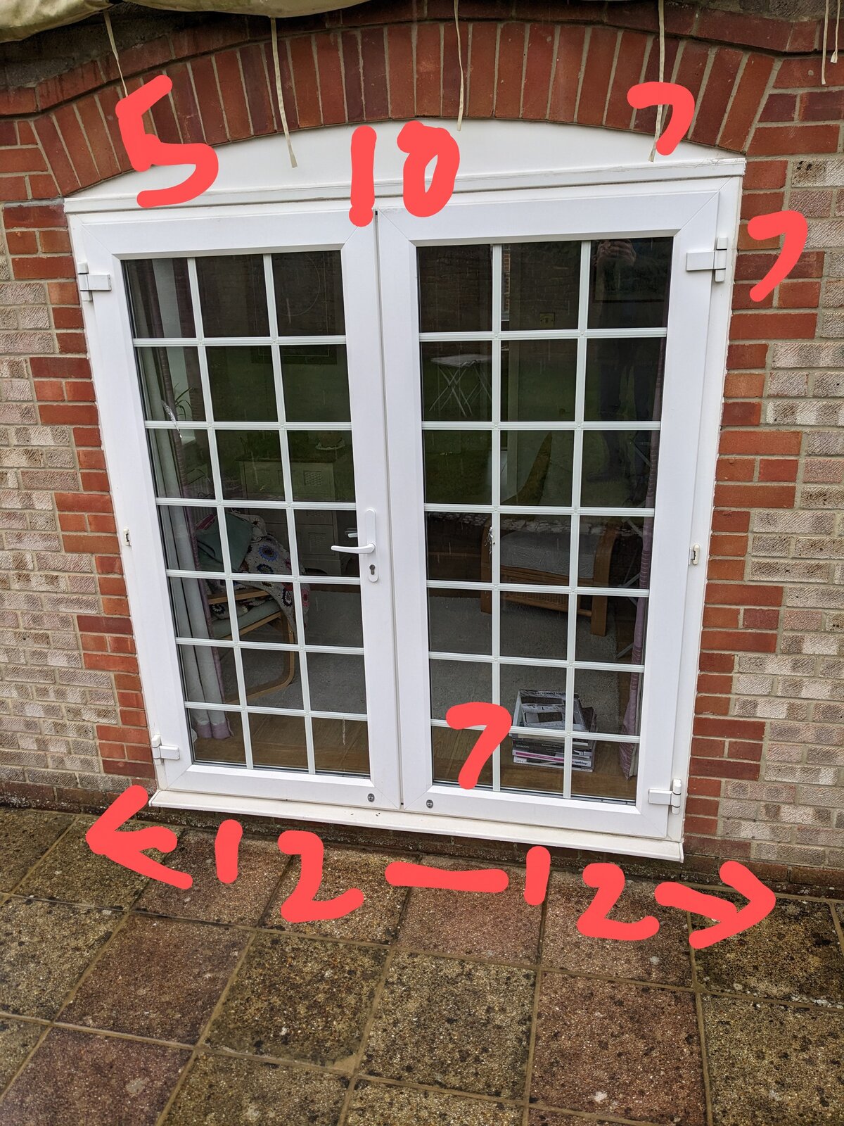

The hinges need replacing as the top ones are worn. I've got 3 to fit each side to take the weight better.
Most of the sash covers are at 8mm +/-2mm. The photo shows the measurements at the extreme ends of the range. Both doors are 12mm all along the bottom and 10 at the top in the centre.
My plan is to fit the hinges without removing the doors. I will fit a midway hinge first to keep it in position.
I want to get the tops of the doors level (and keep the sash cover in range). Should I check the toe and heel first, or try to move the door in the frame ?
Should I work on the right side door first?

Have you got the same hinges as existing? If so I'd replace the hinges , then check toe and heel
No, those are no longer available (Anglian doors). I bought a replacement set from UPVC Spares4Repairs.
I'd rather do the hinges first if possible, but I don't want to remove one and the door move. The glazing unit must weigh a bit and I'd rather not have to take it out if it can be avoided.
You may find that the door will need to be removed as the hinges will probably not sit in the same place and you could potentially end up with a lot of ' binding' , I would gey that broken centre one first to see . The other problem is the weight of the glass will cause the door to move as soon as you remove either the top or bottom hinge
The thing in the centre is not a hinge, just a guide. I was thinking if I replaced that with a hinge first it would keep the door in position, and hopefully prevent it moving out of position if I replace the others one at a time.
Somebody with Anglian French doors commented on the hinge suppliers YouTube for fitting these that they had replaced theirs with the doors in place, and had no problem afterwards. So it must be possible.
I'm not saying it's not possible , just be prepared for issues

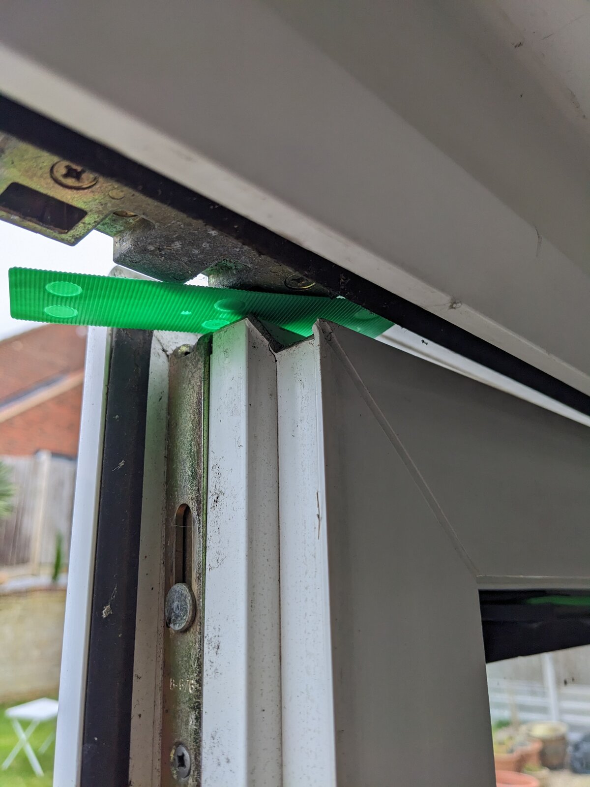

I can only get a 1mm packer to fit between the door and the plate the lock rod goes into, so in the centre of the frame tolerances are tight. It's the same top and bottom.
