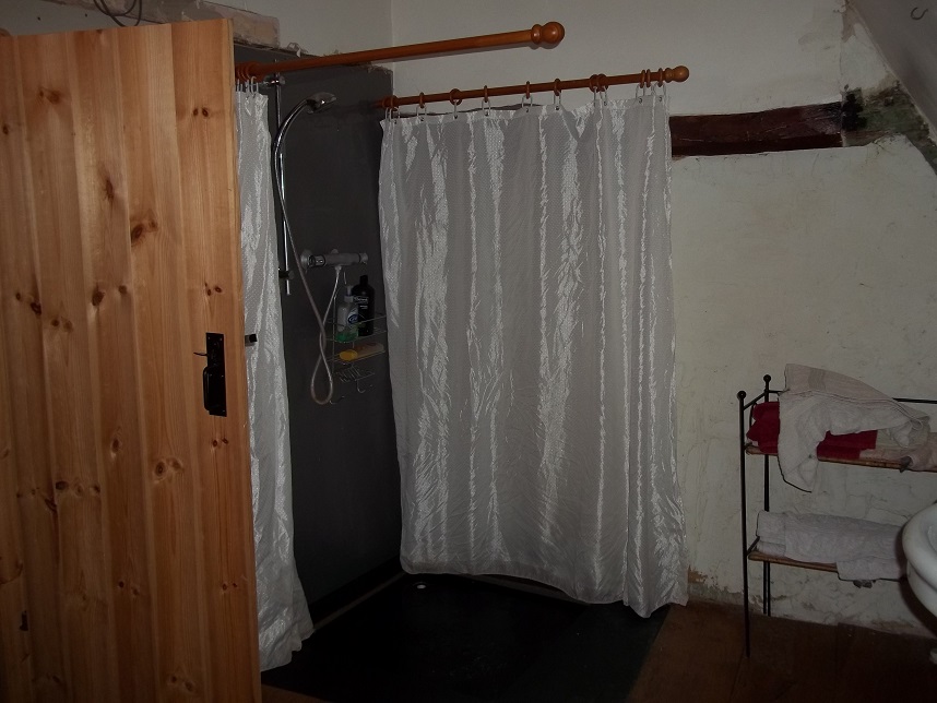

I use a polyester shower curtain ( John Lewis ) to keep shower water away from the wattle and daub wall of my bath room. It would also work over a window,
