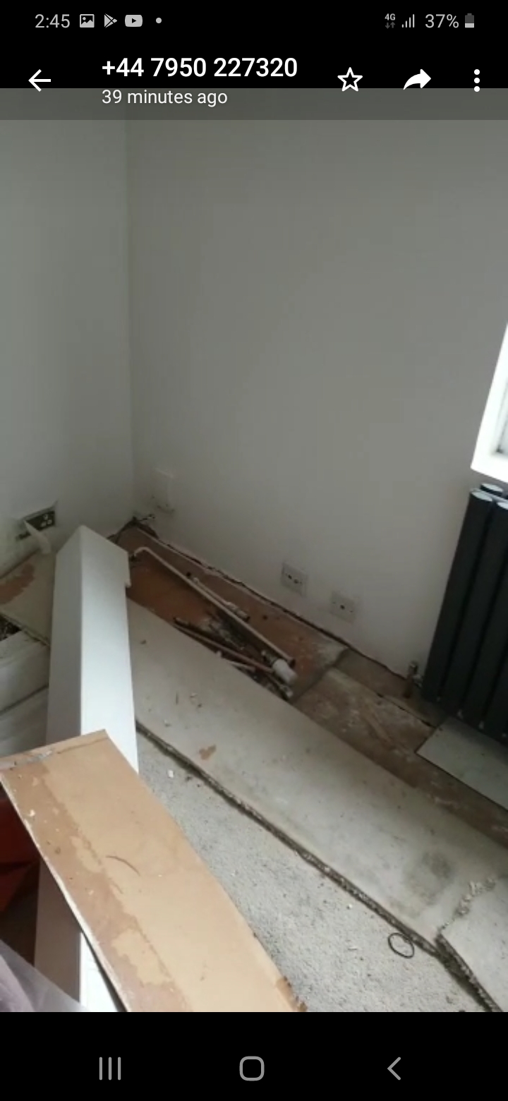

Got some architrave and skirting to fit. Was gonna buy a dewalt 2nd fix nail gun (as I have dewalt batteries and read good reviews on it) and pin and glue skirting (gripfil for adhesive). Put nails in at slight angle.
Is it the same for architrave? If the jobs aren't spot on what filler toupret wood filler or caulk?

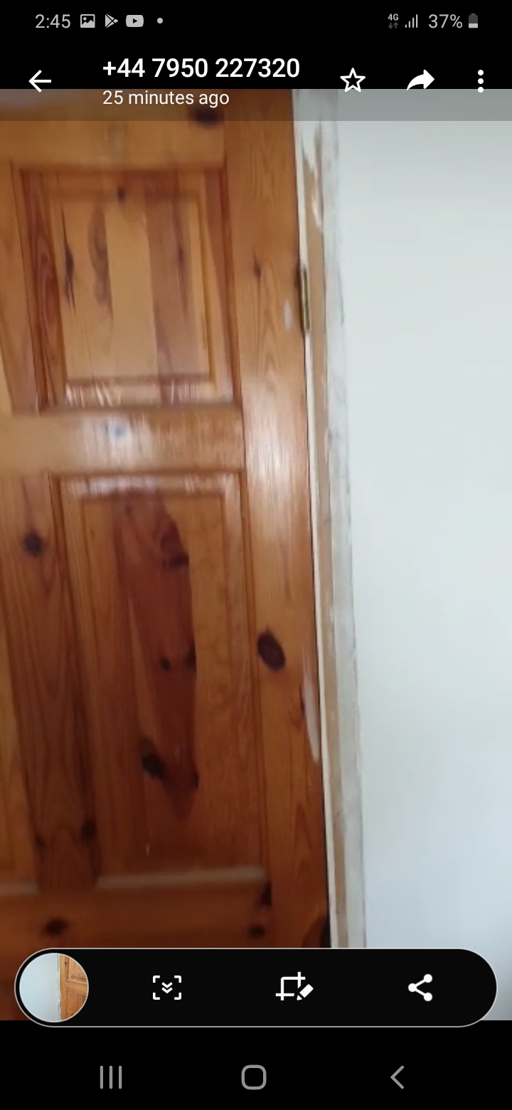

When you say put architrave next to skirting are you referring to the thickness so that one doesn't stand proud of the other when butted up? Not sure
The architraves pretty much always stand proud or are flush with the skirtings. If not then you either have to pack out the architraves so they sit proud, or you need to terminate both the skirting and the architrave in a plinth block, although TBH I always think they look pretentious in a modern house (in a tall ceilinged Victorian or Edwardian home with high skirtings, however, it is somewhat different)

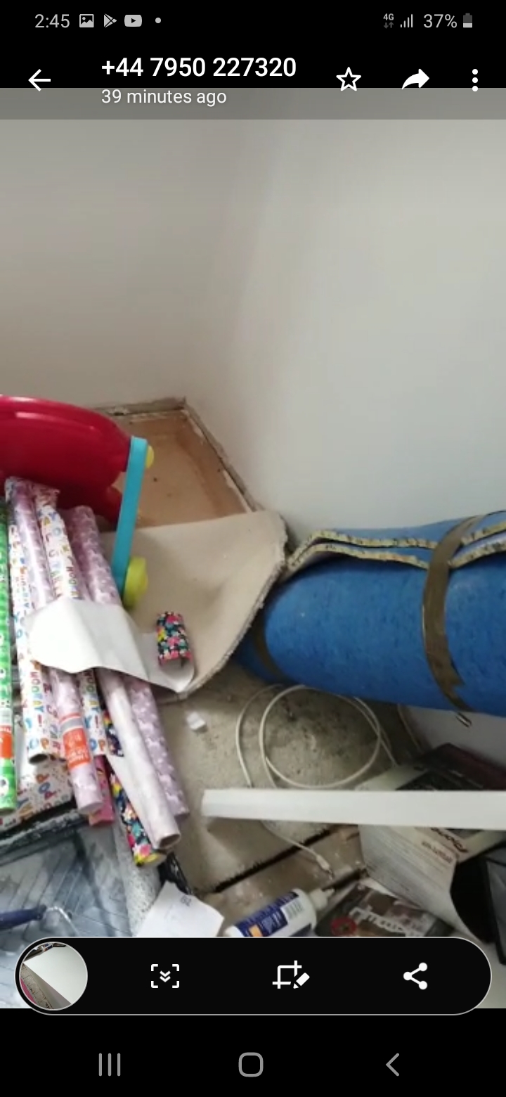

Looks like newly plastered plasterboard behind skirting I guess. I'll pass on 2nd fix nail gun. A lot of money for something just used on skirting and arcs. Use my hammer. 1st fix will be a better investment. I'll bring gripfill and try and get some of that foam stuff. Idiot proof sounds good
Why do you need GripFill when you have foam? Use one or the other. Used the foam recently on some MF framed walls which were shocking - moved if you touched them, so grip adhesives were out of the question. The foam worked a treat, though

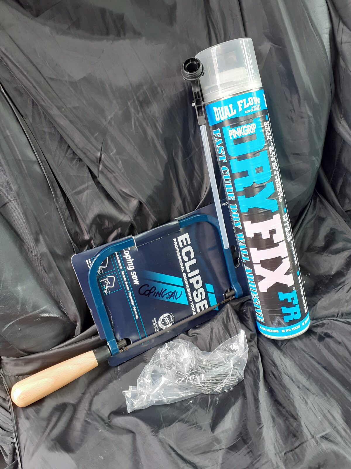

Ready to go for arcs and skirting. Apparently you leave foam on for 5 mins before pushing onto wall.
FFS is that a blade protector on the coping saw blade? It shows how long it is since I bought a new coping saw, health and safety gone mad (again).
You may find the "wait 5 minutes" a bit long if only using small amounts on smaller sections. OK if using a large amount on e.g. a full sheet of plasterboard as it helps to stop the foam expanding even more and pushing the board outwards, but I think you'll find it skins off too quick in small amounts to get a good stick.
Also, I do suggest you get a foam gun - that pinkgrip dual flow will work with one. You get MUCH better control for a small bead of foam - I tend to use mine almost shut down to nothing - the basic nozzle is difficult to control - welcome to the black finger tribe :LOL::LOL: - you'll find out after you've done a bit.
AFAIK that dry foam comes in a can which has a clip to hold the nozzle when not in use - using that clip puts a kink in the flexible nozzle, effectively sealing it (and preventing air from getting at it, causing it to cure). Not seen gun grade low expansion foam in quite a while - standard expanding foam and the newer blue fire foam, yes, but not the low expansion stuff
But is it? I used to remove the blade from my coping saw when packing it away to stem its' tendency to get hungry and chew on the nearest available wooden tool handle or plastic tool whilst left alone in the back of the van on the way home.
