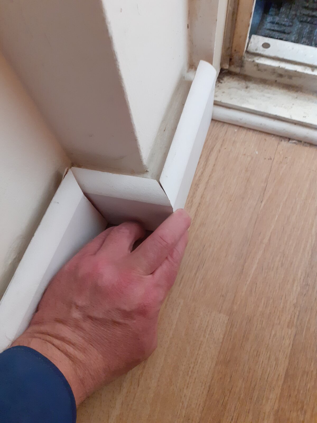

This foam stuff seems more annoying than anything. I'll stick with gripfil and pins until confident with it . Regarding internal corners which section do you scribe short or long?

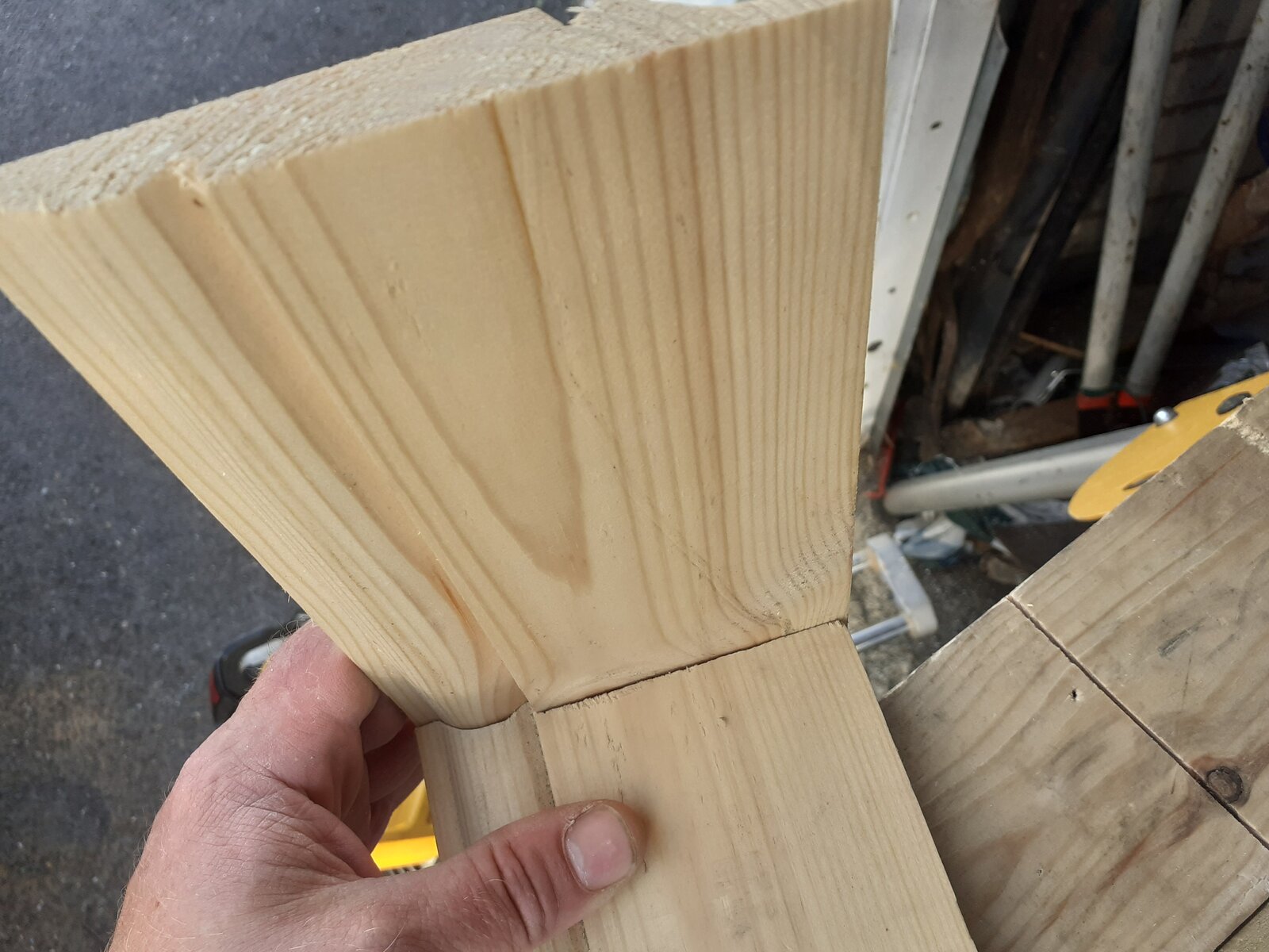

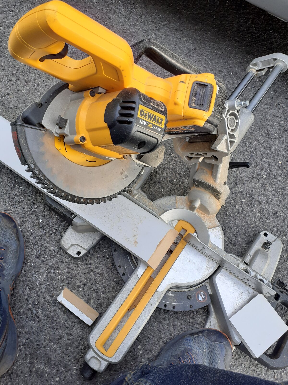

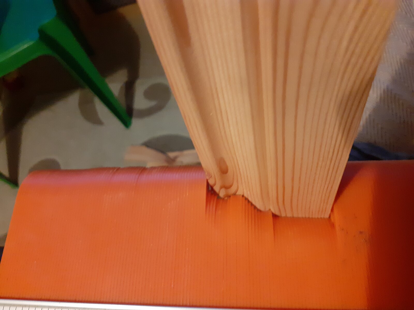

Regarding cutting it. Do you do 45 degree cut on chop saw then put a piece of off cut on it at 90 degrees and pencil in the shape ( as in pix)? I found this tricky as both bits of wood not touching. How about using a pin machine for shape?

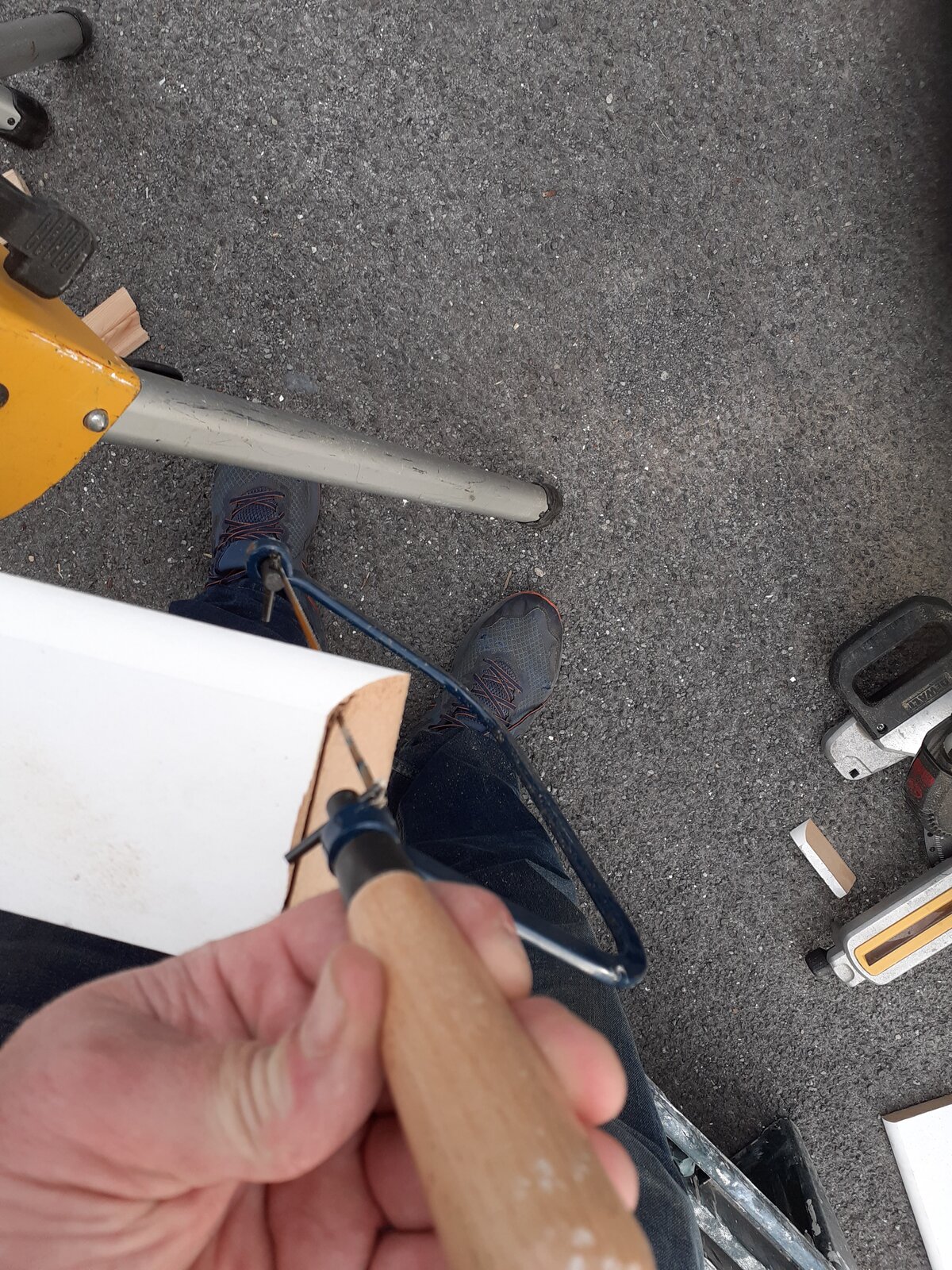

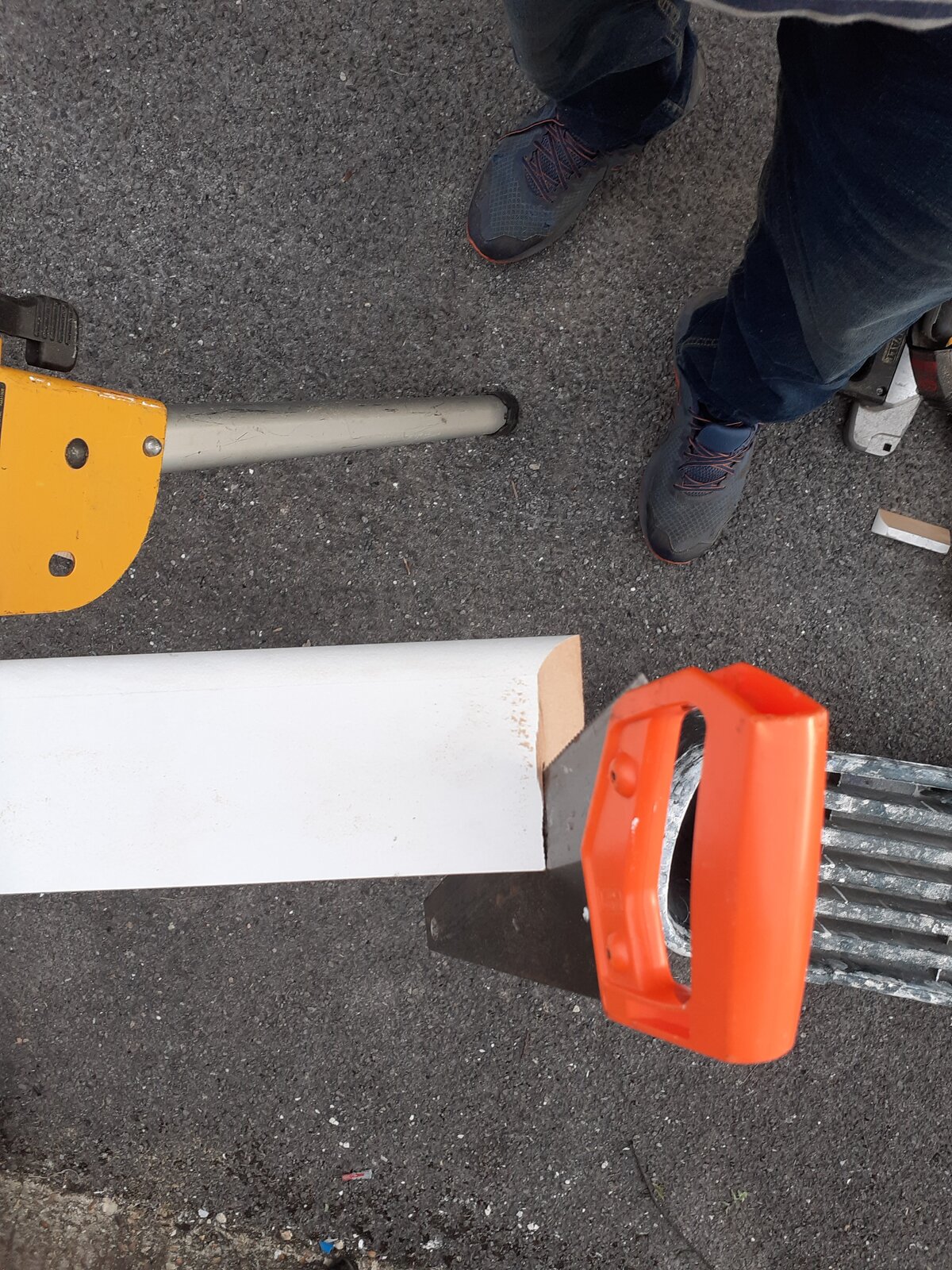

It's easier to do than describe - perhaps watch some youtube. Basically fit a square ended piece to the wall into the corner. Cut the next piece at 45 degrees as if you were mitreing in to the corner, and then with the coping saw cut away the material along the sharp edge where the cut and the face meet back to 90 degrees (or slightly more to ensure a tight looking fit)
It's easier to do than describe - perhaps watch some youtube. Basically fit a square ended piece to the wall into the corner. Cut the next piece at 45 degrees as if you were mitring in to the corner, and then with the coping saw cut away the material along the sharp edge where the cut and the face meet back to 90 degrees (or slightly more to ensure a tight looking fit)
Practised on a bit of bull nose. Cut the 45 degrees with chop saw then used coping saw . Is this how you do it? Is it usually longer piece of skirting which scribes over shorter bit or it doesn't matter. I guess gotta make sure I measure the length perfectly before cutting 45 to ensure I dont waste a length

Yes, that's basically how you do it. It doesn't matter if you do it to the long bit or the short bit.
Cut the scribed end first and get it to fit, then cut the other end off to the correct length but a straight cut.
In that way you only scribe one length of each piece and it is easy to measure and cut the other end square.
Of course, the real fun comes when you need to do a piece with scribes at both ends... :mad:

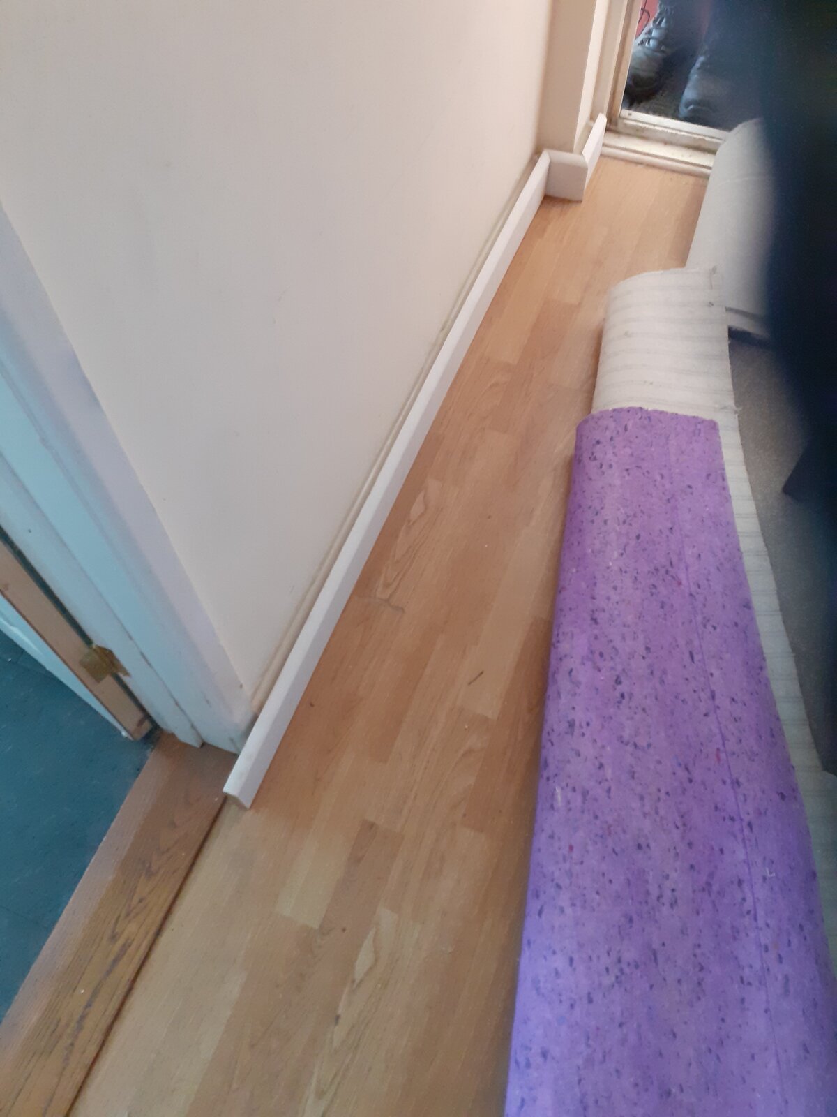

I guess I could practice on my hall.

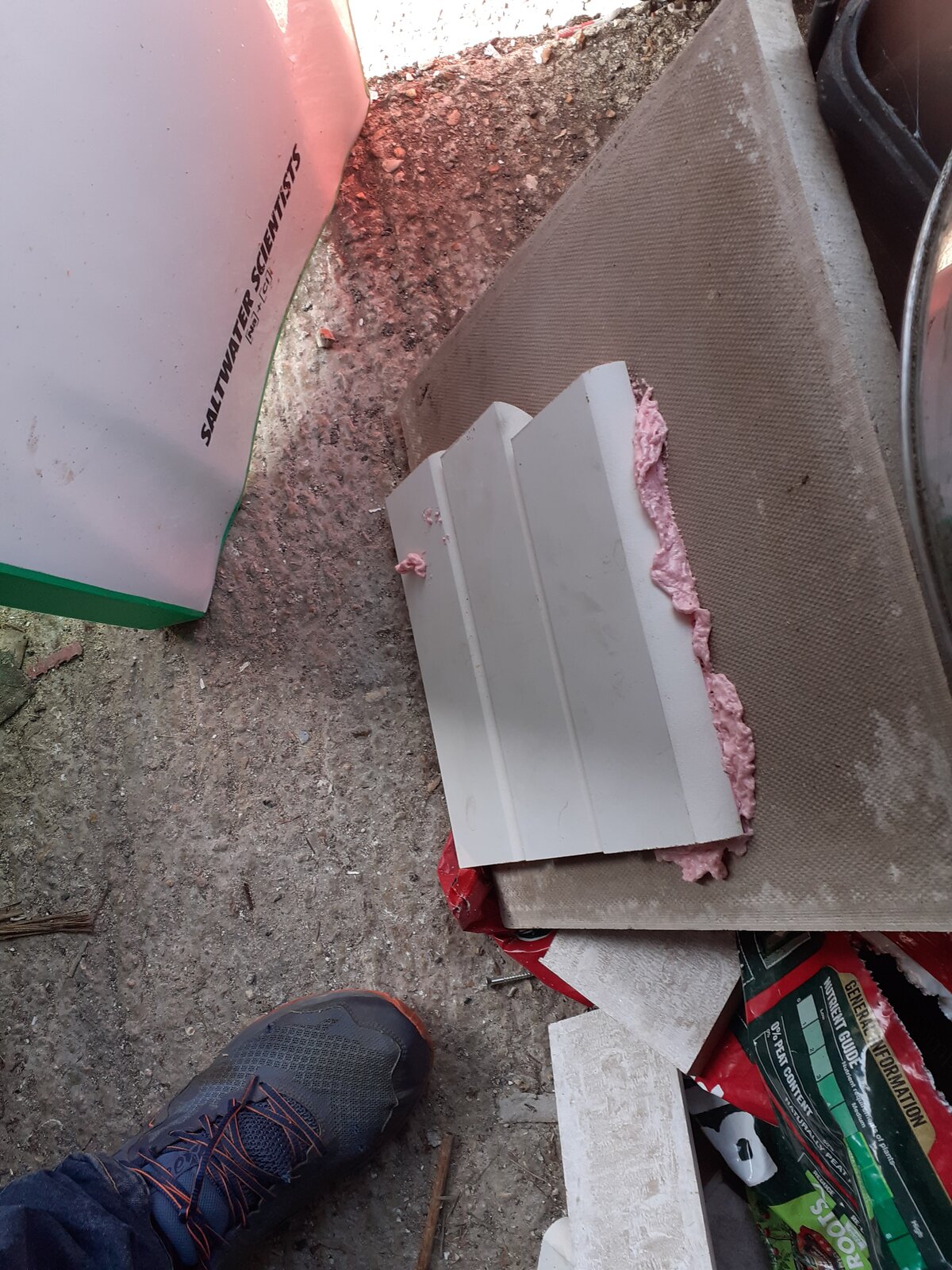

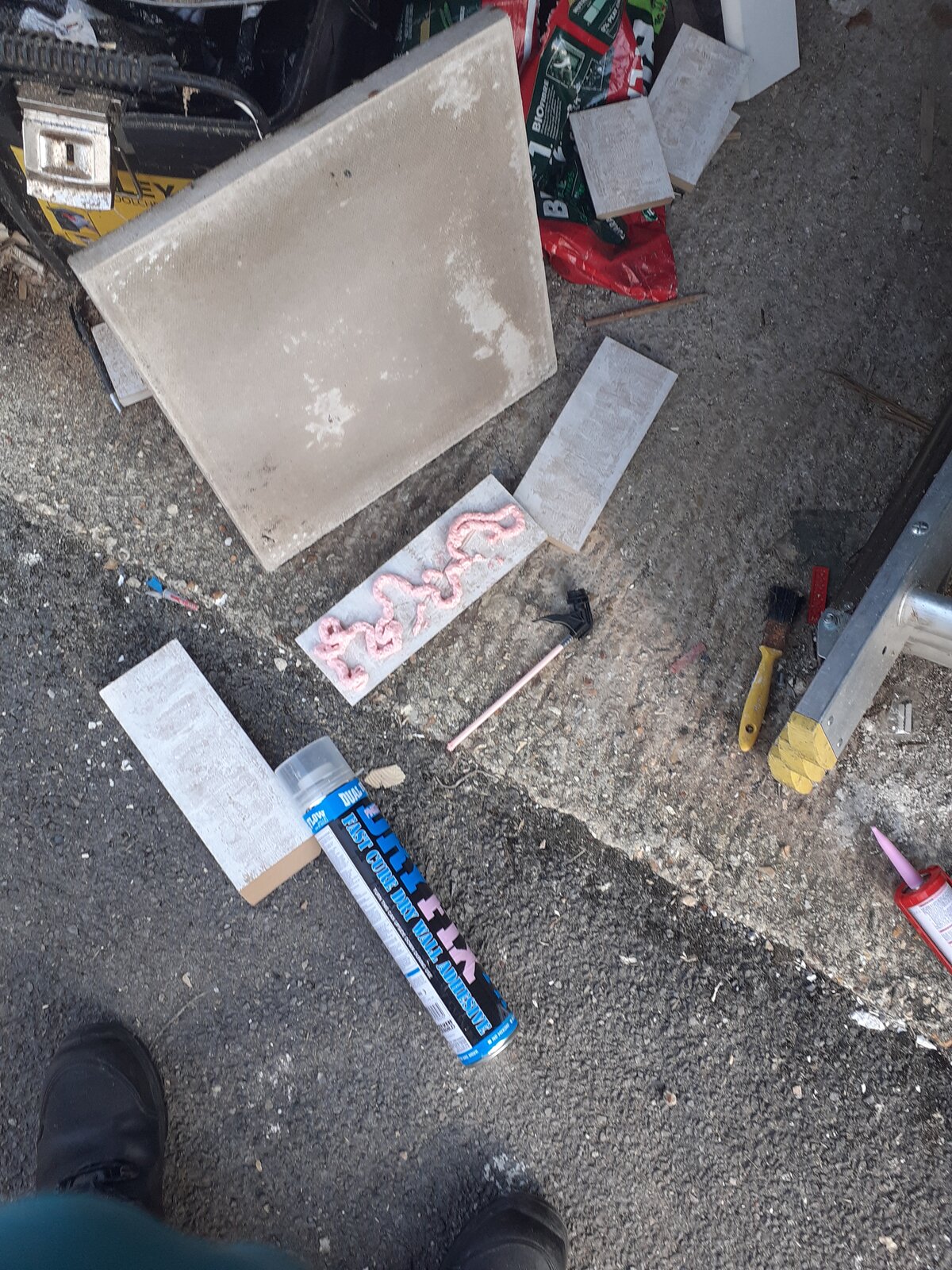

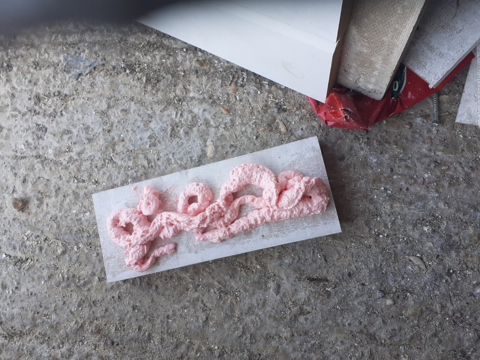

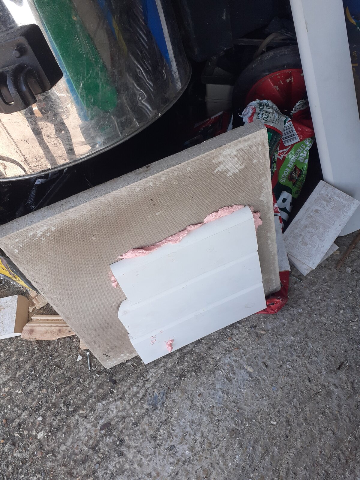

Tried out the two adhesives in my garage. The pink grip and foam one. The foam pushed out the top and made a mess. Couldn't wipe it off with wet cloth either-
Far too much foam - that's why the gun grade is better. A foam gun has an adjuster on the discharge and you can shut it down to a minimum. Foam is best when fixing to non-flat surfaces where there are craters and gaps, like you often find behind skirtings. If you have a smooth surface to fix to, the grab adhesives are better.

The problem with skirting scribes is that skirting is almost never installed plumb (or for that matter corners built square). So whilst you can get the top bit (the moulding) more or less right for one end, and accommodate any tilt in the main body of the skirting, how do you do that at the other end? Another issue is that you will naturally find it easier to cut the scribe on end of the skirting or the other (being right handed I find it easier to cut right end scribes). Bear in mind that you need to incorporate a few degrees of back cut in most of your scribe cut to get a tight fit

You say gun grade is better, do you mean gun grade foam or the pink stuff (which i used )?
I'll put less foam on next time, and put it in the middle. It caused an 8mm gap behind skirting with my attempt.

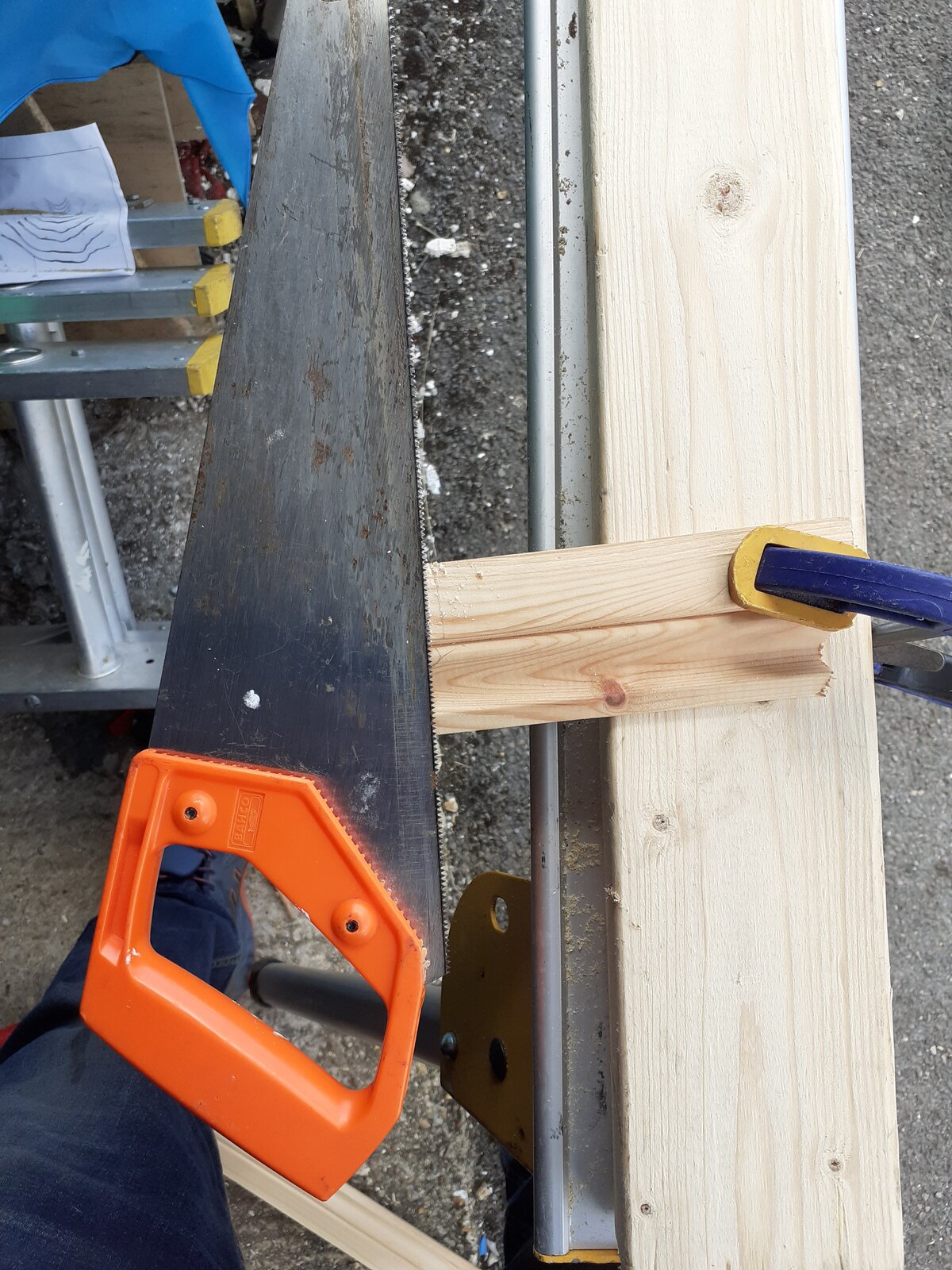

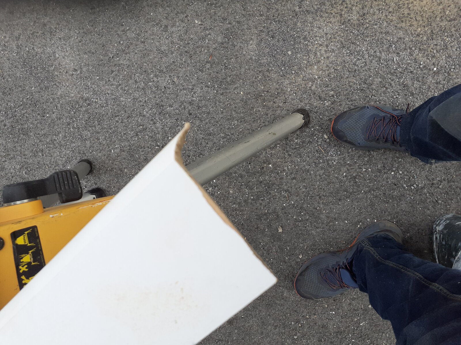

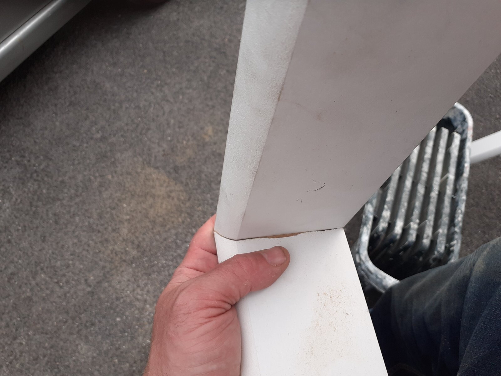

Had a play in my hall and found it's better to cut the decking much longer on straight cut incase I mess up the scribe cut and can redo it. The angle on external cut was definitely not 90 degrees. I guess first now just fill any gaps in the joins and worry about cutting perfect angle in future
