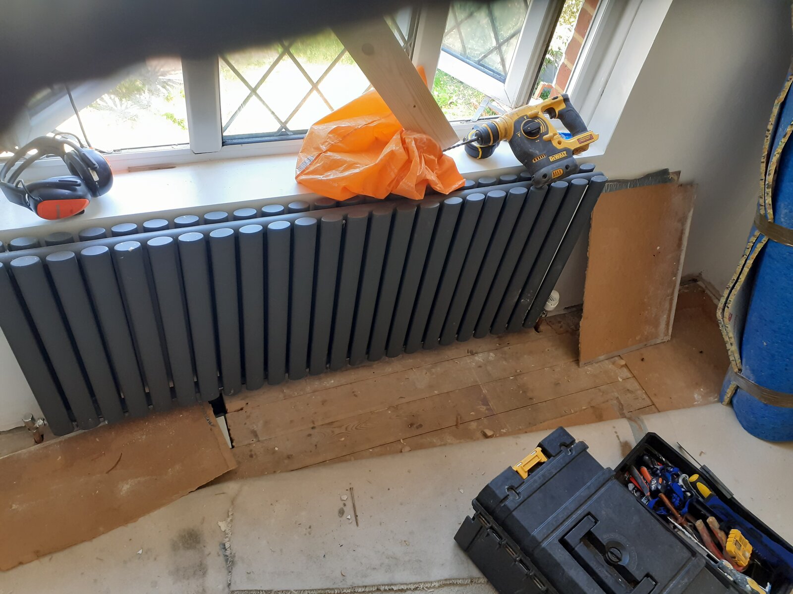

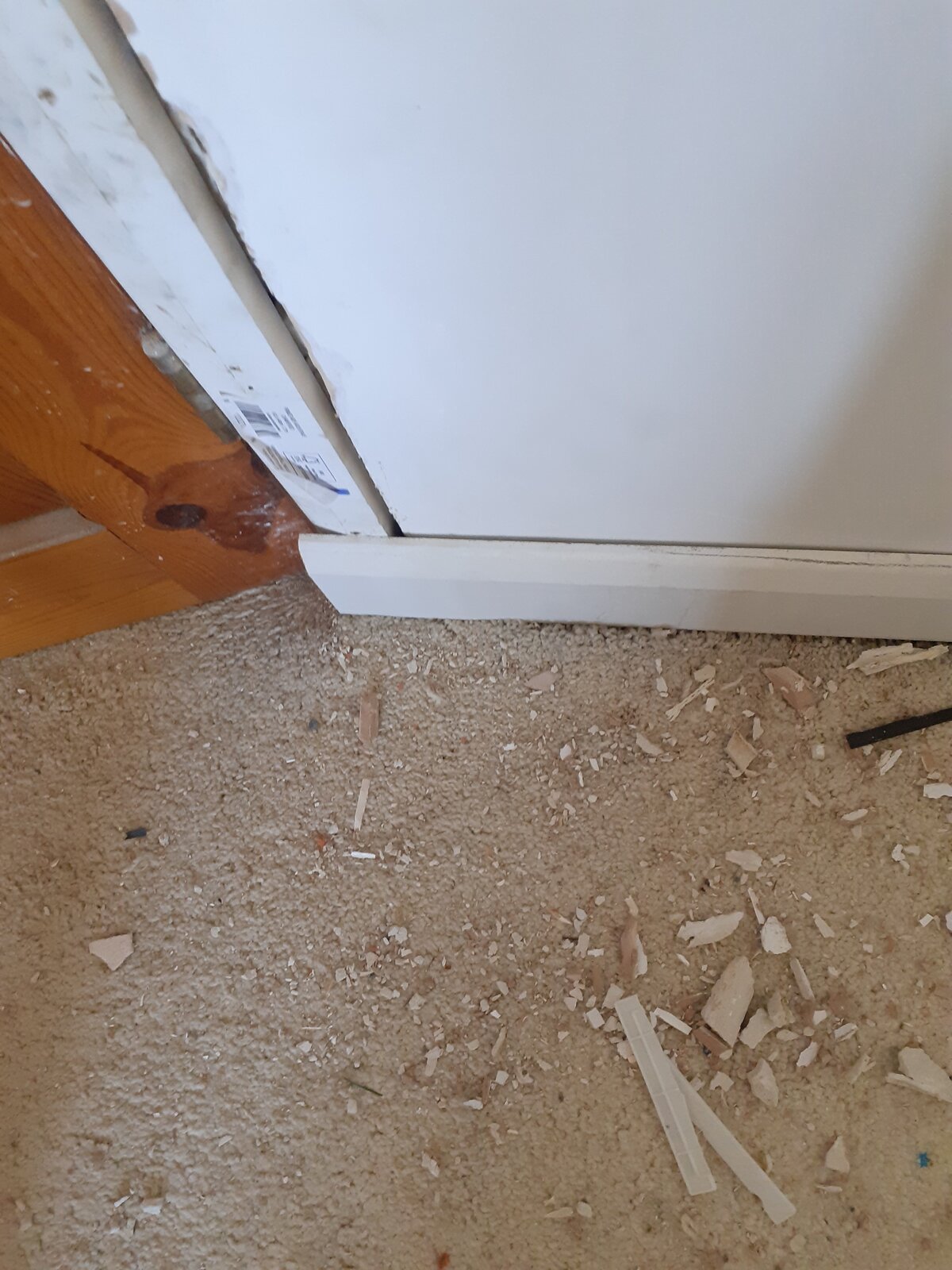

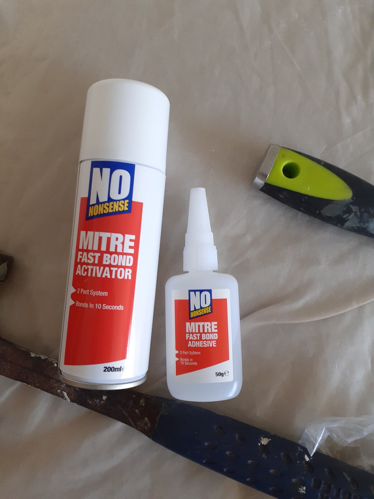

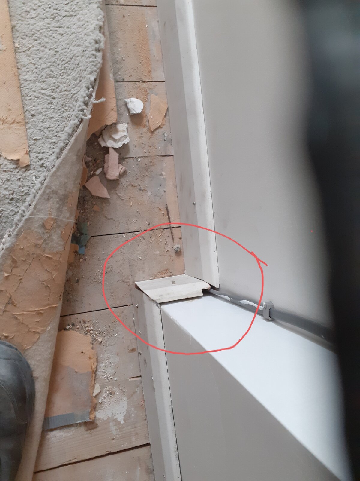

Did one leg of architrave and top and used the mitre glue stuff . The left side of door is too narrow for arc so will try some beading tomorrow. Got a problem that the architrave goes into wall at bottom and skirting is thicker. Only solution I think is to plane the end of skirting so they meet. Under radiator is too low to put skirting and it wont fit behind so thought I'd cut the top off a piece so it's not as high. Cut with circular saw
Did one leg of architrave and top and used the mitre glue stuff . The left side of door is too narrow for arc so will try some beading tomorrow. Got a problem that the architrave goes into wall at bottom and skirting is thicker. Only solution I think is to plane the end of skirting so they meet. Under radiator is too low to put skirting and it wont fit behind so thought I'd cut the top off a piece so it's not as high. Cut with circular sawView attachment 239786 View attachment 239787 View attachment 239789 View attachment 239790
The other way is to rip some strips of thinnish (say 6mm or 8mm) MDF and fix them to the door casing at, say a 5mm set back, then apply the archis at a 10mm set back from the edge of the casing. Looks a lot more professional when well done
Your scribes look to be getting better (y)

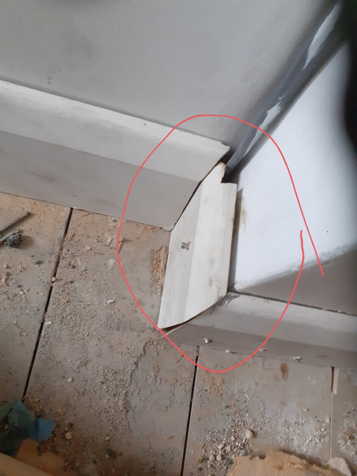

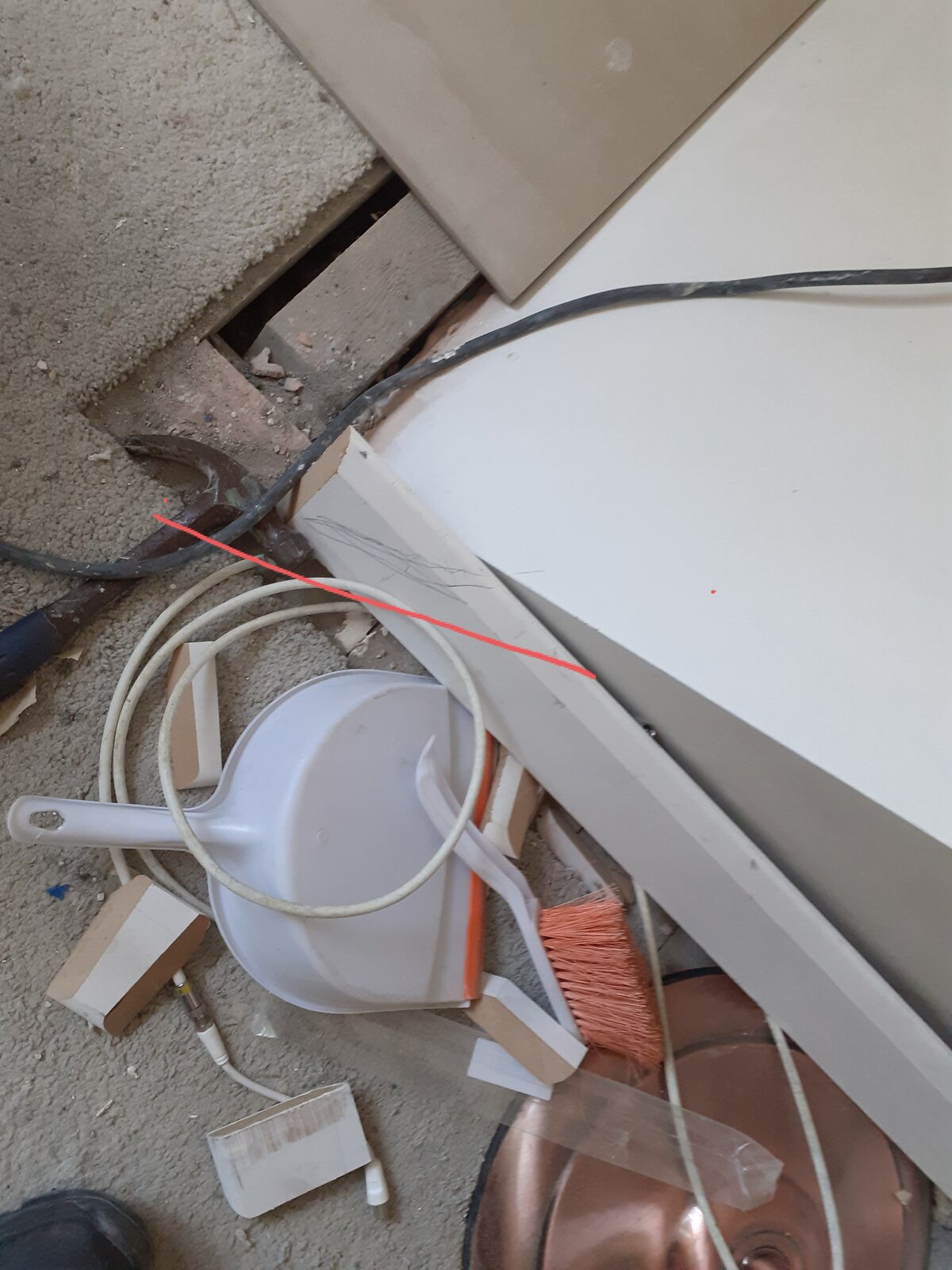

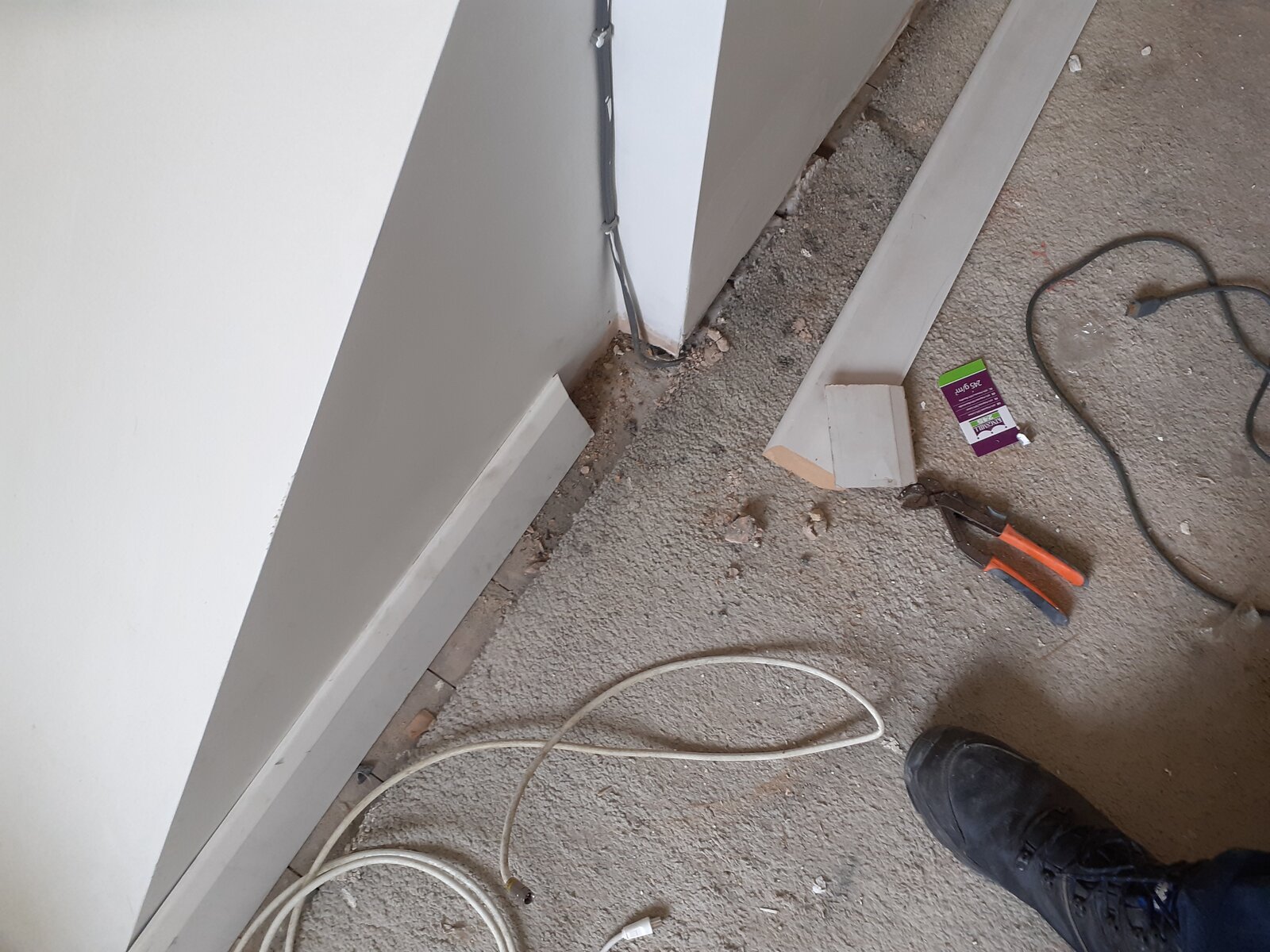

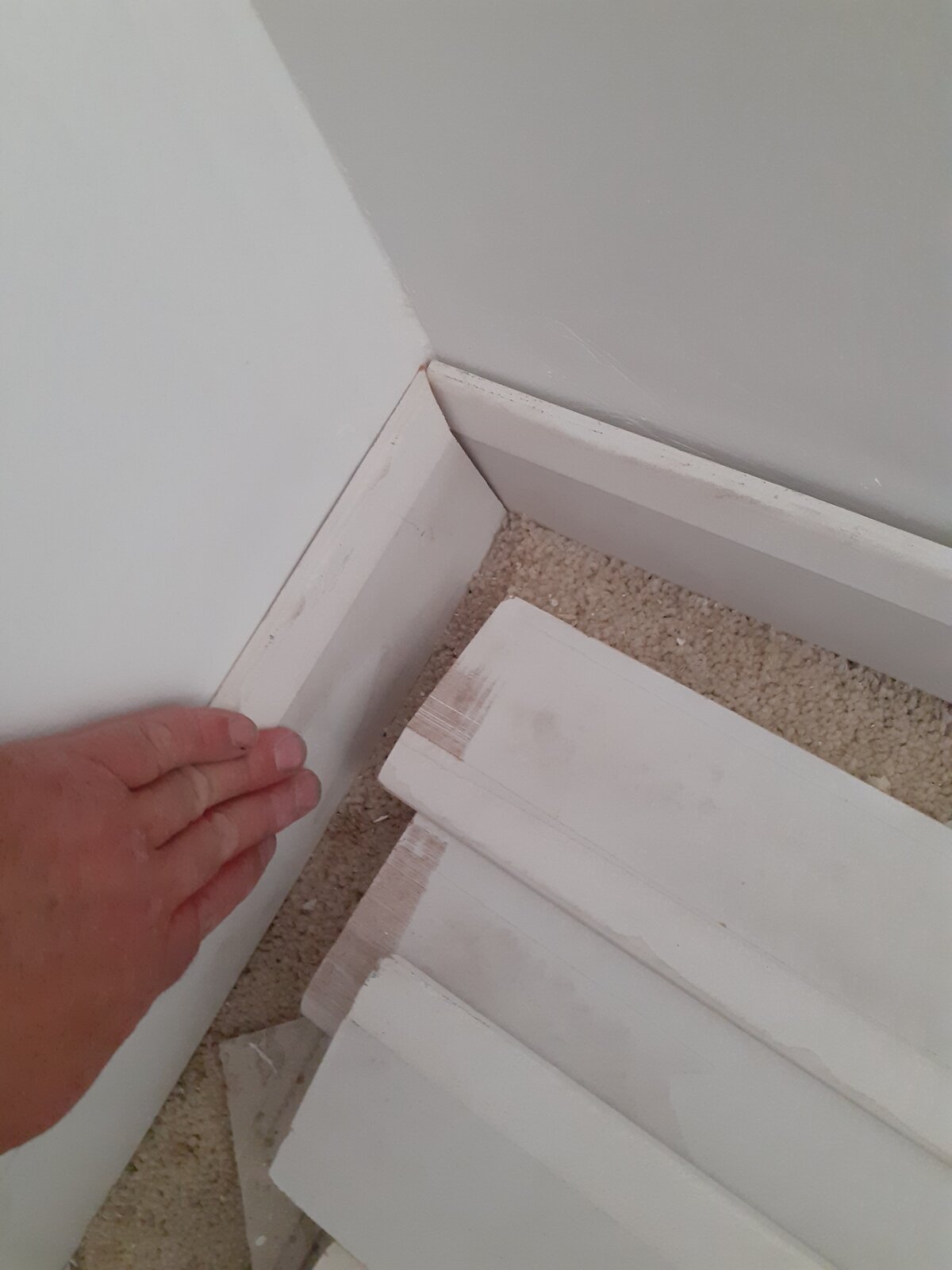

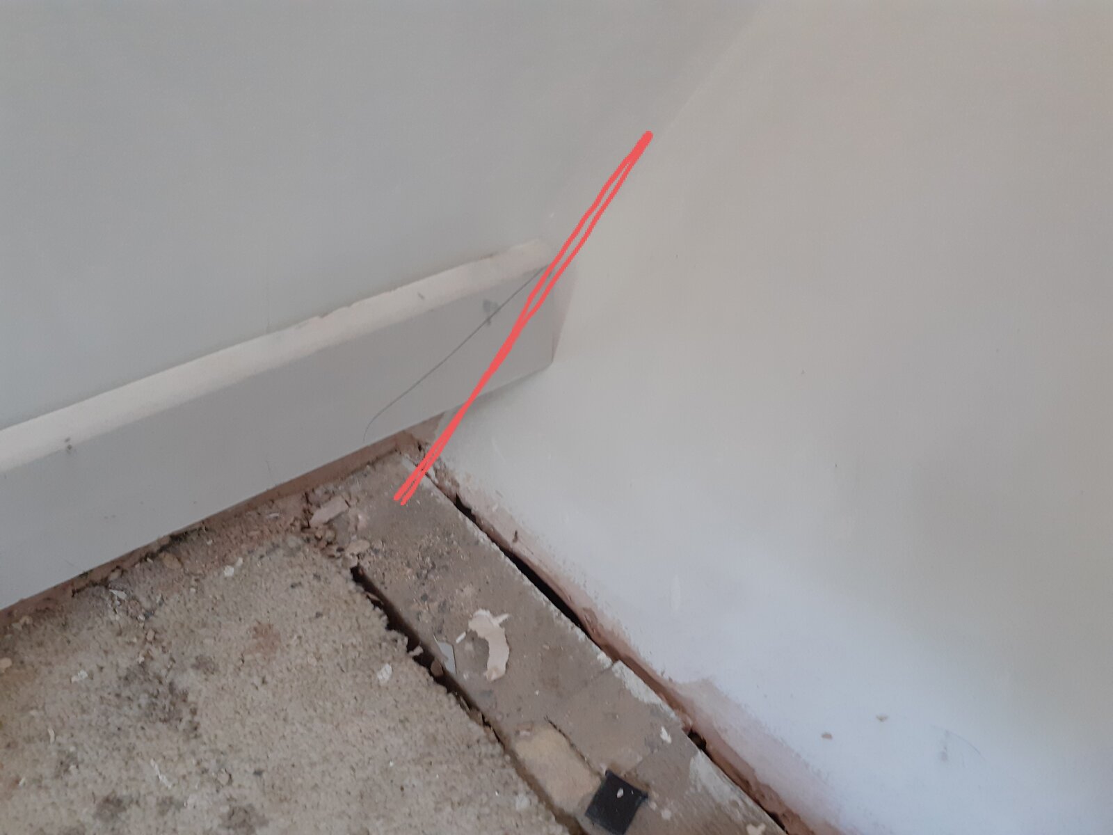

Gonna fit skirting into these two angles. I will use a bevel for angle then cut on chop saw to that angle. Is cutting skirting like this acceptable?
Basically pretty good. Internal mitres are good enough especially when I caulk them but where skirting meets architrave or near door I've tried to sand it to feather it in because I couldn't think what else to do and I've got an external mitre on a small bit with a cable getting in the way. The skirting it mitres too isn't vertical and theres nothing in the wall at the bottom of skirting to bang a pin into so the join is a mess

Jesus wept!...........................Again!!
For the sake of pretending you are a tradesman, just give it up! You are just conning people out of their hard earned money.

I'm thinking of taking a couple of the skirting off which which jut out at bottom to see if there's any broken plaster jamming it and scraping off old gripfill putting on new stuff
You know that I am right though JK.
As I have said before, I feel sorry for the customer. If he was doing this to his own property, then fare enough but this bloke is charging for 'your' knowledge.
