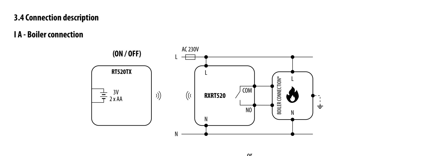

I've had a look at the wiring for the new thermostat.
Currently my wiring is:
Red - live
Blue - neutral
Yellow - switched
On the attached wiring diagram, does this translate to
L - red
N - blue
COM - yellow
Is that right?
Red and blue are right but yellow goes to NO and you need to put a link between L and C.
