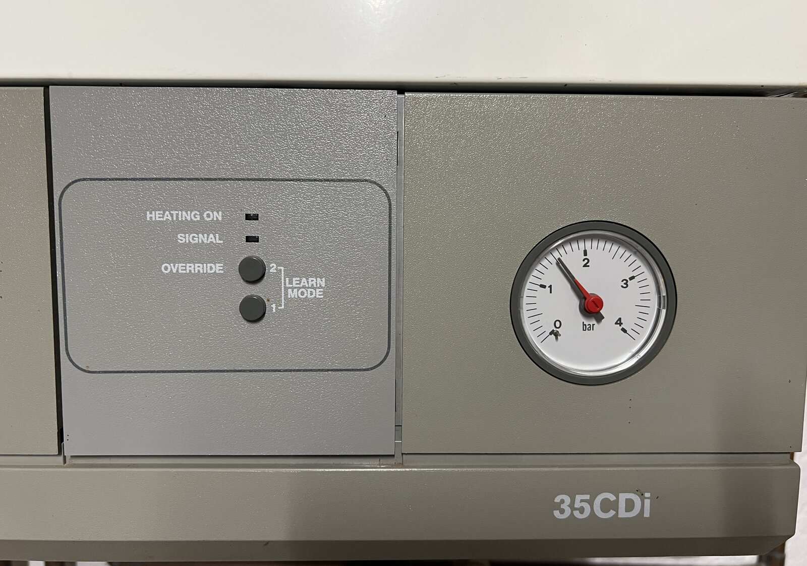

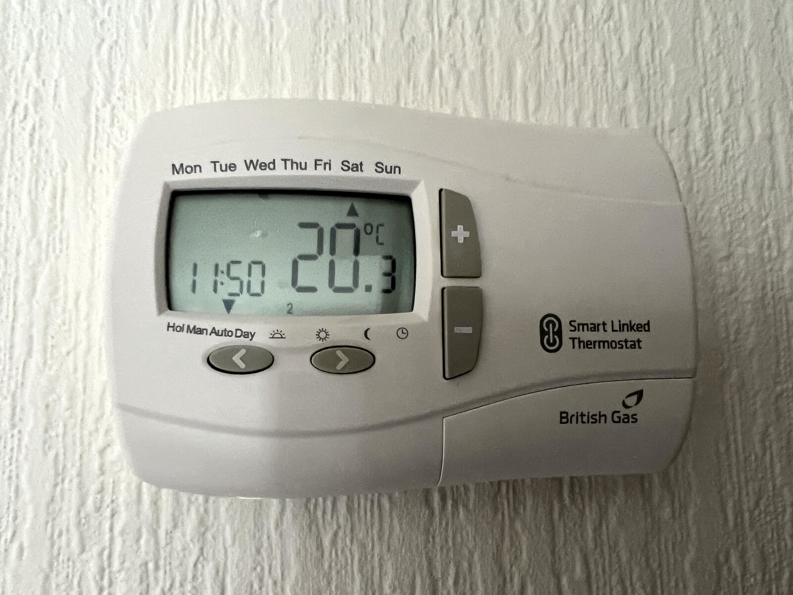

I would like to upgrade our boiler thermostat to a Hive, if possible, but l need some advice please.

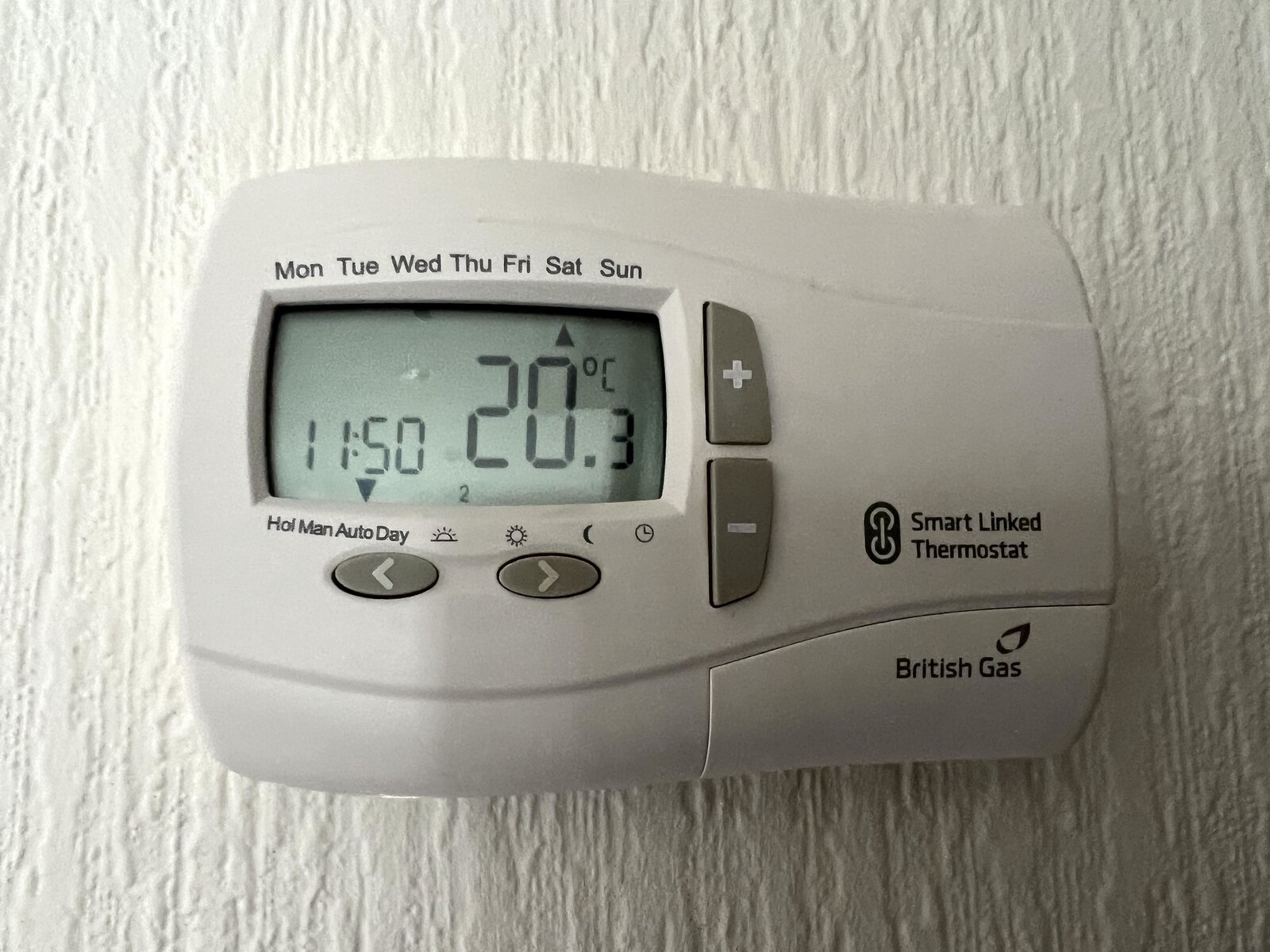

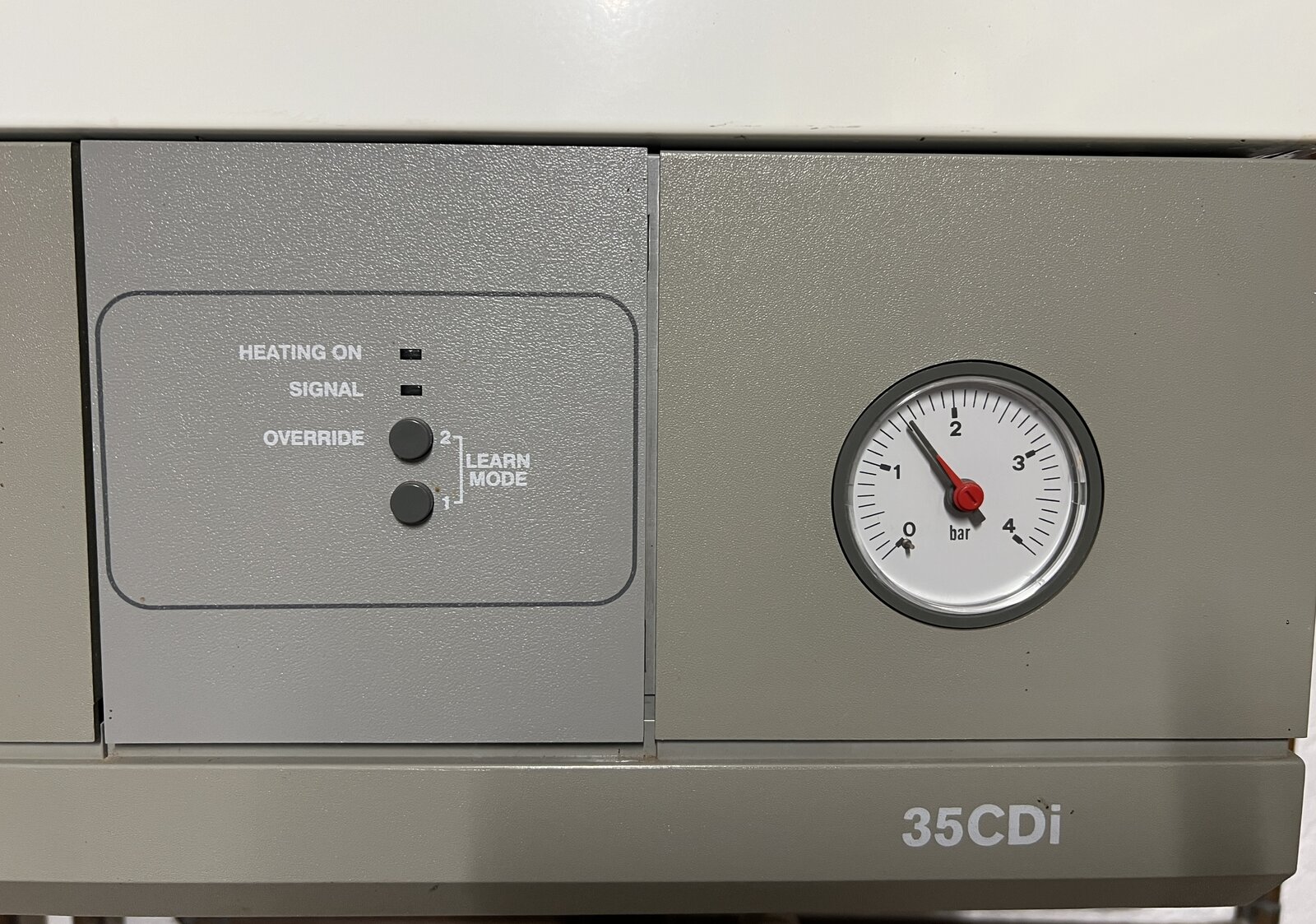

My current gas Combi boiler is a Worcester 35CDi already fitted with a Worcester wireless thermostat receiver. The current wireless thermostat is a British Gas PT plus programmable type (i.e. rebadged Drayton) and relatively new. Photos attached.
Would the boiler’s current Worcester wireless thermostat receiver work with a Hive, or would l need to wire in a new Hive receiver? Thanks. Mark

As above, and existing may need to be disconnected or set to override if it’ll stay on permanently.

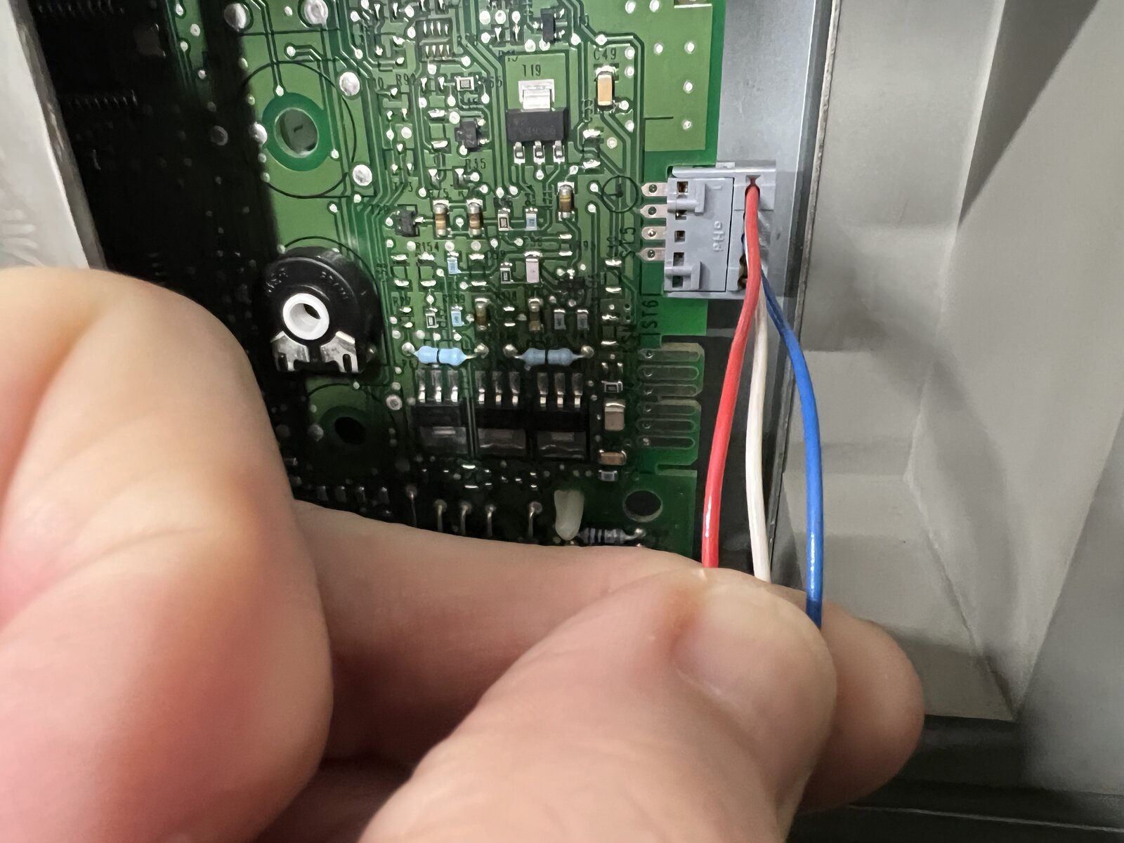

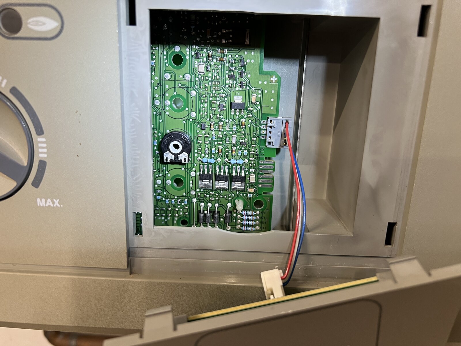

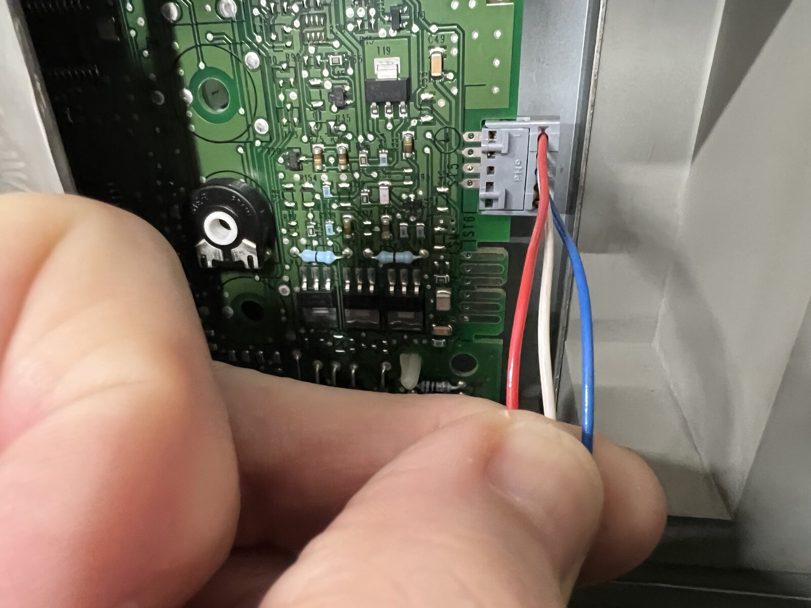

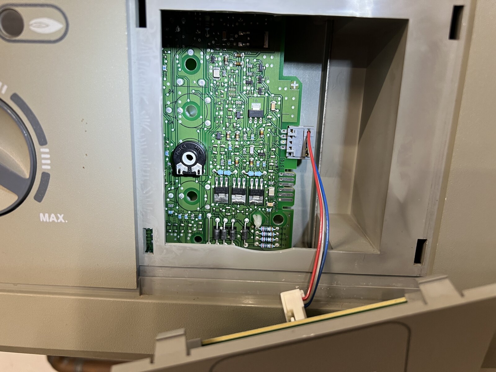

Just had a look behind the Worcester wireless receiver on my 35CDi. The boiler was originally specified with a wireless receiver, and ‘stat. Looking closely l can’t see any connections where a new receiver could be connected to . The wireless receiver front panel is connected via 3 wires to another PCB. Is it possible to connect a Hive receiver to this somehow? Thanks in anticipation

Im not sure off hand, but might just be able to remove both ribbon connections and put the plastic housing back in and then wire the hive into the relevant terminals on the pcb. Will need the manual to confirm, something I can’t do just yet as I’m busy.
I'm about to do the same - Did imiller9 have it correct? Assuming you disconnect ribbon and ignore, then take out the Ls & Lr into Hive? Please let me know, as Worcester won't do it.
Also, does yours already have a connection to the Ls & Lr? I think it is for the old thermostat which would mean no connectors on yours.
If you have the same setup then you shouldnt have any wires in LS&LR but there will be a link that has to be roved and LS&LR wired to 1&3 on the hive receiver, you will need to take L&N from the boiler wiring to L&N on the Hive
