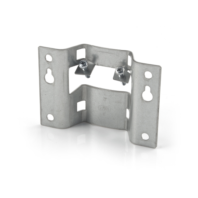

I thought maybe it might need to be mounted horizontally but the wall mount bracket that comes with it doesn't look like it would work in that orientation

Your purchased part is specific to the danesmoore range of boilers and not supplied with a wall
mounting bracket/kit although this should should work https://www.bes.co.uk/expansion-vessel-mounting-bracket
Still consider having the correct vessel fitted.
