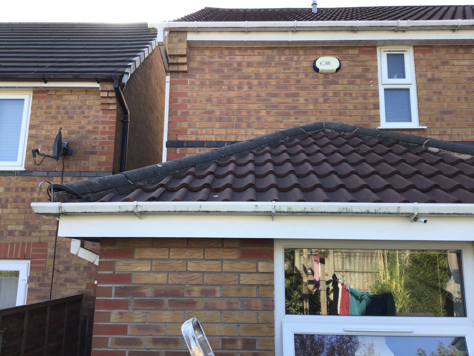

Hi, see pic, the end ridge tile has come loose. How do I fix this please? Is it cement I need?

con1_uk, good evening.
Short answer is yes, if we are talking about the left hand lowest hip tile on the extension roof?
Carefully remove the old cement and replace the tile using what you see in place now as a guide as to how much cement to use to re-bed the tile.
If you enlarge the image you posted, you will see that there are numerous areas on the hip tile that have missing mortar and especially at the joints of individual tiles.
Difficult to tell but the original bedding mortar may have been coloured?? if you use a sand cement un-coloured mortar, the new mortar will show up for a long time as a very different colour?? just a consideration??
As an aside?? your neighbour is about to loose his / her dry verge at the bottom right of his/her roof slope nearest yo your property?
Ken.
Cheers Ken, not too worried about the colour difference so will crack on with your advice thanks. Regarding the other hip tiles with the missing mortar do I keep them in place and fill in the missing please?
ta
Proper way is to lift and rebed the hip tiles, point up using the same mortar as the bed.
Thanks all, I have rebedded the tile, looks good.
