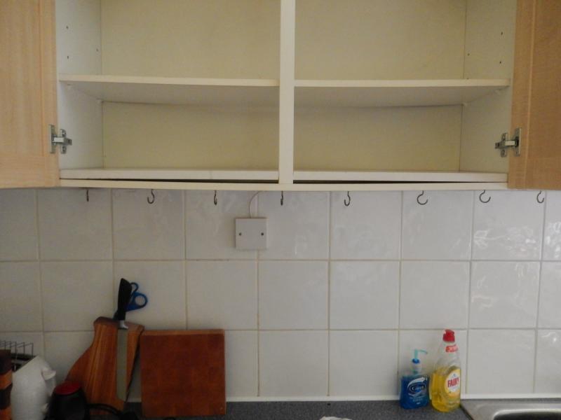

It all started with a wall unit in my kitchen, which is 1m - and, for a chipboard construction, that's asking too much! It was sagging in the centre by almost 12mm when I moved in a year ago.
My plan, based on the advice found here, was to reinforce the bottom shelf or base by doubling its thickness.

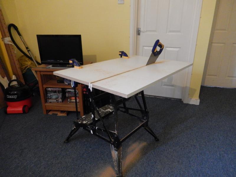

After a bit of a scrounge on Freecycle, I found a guy in Bristol who was replacing his kitchen and so I had a couple of oversized panels to play with - these were actually MDF but no easier to cut with a blunt handsaw!
I cut a notch in the centre so it would fit around the central upright.

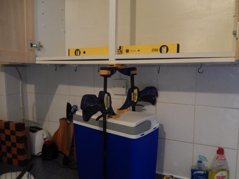

I drilled and countersunk a series of pilot holes from underneath but before screwing the two boards together, I had to prop it back up in to shape and the use of a pair of spreader clamps worked even better than I'd hoped - you may wish to use something more rigid than a cooler box though!

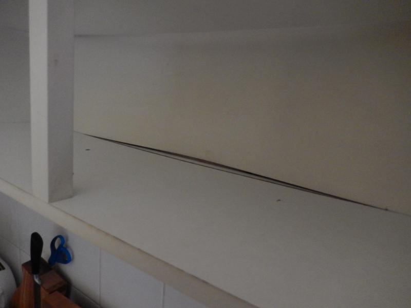

Not only had the bottom shelf dropped by the back panel (4mm hardboard) had popped out of its groove and was pointing towards the wall behind.

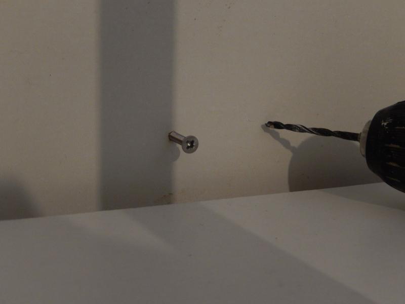

I actually forgot about this until after I'd put the last screw up through the bottom but it should've been pulled back in to its groove before fixing - to do this, I put a couple of small pilot holes in, partially inserted a self-tapping screw (for its finer thread) and pulled it back in to position by hand.
Had I remembered the back panel sooner, this repair may've been perfect but I'm pleased to say that the sag has been reduced to only 3mm! :-) I've also flipped the middle shelf over so it's now convex and not concave.

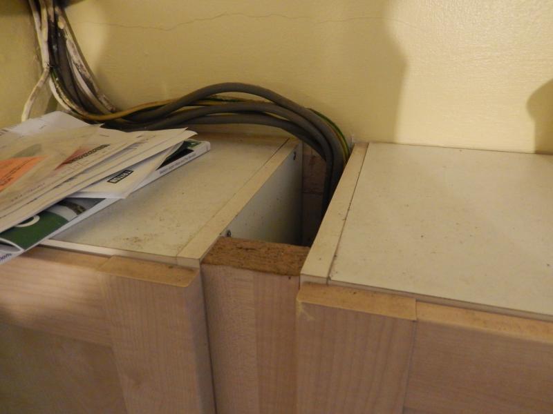

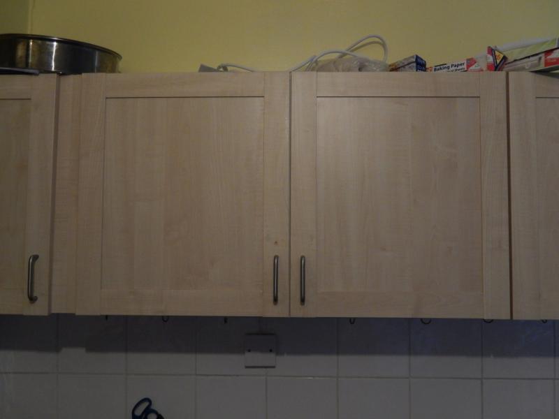

While I was there, I also went about plugging a couple of large holes between this wall unit and the small cabinet to the left:
I cut some more of the MDF:

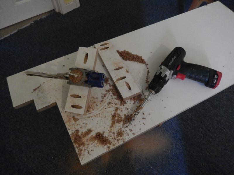

And peppered each piece with pocket holes - I love this jig!

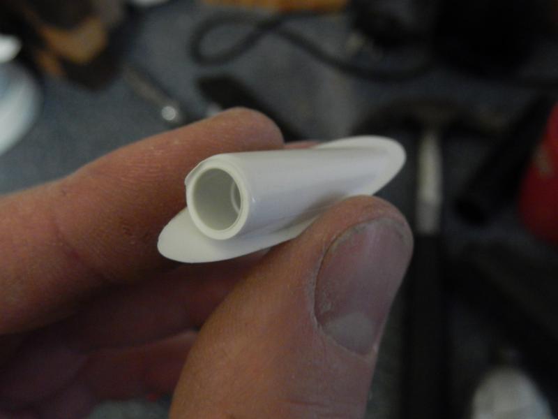

I wasn't concerned about the appearance of the filler piece on top as it would never be seen but I wanted to hide the (excessive number of) screws underneath and I just so happened to have enough of these white pocket hole plugs:
They push in, hold firmly and require no glue.
