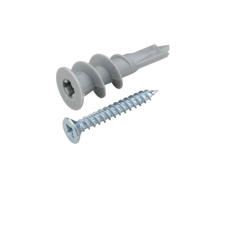

It looks like there are plastic rawlplugs in the holes, pull them out (I use a screw with a couple of turns into the plug and pull the plug out) fill with filler, rub down and paint,
If that aint good enough, hang a picture over them or hide with furniture.

Nope, but if you look at the holes they have a lip around them, which suggests some kind of plug.
5010445070167_001c_v001_ap
Hiding with a picture, or furniture could be he best idea, although the most expensive... if not i would advise using wall plugs
