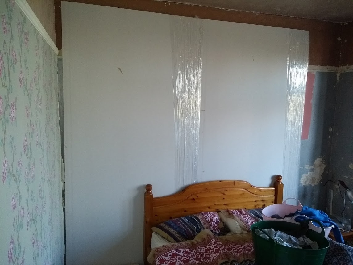

This makes me feel a bit better about being tight with the budget:
"There are some in the industry who say that we should therefore set our target U value considerably less than current building regulations and go for something like 0.6 U value, when retrofitting IWI. Ideally, each property should be assessed according to its own situation. For example, where you have a brick façade which has a northerly orientation, you would be more concerned to keep some heat going into the wall from inside."
https://www.greenregister.org.uk/blog/pitfalls-and-solutions-for-internal-wall-insulation
No idea what my U value will be, but certainly nowhere near the latest recommendations!
