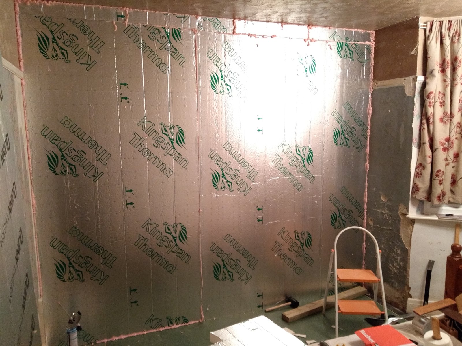

Fixing insulated plasterboard - general advice
None. At least, none I noticed! 2 still up!
this isn't DIY, its fine art!
Da dah!
Just need to trim the foam, tape the joints, stick plasterboard and decorate!
I'd put a little bit thicker lines of adhesive foam next time, but that's a well deserved Da Dah.

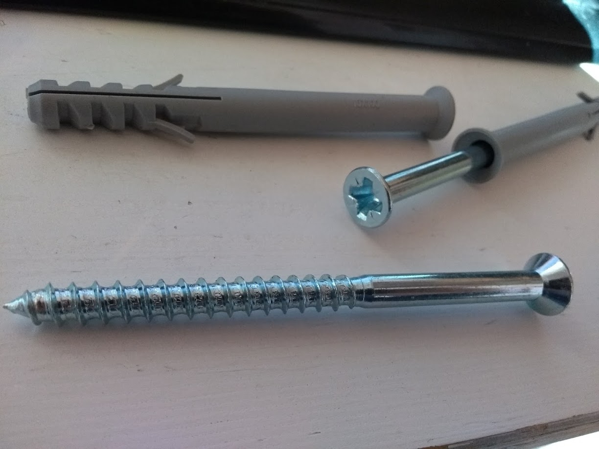

I wouldn't use those Jonbey; if you look at the head, they do not have a slope that will hold the plasterboard against the wall.
I'll change then then. How to stick the plasterboard today, week use more adhesive. Hopefully it will stay up until I get the hammer bolts.

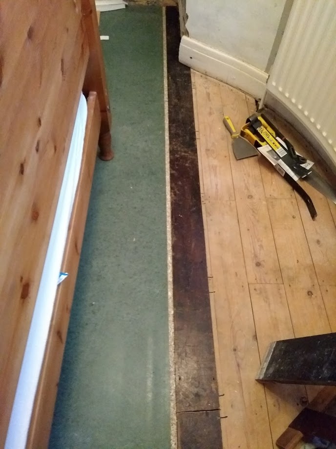

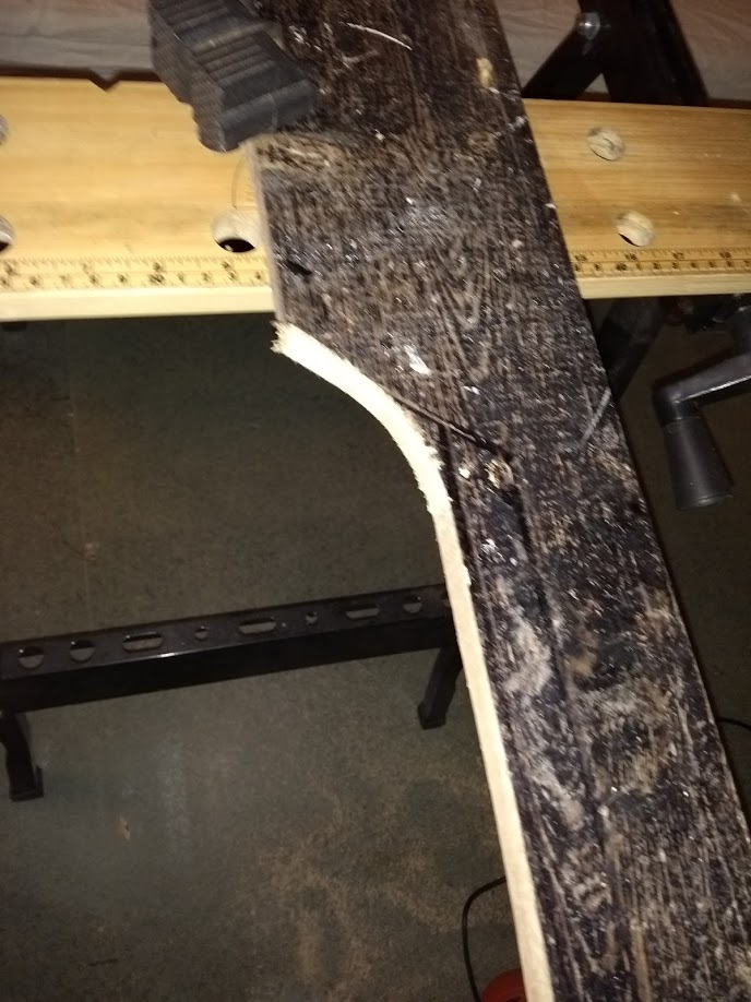

Just found the the skirting under the bay window is rotten too. So taking that out now. It there such a thing as insulated skirting board?

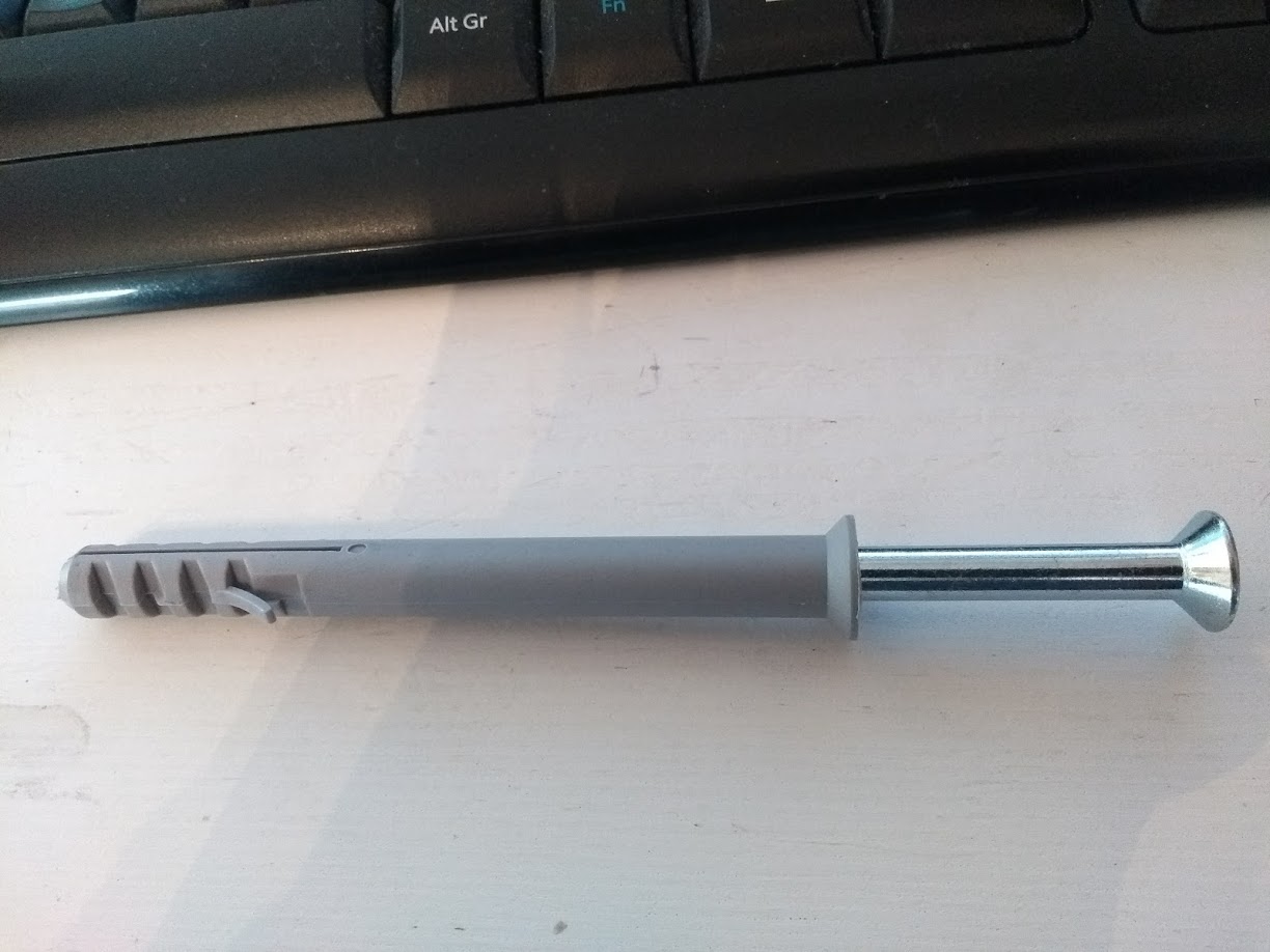

hang on, these are call frame fixing on Toolstation ~(I couldn't find them on their website at first), and have a slope - or does the slope have to be the other way?!?. A photo:
they are 10cm long. Insulation + plasterboard is 6cm, so 4cm in the wall. Is that enough?
https://www.toolstation.com/shop/p33411?table=no (can't find the 10cm ones on the site)
Not really; you want at least a couple of inches in the wall, so aim for 120cm as a minimum. Having said that, you might get away with 10cm on these
actually, these are hammer fixings arent they?
Could well be, but how long is the slit; that to me is the defining depth. Put one in 40mm, and see how difficult to pull them out.
hmmm, I'll change em.
Daft question - but, do you literally just hammer these things in? Just watched a video, and the screw did not appear to turn .... unless it turned exactly one turn each time.
and, you can unscrew them normally if you need to, yeah?
